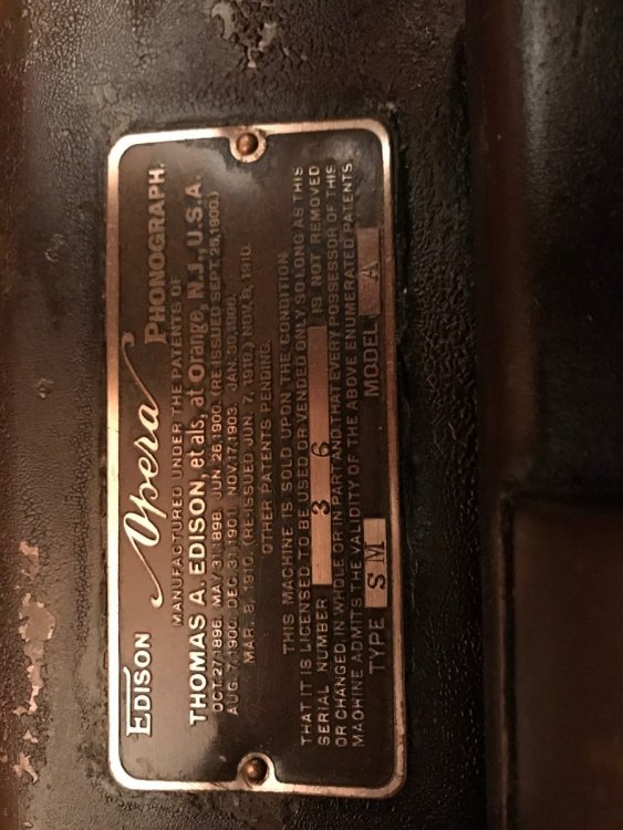

here is another low number (36) ?
mahogany
i am the owner
Thanks to you both! Nice low numbers. The tally is now at 136, and counting.

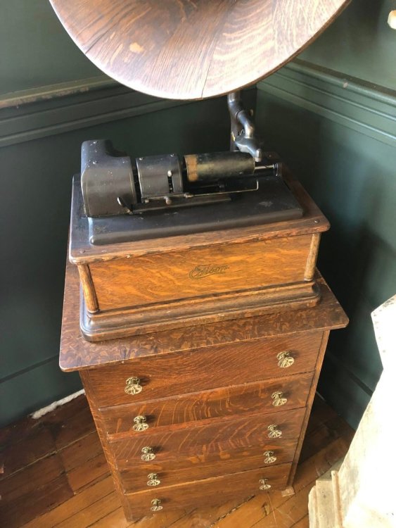

Sorry a little late to the game, but here are two more for your data base.
1.  Mahogany Opera, # 2639,  SM model A,  sold to a local collector who is not on the either forum.
2.  Mahogany Opera, # 3480,  SM Model A, kept in my collection

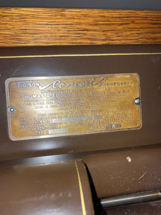

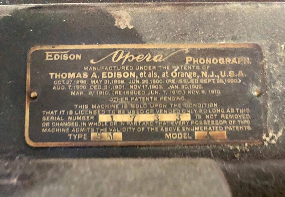

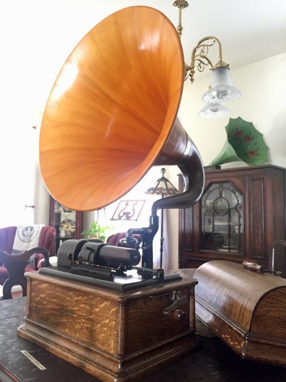

New to posting here! Apologies for getting this information in late, I hope it is helpful. Below is information on my Oak Opera/Concert:
SN: 4591
Type: SM
Model: A
Wood: Oak
Other: "Concert"
Owner: Andrew Skitko
IMG_8182.thumb.jpg.feca2f667bf8b53149107b10a200cc7c.jpgfullsizeoutput_b8e.thumb.jpeg.1c02c35fe98707d712a0830818fba7ed.jpegfullsizeoutput_b8f.thumb.jpeg.24c075b27d0b03939ab5abe2e27f6300.jpeg
Is that a spruce horn? Very striking!
