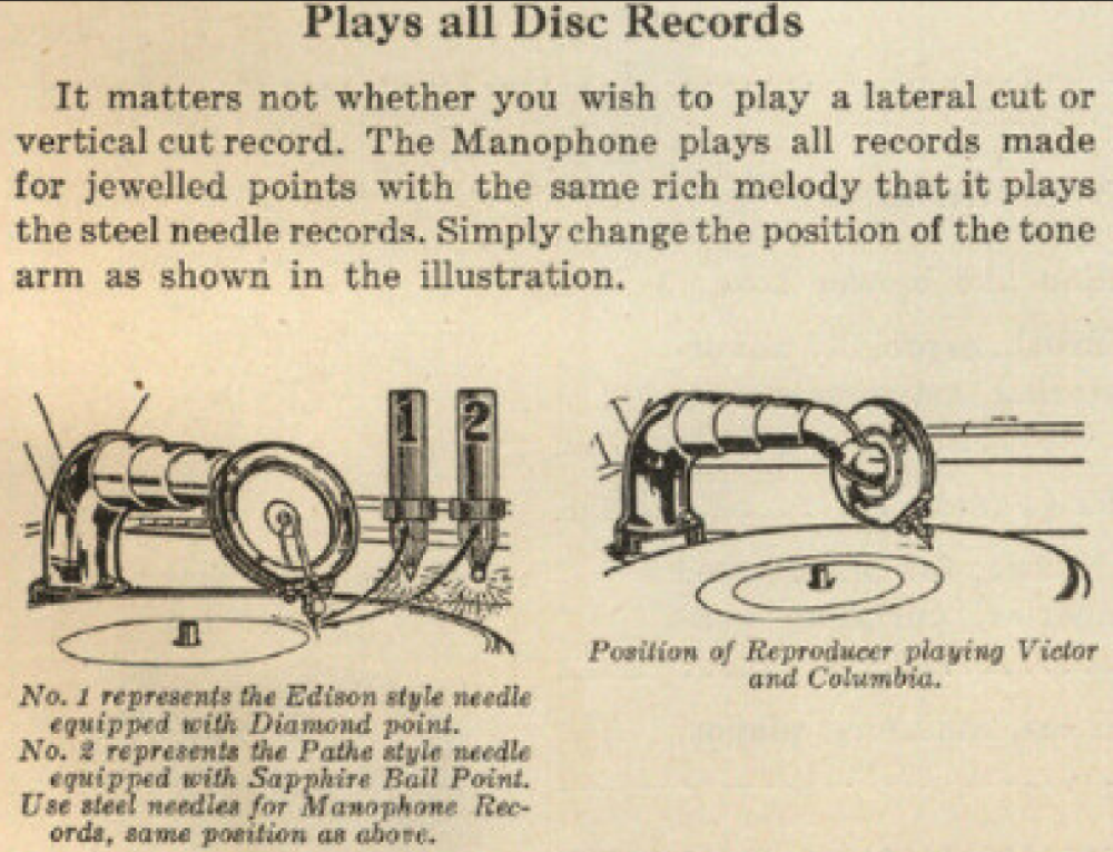

Here  is a diagram showing how to play lateral and vertical records.
