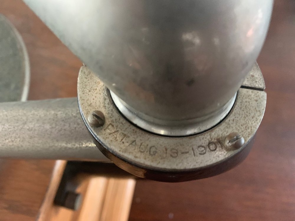

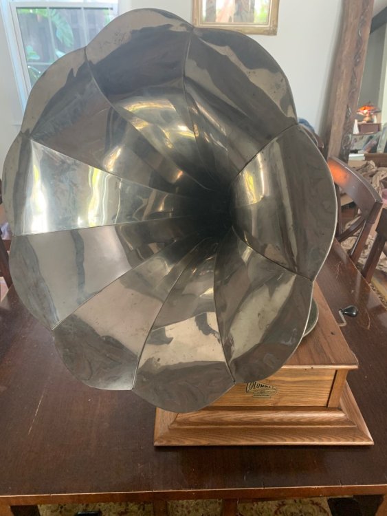

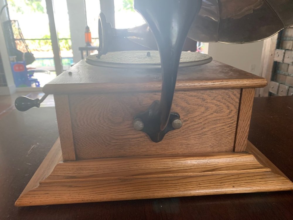

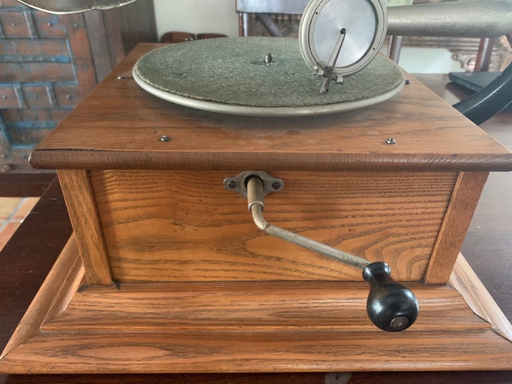

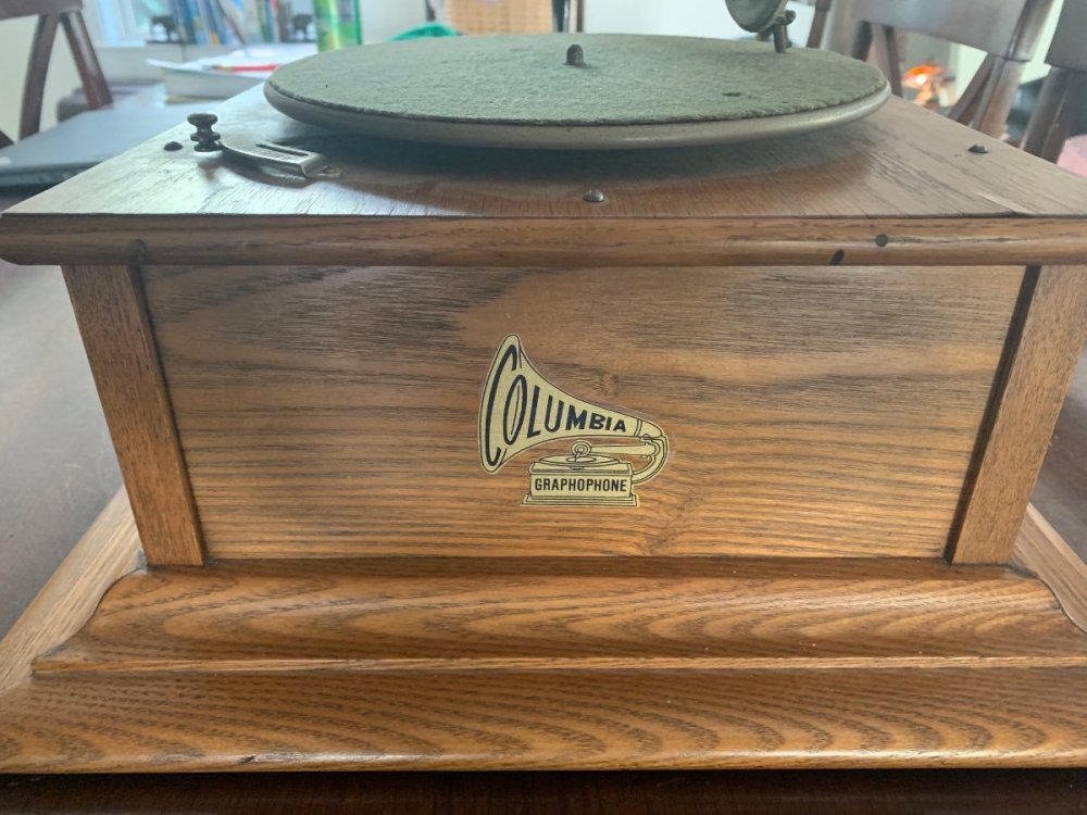

Please excuse my ignorance as this is my first post related to my first purchase. I recently purchased this Graphophone in an online auction ($450) and it just arrived today.

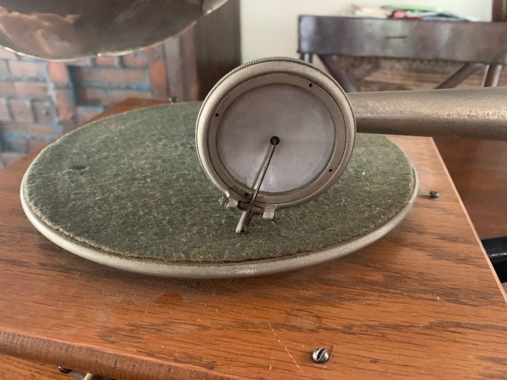

I am trying to understand the history of this item and what elements may be authentic or reproduction. I have purchased medium needles but they won’t arrive until next week. It looks like I may be missing a piece in the reproducer to hold the needle in place, but I’m uncertain. It’s clear that the screws on the top are odd as I don’t see that anywhere on Columbia models.
I’m prepared for feedback that it may not be worth my purchase price, but I purchased it to get into this space as a beginner and it looks lovely regardless. Thank you for your time. - Kevin
This looks like an Columbia Disc Graphophone BN Improved Champion to me; this is according to Robert W. Baumbach's book "Columbia Phonograph Companion Volume II". I'd say you did very well on what you paid. These are pretty uncommon machines to say the least - although I hesitate to say "rare" because I'm no expert. I'll defer to those experts here for more opinions.

This is great insight! Thanks so much for cross-referencing the Companion Volume to try and identify the model. I'm hopeful that it actually operates!
After additional research, I'm wondering if this is a modified "Royal Talking Company" Gramophone as they utilized Columbia parts and perhaps the horn has simply been swapped. Also, I'm now wondering if the Graphophone label is authentic and/or it replaced the Royal label (although that included holes that I don't see here). But the Royal has the screws on the top that I'm seeing on my machine. I'm perplexed. 🙂

No, the Royal cabinet is quite different dimensionally, with fluted columns and a narrower base molding.  As Fran reported, your machine is either a late BN or a 25H.  Your machine has the later sound box of the 25H, but with an earlier nickeled horn.  This is not at all uncommon with Columbia machines, and bear in mind that original purchasers often configured their machines to suit their taste.  Here are pages from Robert Baumbach's Columbia Phonograph Companion Vol. II, The Columbia Disc Graphophone and the Grafonola (note that the 25H was a later version of the BN):

Great question! The disc is a 78 RPM Shellac on Columbia listed number 36375 A11. It has "Monday Date" on one side and "Weatherbird" on the other. It was purchased on Ebay (below) as a first record to test on the machine. I am aware of the requirement for "one needle, on side." and needing to change the needle after every record side played. I don't yet know how to operate the machine, but assumed I can find a "how to" somewhere on Youtube. Additionally, I think that I may be missing a screw that holds the needle in place. If you look at the photo of the reproducer, it looks like there should be a screw in that whole that I believe helps hold the needle in. If so, I'll need to find that somewhere online for purchase.

Finally, if you need a needle screw for your BN's sound box, you can get one here:
