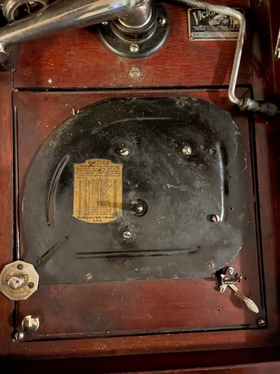

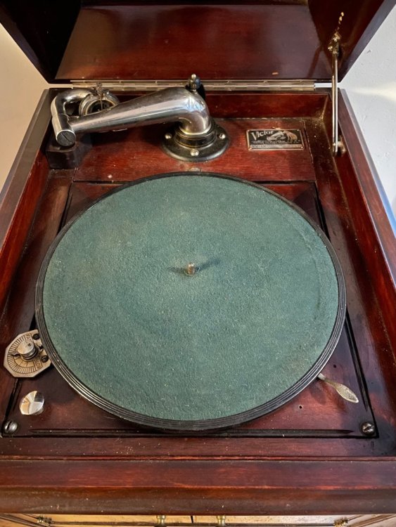

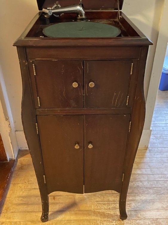

If you can post a picture of the playing compartment of your Victrola IX (there were several variations), someone may have the part you need.

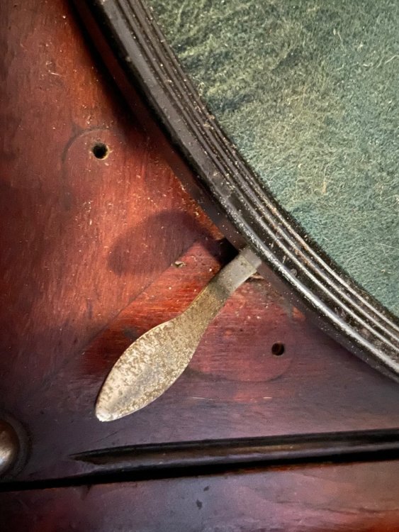

Images attached. I just got this so apologies in advance for being a newbie.
I assumed that some kind of trim plate was missing because I can see a couple of nail holes and an outline where it looks like there was something. But every video and picture I’ve seen shows nothing there.

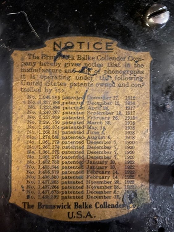

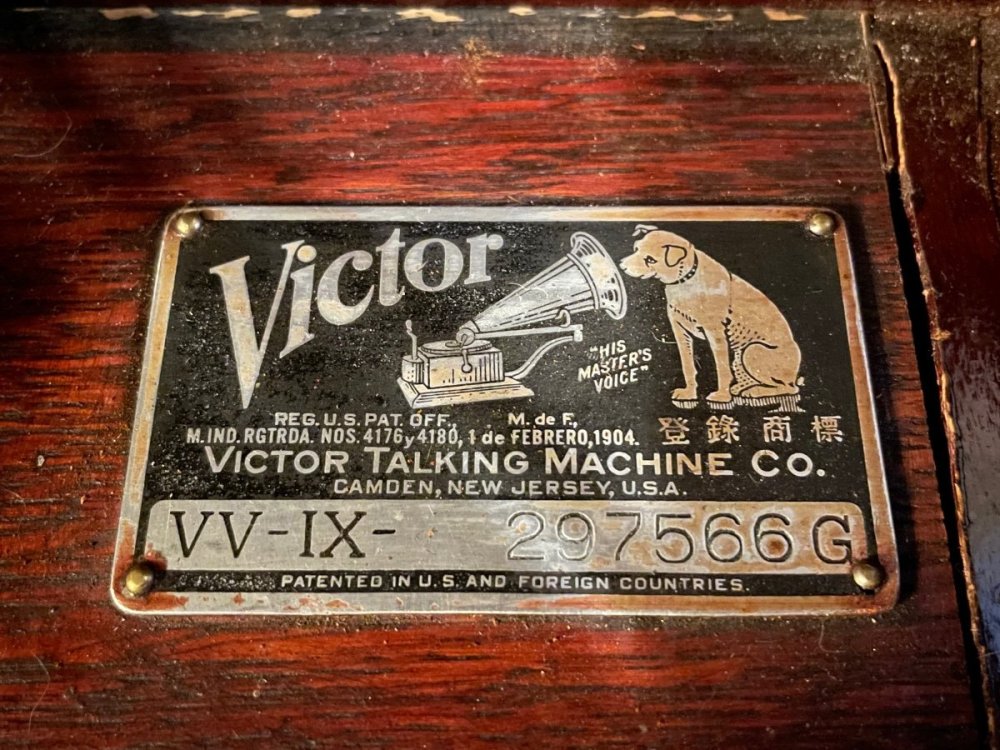

I was puzzled by a couple of things in your top picture, which shows the playing compartment.  The turntable does not appear to be a Victor product, and the speed control (which appears to be lying loosely alongside) is a common aftermarket design.  The outline of the missing trim plate strongly suggests a Murray style speed regulator/indicator (see picture below), but not with a turntable brake mounted above it.  The data plate shows conclusively that someone has combined parts on this Victrola, as the VV-IX was a table model rather than the upright shown in your bottom picture.
The cabinet of your Victrola is that of a VV-X, or possibly a slightly later VV-80 or 90 (they're virtually identical).
I suspect if you removed the turntable, we might find one or two extra holes, and possibly an extra hole on the right side of the cabinet, which would be a sure sign of a different motor being installed.  These marriages were rather common in the days when parts were unavailable and people wanted to make their talking machines operational again - especially during the Depression of the 1930s.

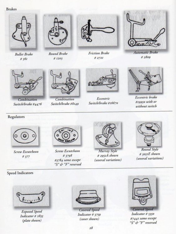

Anyway, here is a page from The Victor Data Book, by Robert Baumbach, showing some of the designs Victor employed for brakes, speed regulators, and indicators over the years.  (Note that there are several variations of the Murray style indicator not shown.)   If you're interested in obtaining one of these Murray style plates, you should contact George Vollema at:

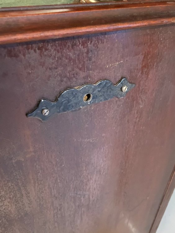

Thank you! I thought it might be a bit of a Frankenstein because my research showed the same thing about the serial number belonging to a tabletop model. But I just assumed I might be wrong or looking in the wrong places. Also, the trim for the crank supports your theory. It’s odd but it does the job.

That said, it would be a good idea to position the sound box in the center of the turntable for a measurement.  A needle in the chuck should ideally touch the spindle or come within about a quarter-inch one way or the other.  This will minimize record wear.  Sometimes the addition of a non-original motor will result in the turntable being too far or too close to the needle of the sound box.  This will cause rapid wear to records.
Ouch, I’m eyeballing the distance of the needle to the spindle at 1/3 to 1/2 inch.

Well, the good news is that Brunswick made outstanding motors!  Those I've had have been whisper-quiet.
More good news: you can probably obtain the original style motor for this machine for around $25.  Roughly where are you located?
