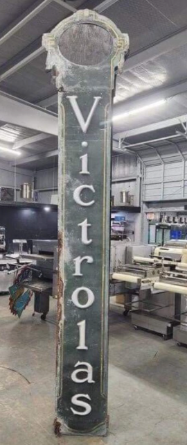

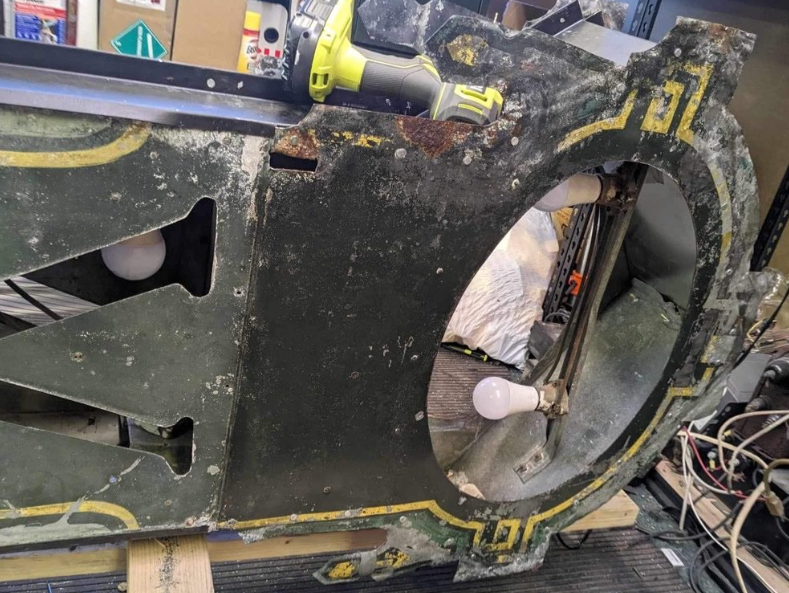

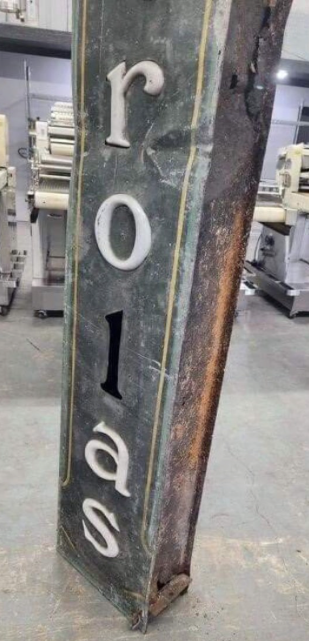

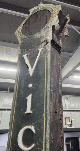

It's a miraculous transformation, considering where it started:
Screenshot2024-03-03at6_52_08PM.png.c2ce285147b896e40bc92bedcc068987.pngScreenshot2024-03-03at6_52_39PM.png.346e3ae5d0e436306399f97935463693.pngScreenshot2024-03-03at6_51_25PM.png.bf8749136acd52c0108d32dedb1edebb.pngScreenshot2024-03-03at6_53_23PM.png.4f9580a59250bffbd99e120eb232a180.png
Wow. Those pictures really put it into perspective. Great restoration indeed!

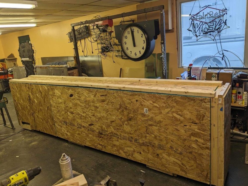

Details, please, on that clock hanging there. It looks like a Telechron dial, but the hands are definitely not Telechron!

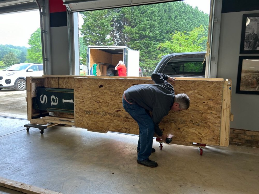

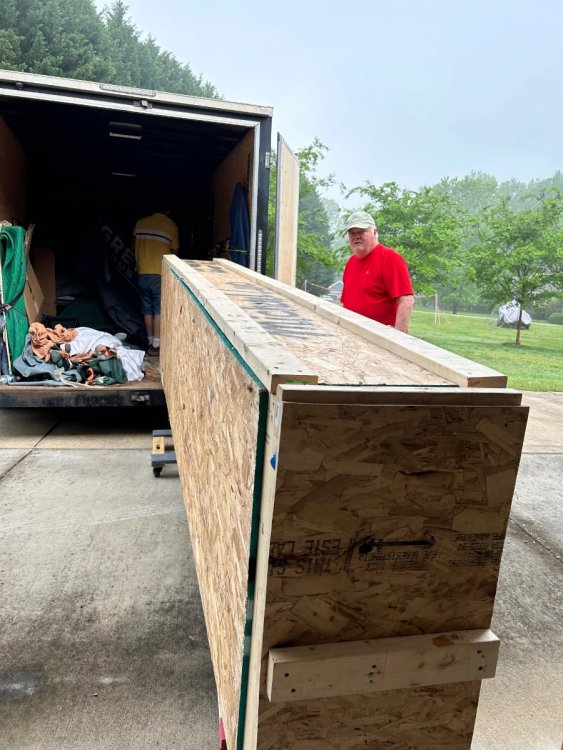

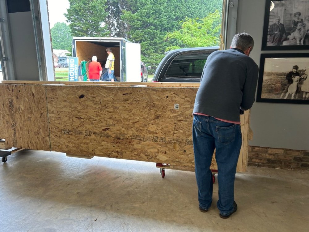

Fran, Mike told me it weighs approx. 400lbs crated, maybe half  of that uncrated.
Henry, the clock is in the restoration shop in Moorhead, MN, so you need to ask Chris Orth at:  https://firelineneon.com/about-us/
Mike, it looks like Chris did a good job on the crating, but at 400lbs. it's going to be a b!#ch unloading it into your music building...
Edited by CurtA

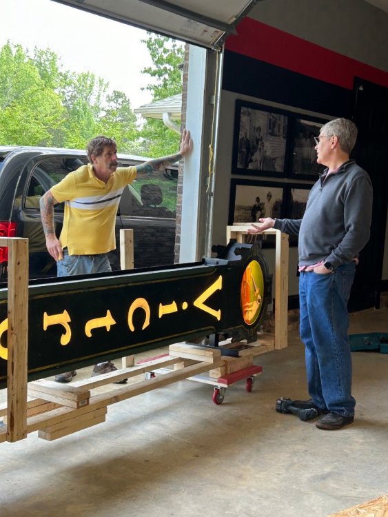

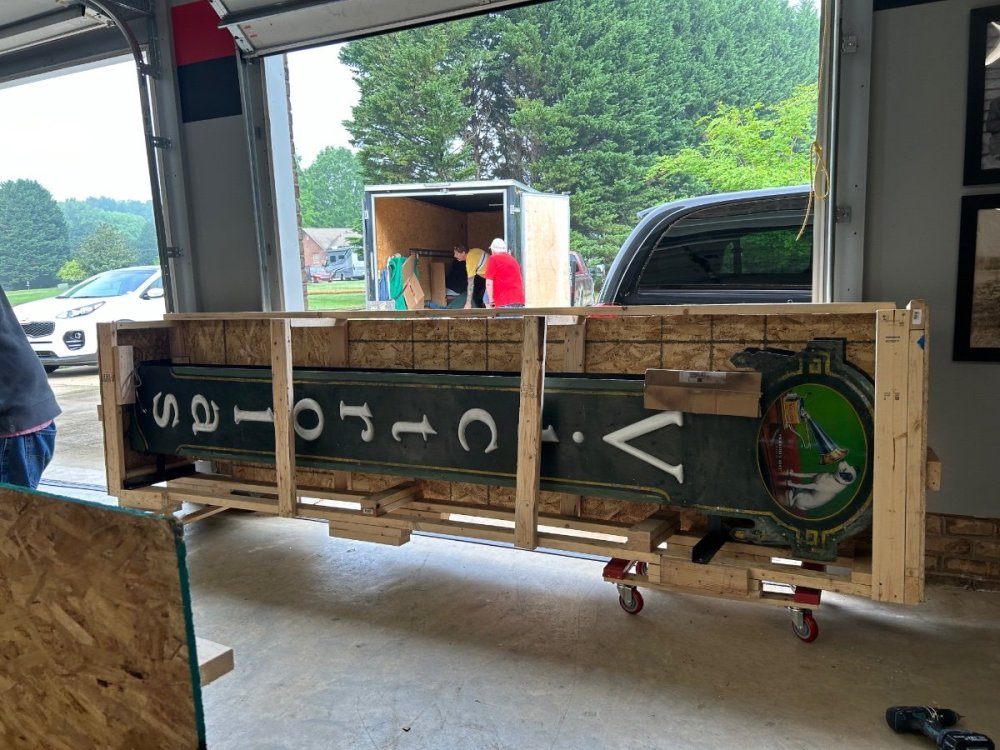

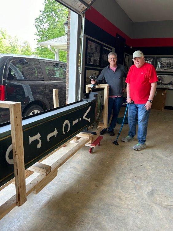

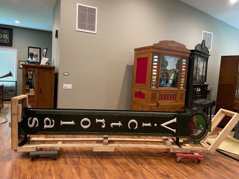

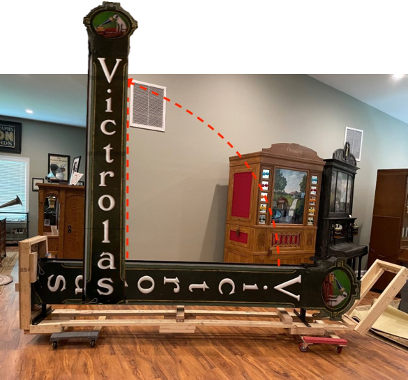

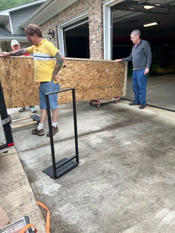

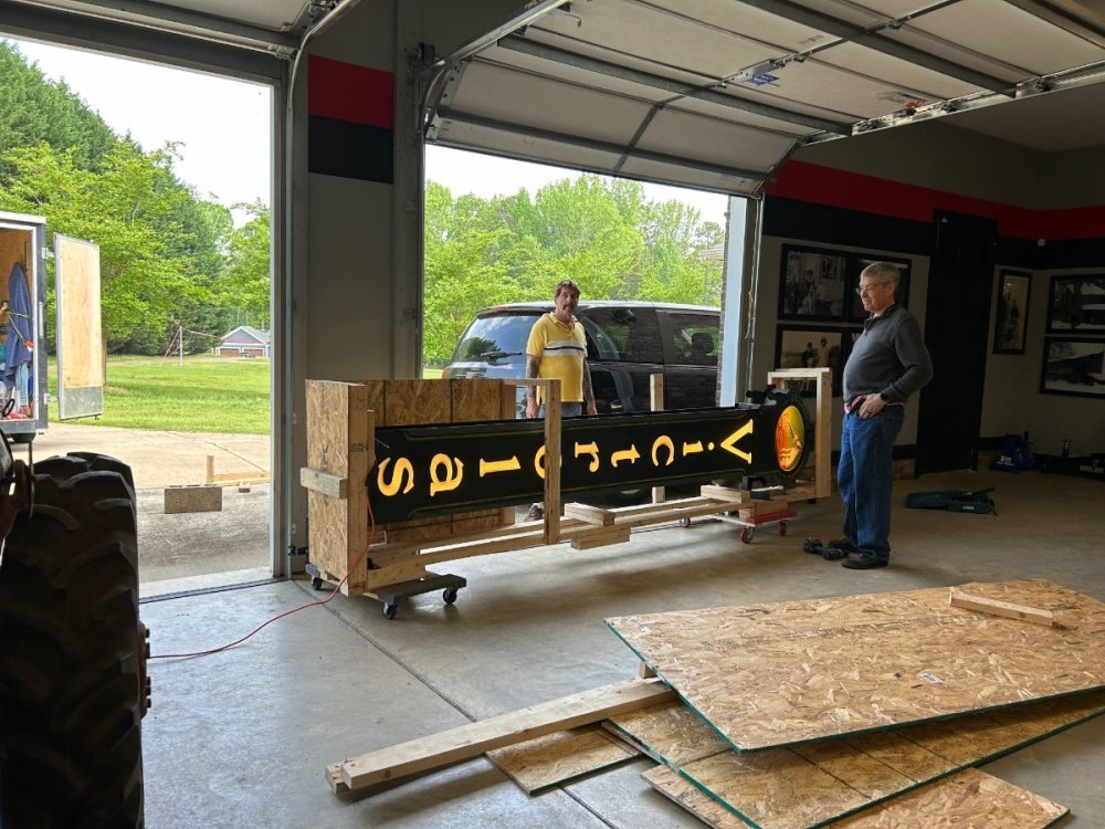

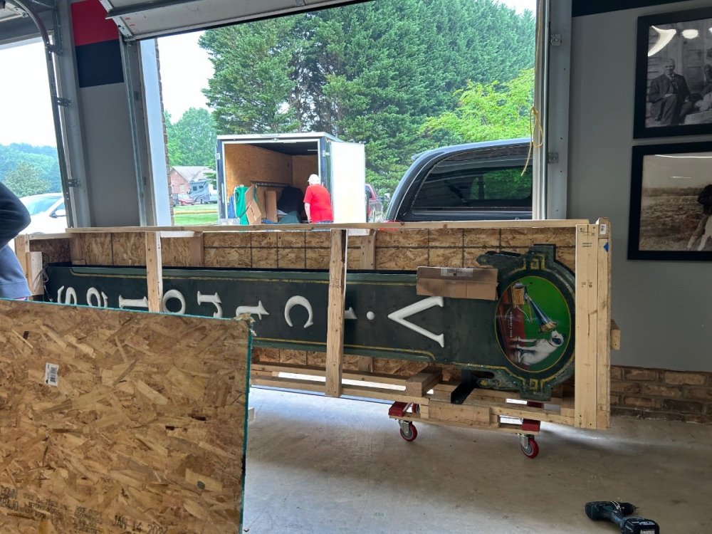

The sign arrived today. Delivered and uncrated. Now just thinking through how 2 old guys are going to get it hung up on the wall. Thanks to Curt for his help.
Edited by Mlund
Awesome looking sign.  Thanks for saving this great piece of history.  I'm glad you found a transporter for it.  Keep us posted on getting it hung up.  Ken Brekke
What a worthy restoration project!  I'm looking forward to seeing it in place, Mike.  Congratulations!

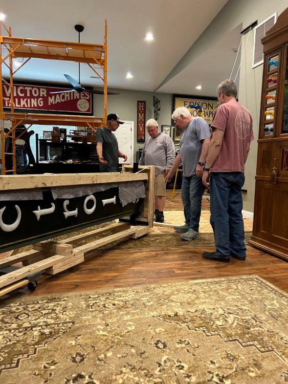

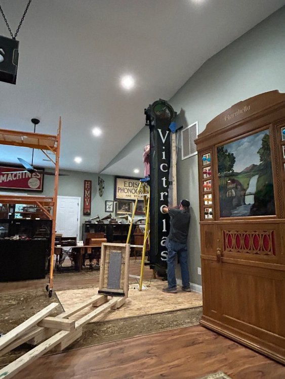

The only small problem is figuring how to get it mounted on the corner of this wall, while trying to prevent it from tipping over before its secured...

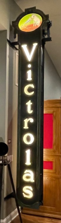

Hopefully, this is the end result...
Victor sign hanging #2 successful!!

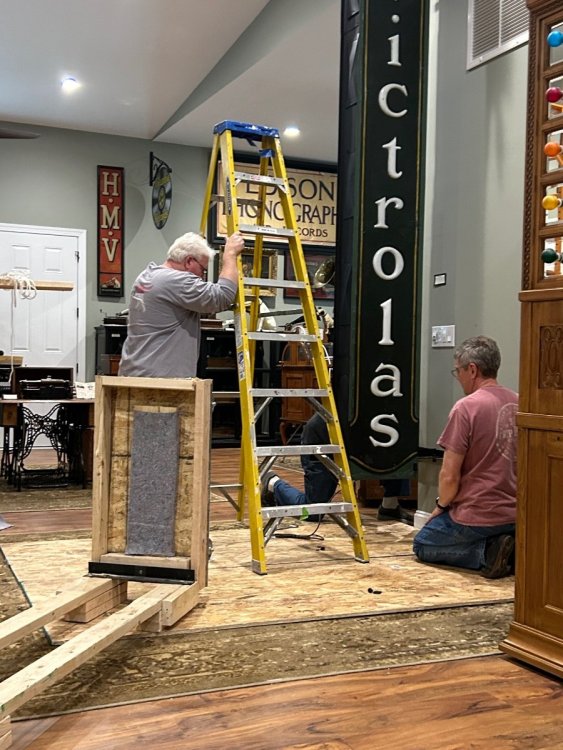

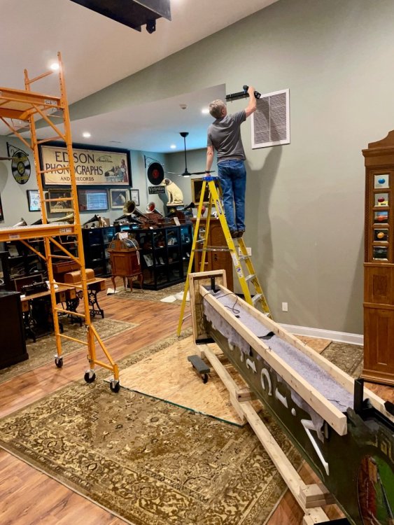

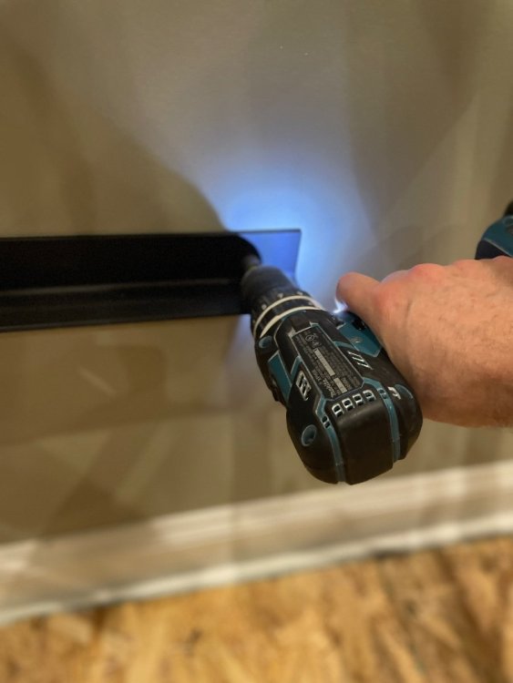

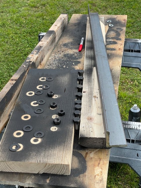

Prep work: Cut, paint and mount wall brackets.IMG_1240.thumb.jpeg.98c62b3aefb5bee2f27da3912592ba4f.jpegIMG_1245.thumb.jpeg.882ee5437feeafe8a510330a3de18126.jpegIMG_1229.thumb.jpeg.32c2e55ea967c6bff1021ac767ca2e58.jpegIMG_1202.thumb.jpeg.51b9f8cf7ee6c7e3e4f8fb6c153edebc.jpeg

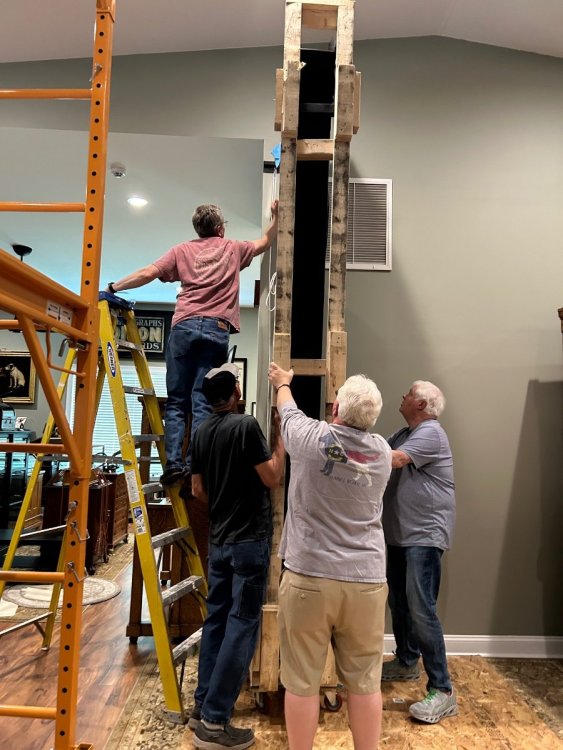

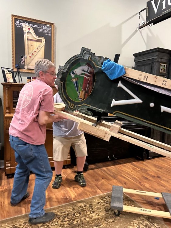

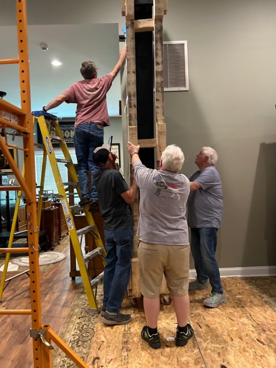

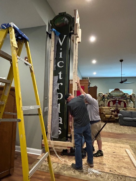

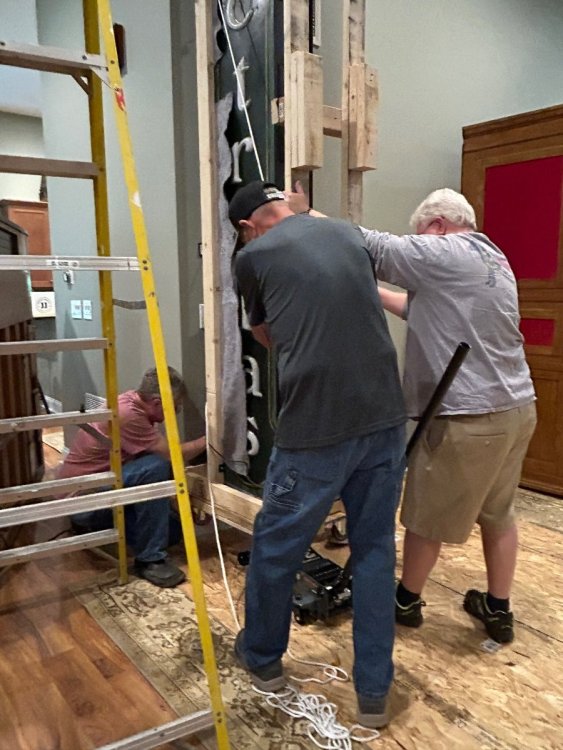

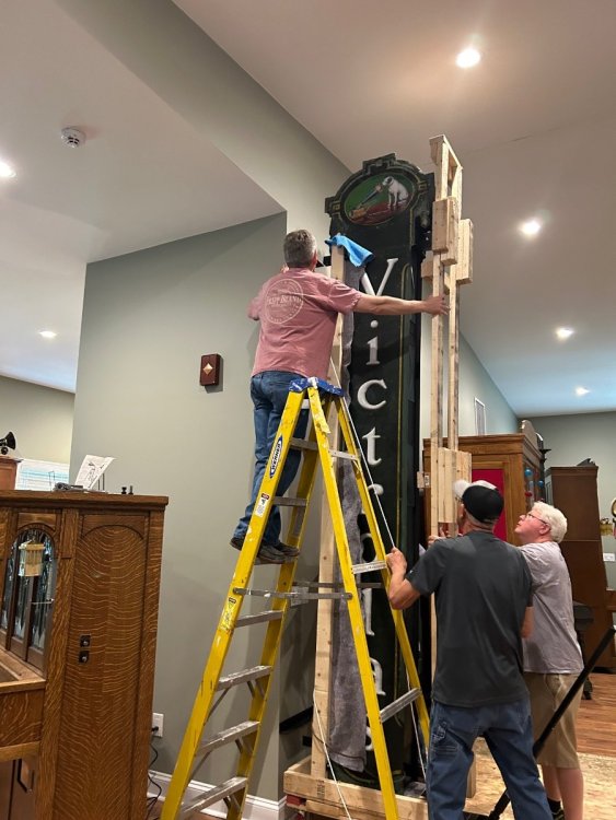

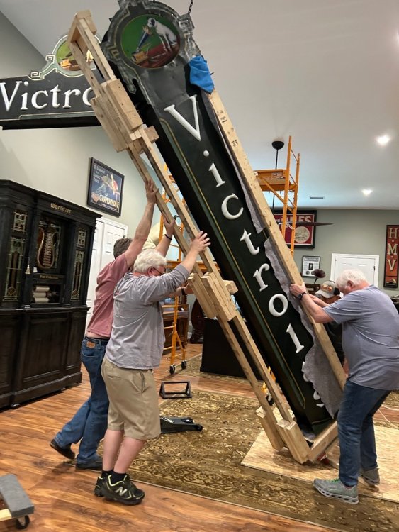

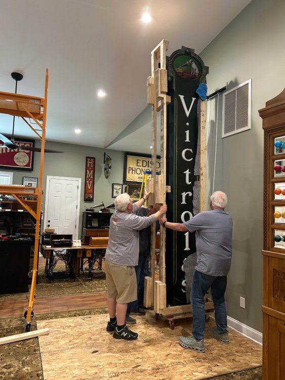

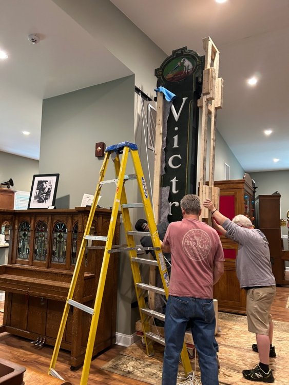

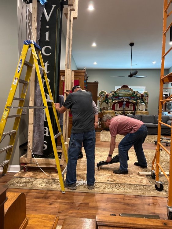

Step 1. Lift sign upright onto furniture dolly bolted to the base.
IMG_3543.thumb.jpeg.4c3dd9529fdaae947b3933a8bcdd2b9f.jpegIMG_3549.thumb.jpeg.9473ff18c7efe4b7d1c9217ea0c07391.jpegIMG_3555.thumb.jpeg.d5cbd46dde278ec17acabd25715ad55f.jpeg

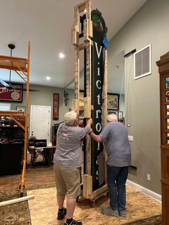

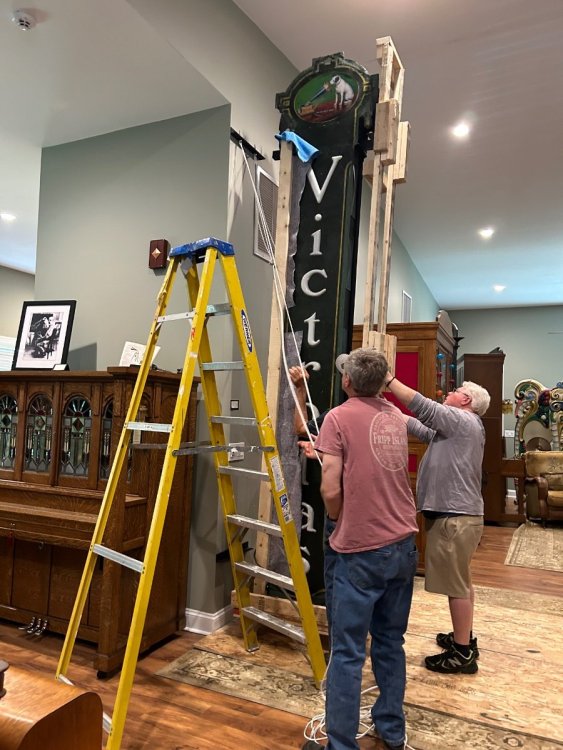

Step 2. Roll sign into position.

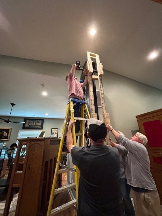

Step 3. Tighten guide ropes attached to the top of the attached wood framing and to the upper wall bracket eye bolt to keep sign from tipping over.
IMG_3584.thumb.jpeg.f83f6bfe3dba6227cf41e41d878fb921.jpegIMG_3582.thumb.jpeg.22a5ea54c4cbca90d3f4575d3873ba96.jpeg

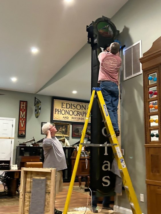

Step 4. Roll low profile jack under the floor dolly to lift the sign into position
Step 5.    Jack the sign up to proper height and position to attach bolts to previously placed wall brackets.
First upper bracket bolt
Then lower bracket bolt.

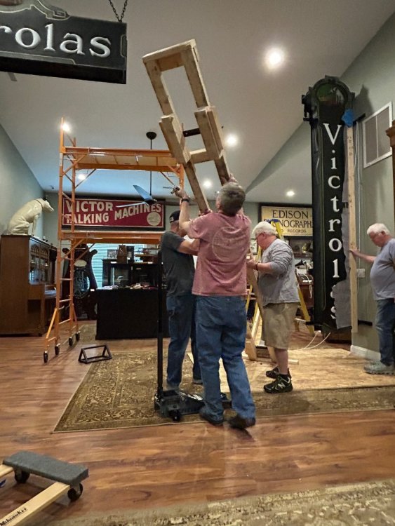

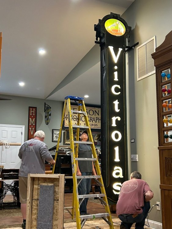

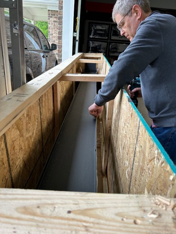

Step 6. Unbolt and remove the remaining crating from the sign.
Step 7. Lower Jack to remove crating
IMG_3673.thumb.jpeg.de7d48bfd8715431dde4e7367414f661.jpegIMG_3676.thumb.jpeg.1ee2371c03a868fd12edfa6253866a1e.jpeg
Step 8. Last bit of crating removed from sign.
IMG_3682.thumb.jpeg.58be3065d6e9245bd2bd685294d6c21a.jpegIMG_3683.thumb.jpeg.0b519d0eb20c5547eb755cb57e68e0e9.jpegIMG_3688.thumb.jpeg.1fd59d6076d882cb94a42f5d4fed22e0.jpeg

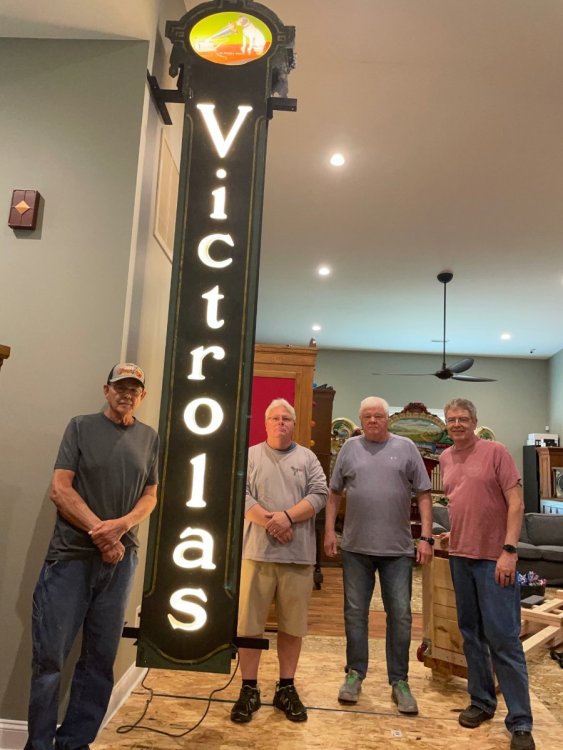

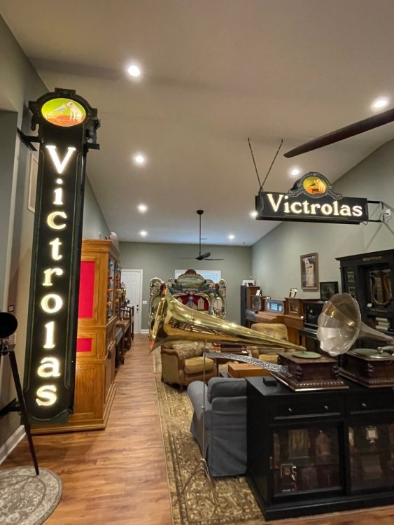

Step 8. Plug it in
Step 8. Sign hangers pose for posterity
 A special thanks to Bill Beam, Bob Barnes and Curt Angstman. I couldn’t have done it without their help. You guys rock!!!
Edited by Mlund
It looks GREAT!
Looking through the pictures and reading the steps involved was almost like being there - congratulations!
