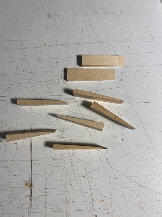

Here's a picture where I've placed bamboo shims on my coils.  Bamboo is harder than most woods, and the shims need to be tapped in firmly with a small hammer. Experiment with placement, and you should be able to reduce the hum.
Bob
Bob

Thank you for the photo! This really helps. I'll give it a try this weekend. Not sure where to get the bamboo shims! I'll see if I can find some online. They actually appear to be bamboo needles you have there? I have some on hand.

If you are going to use bamboo needled be sure to put the pointed long edge of the triangle against the metal and not the coil. That could cause a break in the coil wire. It is really best to make up some flat wedges to use.

You're right, Carlton! I have bamboo wedges left over from making needles and should use those as you suggest. Time to go in and make the fix!
