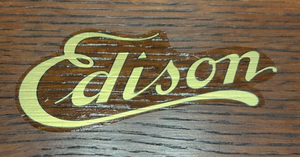

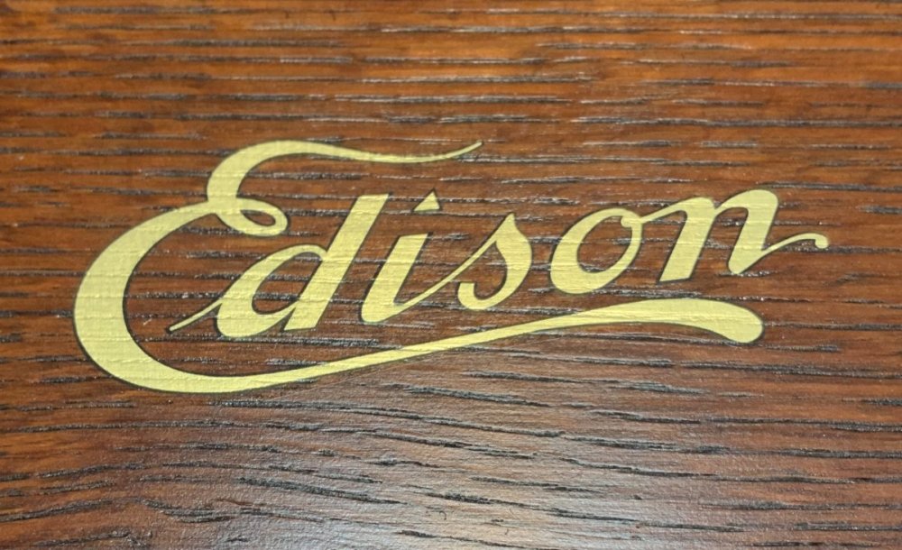

I almost feel foolish posting this here for such a seasoned bunch of collectors but someone might get some use out of it. I recently acquired a totally roached, rusted, and filthy Edison Standard Model B, originally for parts but I decided to restore because the challenge was great and I love a Herculean task. The case required stripping, so once that was done, sanded, stained, and finish applied (3 coats of clear spray l like the look), I ordered the decal from Greg Cline. The first picture shows the decal applied. It is tight to the wood but shiny. The second image shows the same decal after a final coat of the spray lacquer. The shine is gone and the decal looks like it belongs there. The final coat of finish seals the decal in place and makes it form to the wood even better. I apologize for the difference in lighting temperature but you get the idea.
That's just the way they're supposed to turn out - - nice job!

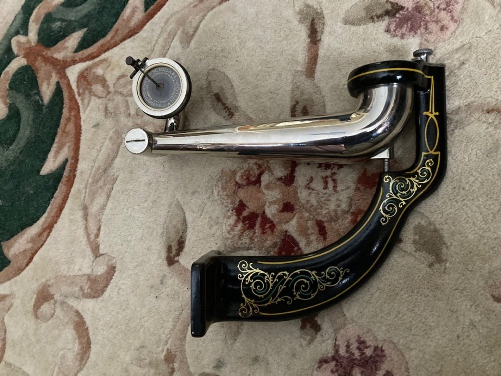

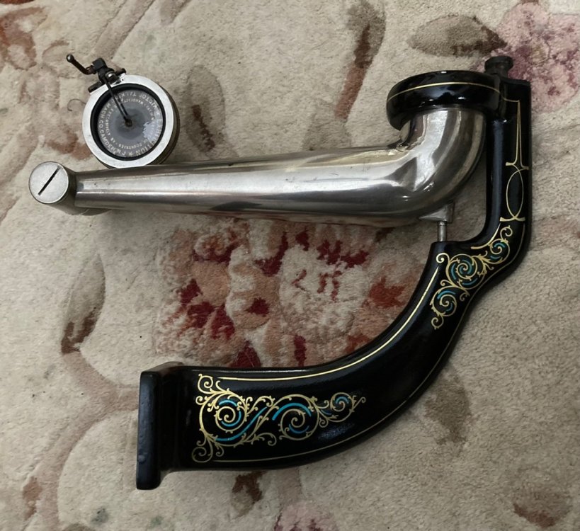

Here are two recent back brackets.  The first decal set is from Greg Cline and the other is from Eduardo in Peru.  I like both.  Eduardo’s were easier to apply, but I prefer Greg’s visually.
