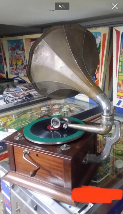

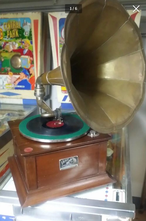

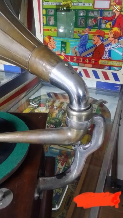

Greetings everyone, I’m new to the passion of talking machines, and about to start my journey in this amazing world with the purchase of a Victor gramophone a seller sent me the pictures of.
I have a doubt which may seem banal but I really need an expert’s knowledge and can’t find any infos on the web:
aren’t victor machine supposed to have another kind of horn, rather than this brass one? I know of painted black cone-shaped steel horns with a brass bell on Victor machines, but never seen a flower-shaped one entirely made of brass like this is. The rest of the machine looks genuine though.
Can someone help me with my doubts, before I fall in an incautious mistake?
thank you very much, have a good day!
O.
We could look it up in our books we own if we knew what that data plate says as far as model and SN. Neil
That is not a genuine Victor, but rather what is often called a "Frankenphone;" a machine made up from parts of several others - often of various brands.
Unless this is priced very, very cheaply, I'd walk away.  It's only value is in some of the parts.
Thank you very much, I was afraid of that… well it’s not very cheap actually (590€) so I’ll find another solution. I am very grateful for your quick answers, I’ll give you news!

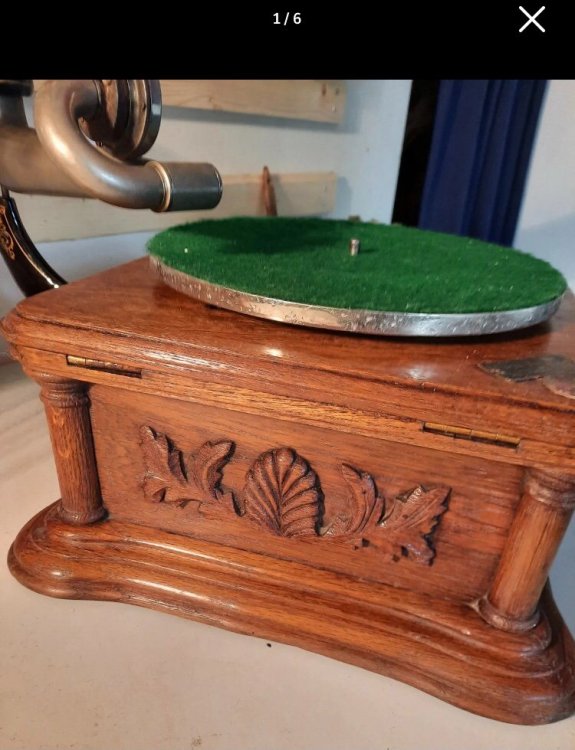

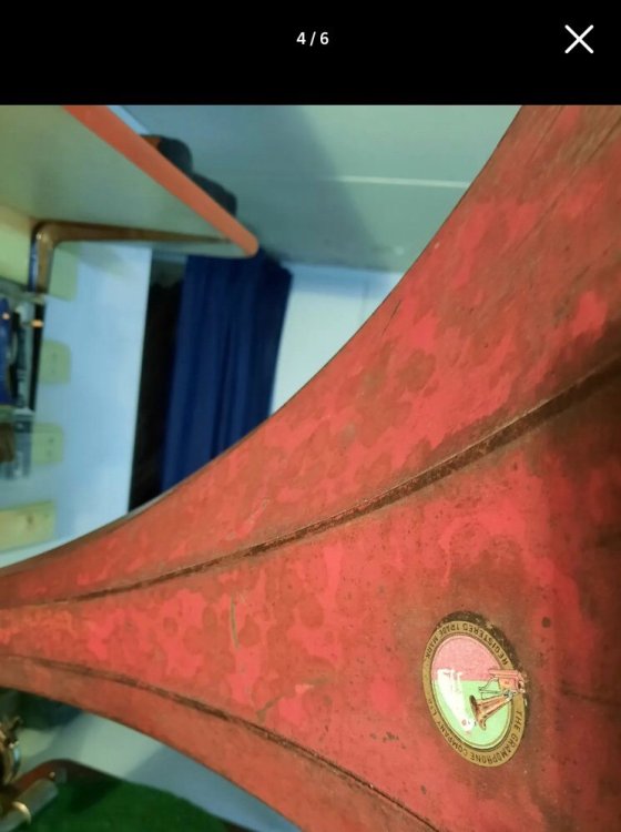

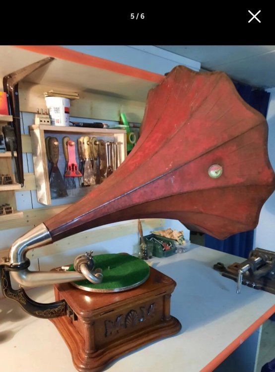

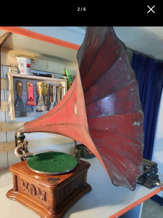

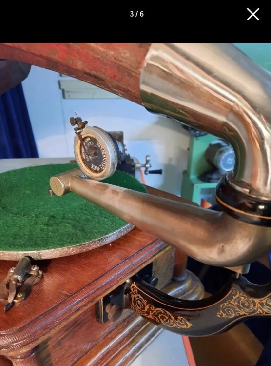

I have found an alternative from the same seller who’s a gramophone/jukebox etc. collector, and he’s got this Cockleshell Monarch for sale, I’m going to see it personally the next week. Price would be 900€. Here are some pictures, seems good to me but I would like to know what you think about it! Thanks again 🙂
Well, this could be an improvement, but...
It's troubling that the crank-side of the machine is not shown.  Since the brake and speed control appear to be in unusual positions, and there's something patched up in the front left-hand corner, it suggests this example may have been re-motored.
The back bracket is a U.S. component rather than a nickel-plated HMV.
I'd definitely ask for pictures of the crank side, and the motor as well.
There's an awful lot to learn about antique phonographs/gramophones, and it can be perilous for newcomers.  The investment in good books on the subject can save a lot of wasted money and heartache.  In this case, a look at page 30 of His Master's Gramophone, by Brian Oakley and Christopher Proudfoot would show you the problems with this machine.  If you're interested in HMV machines, I'd highly recommend this book to you.
I agree with phonogfp, Ockeghem.  Take your time.  Ask a lot of questions.  Ask for a lot of pictures.  Study the books.  His Master's Gramophone is an excellent reference if you can find it.
Cheers!
I can completely understand your excitement to buy your first machine and the temptations you face in your search but if you buy smart now, you will get far more enjoyment from your collection down the road. I have serious doubts about the pictured machine for all the reasons the other gentlemen stated. Good luck.
I'd also point out that the decal on that horn is upside down, since it's on the wrong side. Which means that horn did not originally go with the elbow to which it is attached. The machine is much better than the outright frankenphone in the first set of pictures, but it's been cobbled to some extent. At the price, you could do much better.

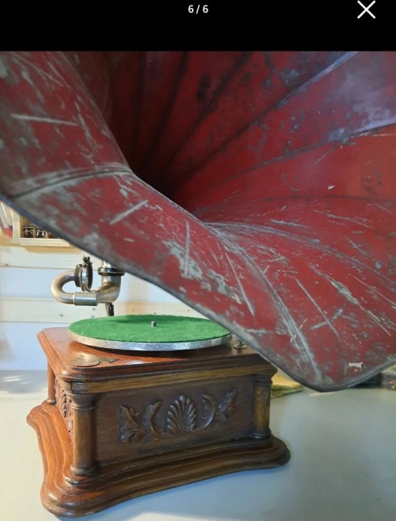

By the way, I have another question: I see around some gramophones with the horn directly attached to the reproducer (like the earlier ones) rather than with a tonearm. Someone can tell me the actual difference in terms of sound or disc wear? Do you think they are still valid for use, maybe with a horn that’s not too large?
thanks!
Do you mean something like this?  They are very attractive but not the greatest for enjoying records.  They don't sound great and are very hard on the records.

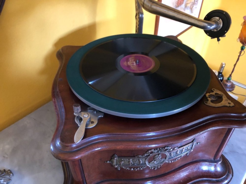

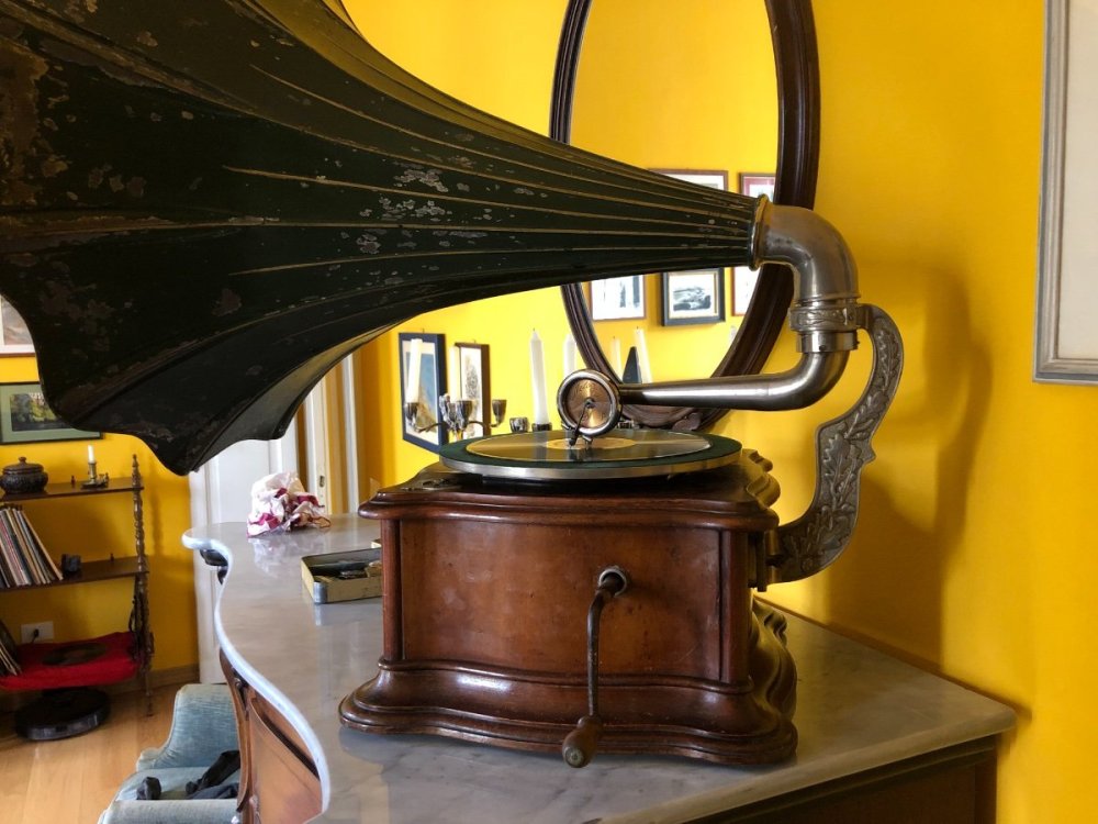

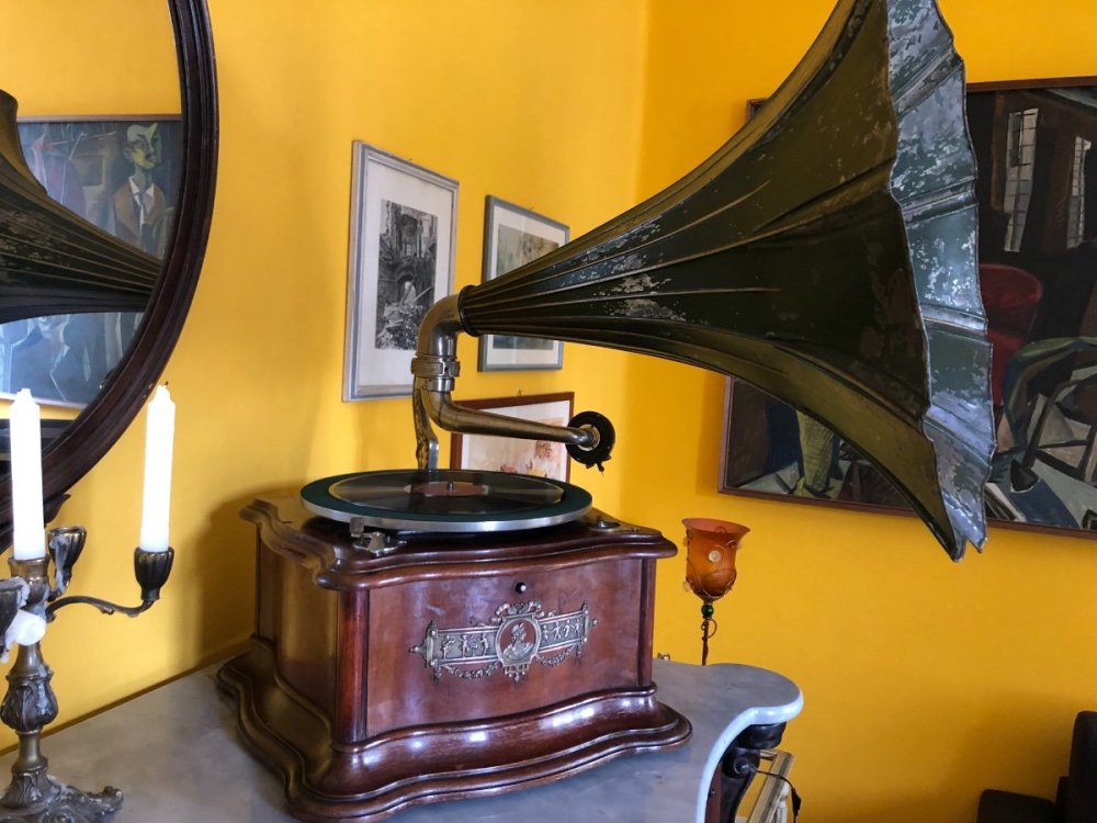

Hallo everyone! First of all many thanks to those who helped me out and gave me precious informations. It was really helpful and I learned many thinks that gave me more elements to judge the various machines I came across.

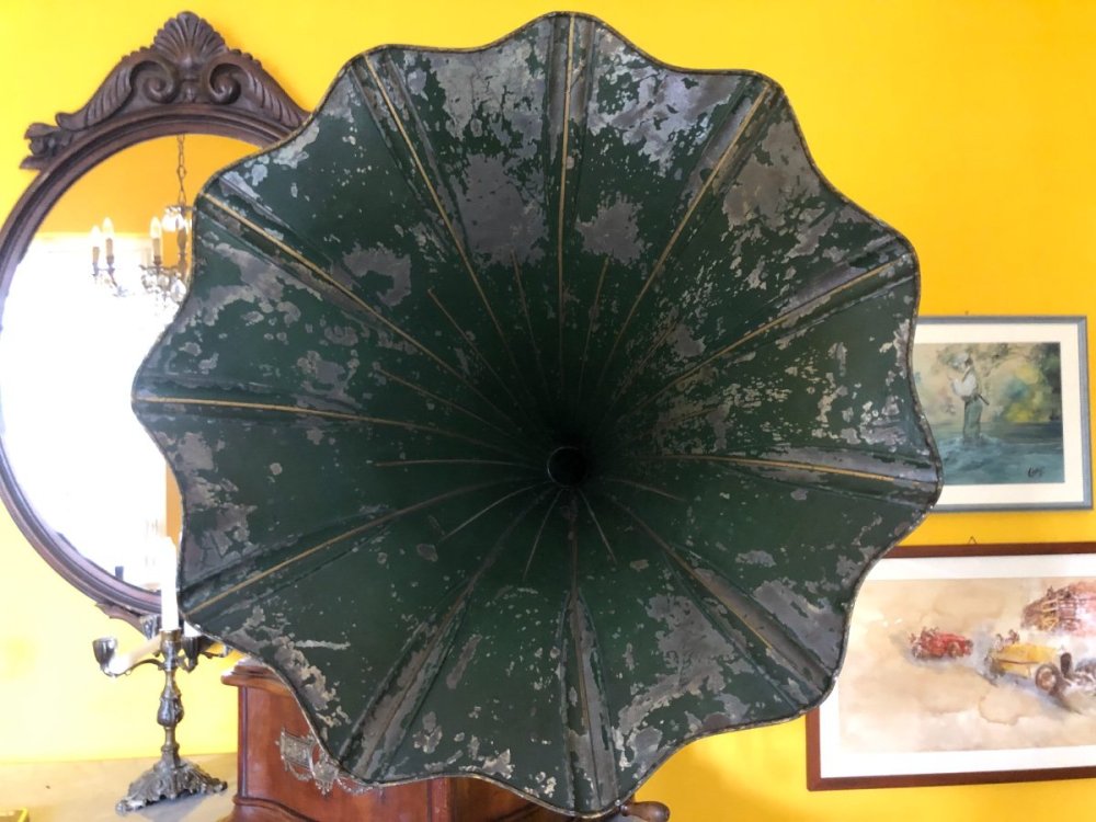

I have good news, for I have become the happy owner of this Paillard Maestrophone n.38 “Freyschütz”.
I chose it because I found it aesthetically appealing and uncommon (e.g. the beautiful “pleated” horn, which folds I find quite precious) and above all, since it’s a machine I’m going to use for music listening, it has a beautiful, quiet and in great shape Paillard GG double spring motor. Its sound is very clean and powerful, no distortion, reproducer is not original but it’s a genuine 20s one, Melodia Electric with a mica membrane. Just needed some oil, and it’s good to go! I found the price honest, and I took it home.
Here are some pictures.
I have been using it for two weeks now, and the spring is getting more fluid too, because I made him do some fitness in fully winding and unwinding for some times, and grease got unclogged. Records flow effortlessly without ever slowing down.
Glad that my future as a -poor 😆- collector just started! Looking forward, with time, to a Pathé and a portable! Thank you everyone again and I wish to you a good day.

Congratulations!  That looks great - -
WOW, that is a very nice, unusual machine - great start to a collection.
A very nice way to start a collection. Congratulations!
Andreas
