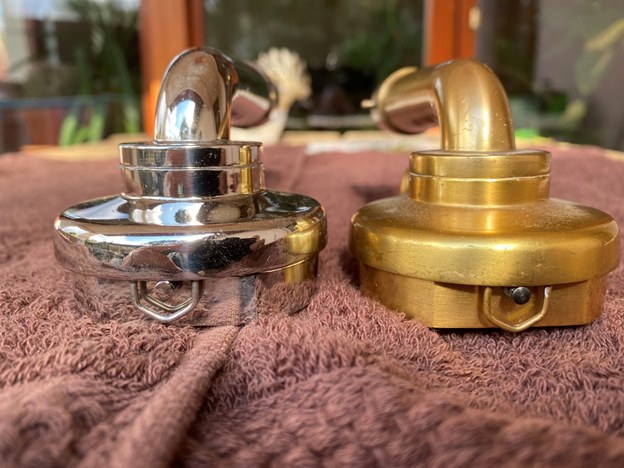

The shorter dance limit loop was removed and replaced with the slightly taller Edisonic limit loop. The Dance is notorious for skipping or bumping against the reproducer body or limit loop, causing damage to the records.  It is usually necessary to lower the height of the horn or place a 78 or something equivalently thick on the platter to center the limit pin.  Even if you do that, the next record you play might be a bit thicker or thinner requiring an additional adjustment.  The taller limit loop solves that problem.  In the below photo you can see the difference in size of the limit loops.  The nickel reproducer is an unconverted Dance.
Above - Comparison of limit loops, Dance (LD 11174) on left, Edisonic (LD 12531 NS) on right.

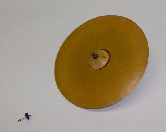

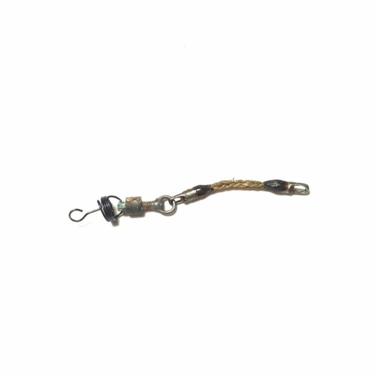

In addition, the Dance diaphragm was replaced with the Edisonic diaphragm.  The Dance diaphragm is the same thickness as the standard diaphragm requiring a second spring to maintain tension on the stylus.  One spring is on the stylus bar.  The second spring, shown in the photo below, hooks up to the not seen side of the diaphragm and a cross bar in the sound tube.
Dance Diaphragm showing spring which connects to cross bar in sound tube
The Edisonic diaphragm is about .002 thicker and retains only the spring on the stylus bar. The Dance Diaphragm, shown below, also has a stiffened spring wrapped link.
Stiffened spring wrapped Dance Link on Dance Diaphragm
1760064949_EdisonDiamondDiscDanceReproducerDiaphragmlinkandSupportSpringAssembly.thumb.jpg.6e6aabf0e3752c0f3125b05b76254190.jpg
Closeup of Dance Reproducer link and spring

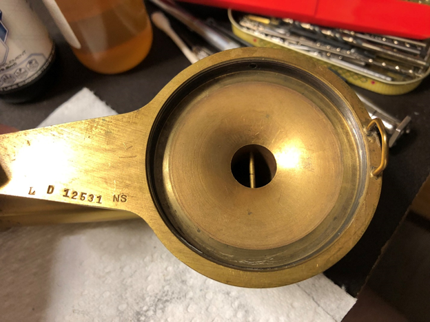

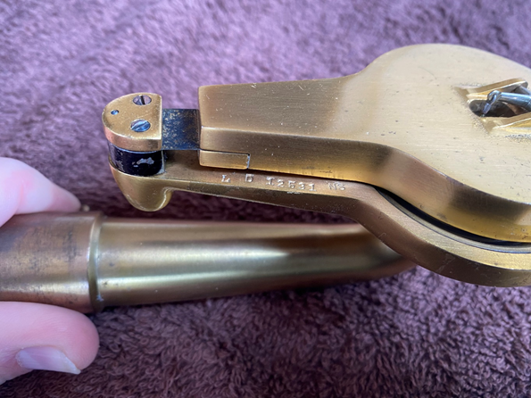

Finally, Edison stamped an “NS” at the end of the serial number and “LD 12531” became “LD 12531 NS”, the NS for “New Standard.  You can see it in the photo below.
Dance converted to Edisonic no. LD 12531 NS
Bar for hooking the upper spring from diaphragm on LD 12531 NS

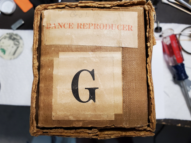

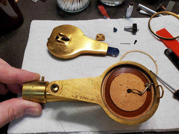

Why do I think the conversion to Edisonic was done at the factory?  In addition to Steve’s observations over a period of years, there is that “NS” stamped into the body.  Also, I bought a second gold Dance, well sort of… sometime later, this one NOS in the original cardboard and wooden box you can see below.
Dance reproducer converted to Edisonic, never having been sold  - LD 12993 NS
Guess what?  Turns out it’s got the Edisonic diaphragm, limit loop and the body is stamped “LD 12993 NS”.  So… yes, it started out as a Dance and was converted to an Edisonic too, without ever having been sold!  A photo of it is just below.

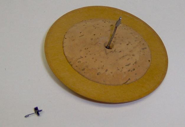

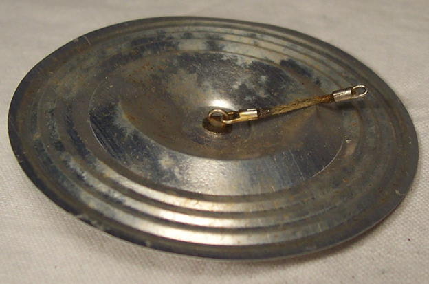

Now back to LD 12531 NS for a bit.  It is conversion to an Edisonic was not the end of the story.  Sometime later, probably in the thirties or forties, it was converted again, this time replacing the existing diaphragm with what is speculated to be an Edison factory aluminum diaphragm and linkage which were apparently used for repairs after Edison ran out of rice paper diaphragms but was still doing repairs.  An example of such a diaphragm is below.
Edison Aluminium replacement diaphragm

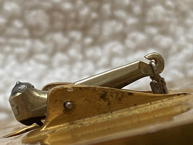

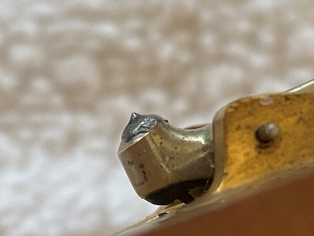

And finally, there is the very unusual diamond stylus I should mention original or from the 1930s?  The diamond is larger than normal and clear for reasons unknown to me.  Two photos just below.
LD 12531 NS unusually large clear diamond stylus

Do you know what the "G" on the factory box signifies?
Cheers,
Fran
Cheers,
Fran
I think the "G" on the box indicates a gold finish.
Correct.  The boxes I've seen have been marked "G" for gold, "N" for nickel and "A" for antique or gun metal finish.
