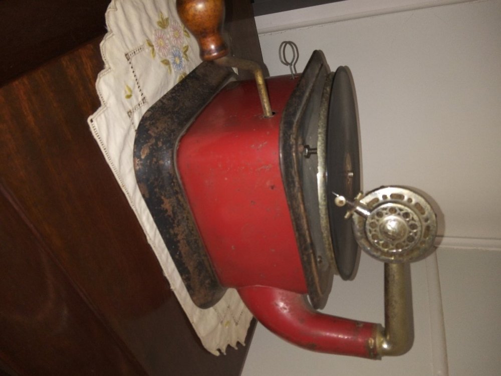

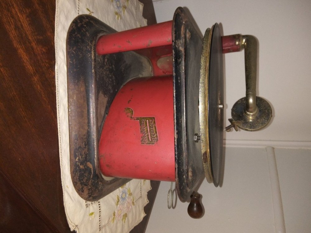

Can someone please provide information on the Graphophone in photos. It appears to be a toy 78 player made of tinplate, previous owner purchased it in 1918. Thanks for any information. Regards.

Thank you phonogfp for the reply and information. This explains why I have not been able to turn up any info on the web, some of my post was lost in transmisslon, however I am so happy to receive your reply. The suggestion that this machine may have been made in Germany could have some credibility seeing that in that era they manufactured a lot of tinplate toys.
Thank you once again .
Regards  Schulz (Rob, Australia)

I just want to add to my original post that there is Factory 17 lightly stamped on the base of the machine . Maybe this may help further ID.
Regards  Schulz (Rob Aus.)
