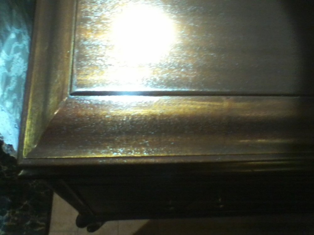

  As to the case of the 02nd machine, YES, I did give that one a good cleaning and waxing with a Beeswax, linseed & etc compound. The Polish was also a Beeswax product-- NO petro-chemicls on this wood . It went from looking like the black top in a parking lot, to a 'like new' sheen, and slick enough that you can toss a coin on the lids and watch it skate across the off the other side. And it smells Wonderfully.  The 02nd machine is in good running and sounding order.  Of course, I have been buying the records for it, and enjoying the music.

Great work! I'd love to see pictures.

A request for a Photo of the cleaned and happy wood work is happily given. Enjoy
