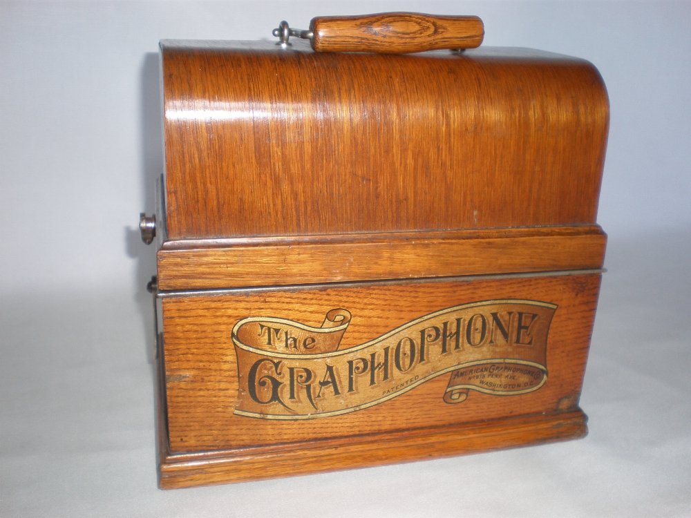

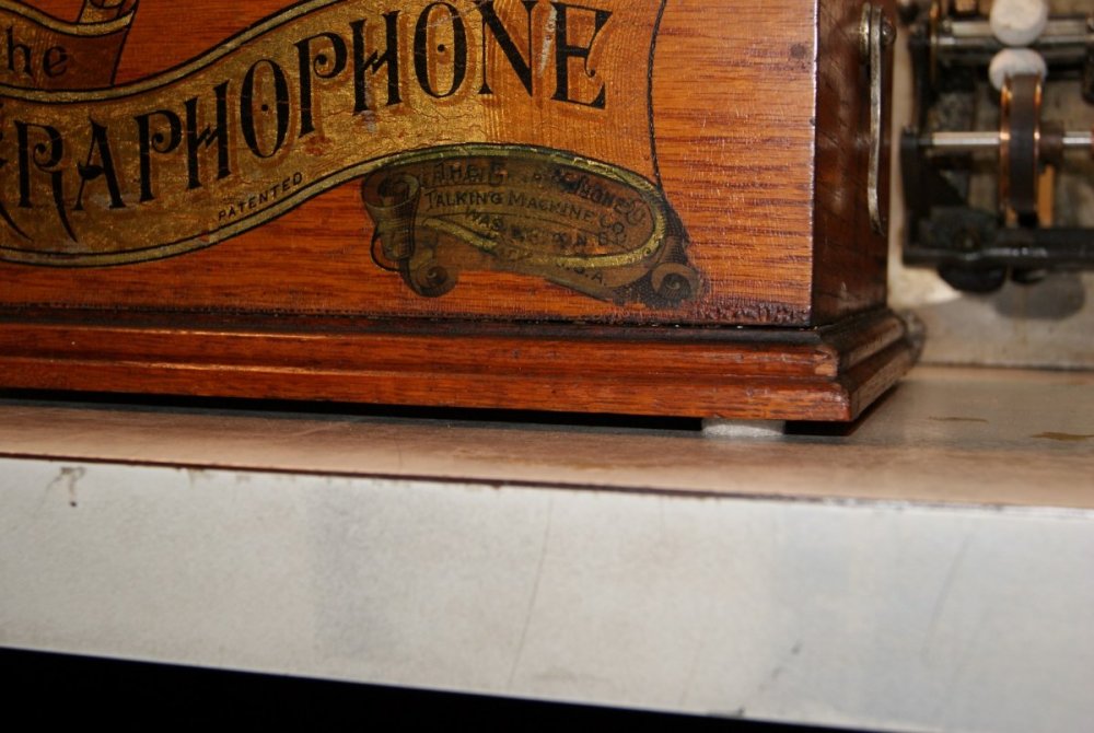

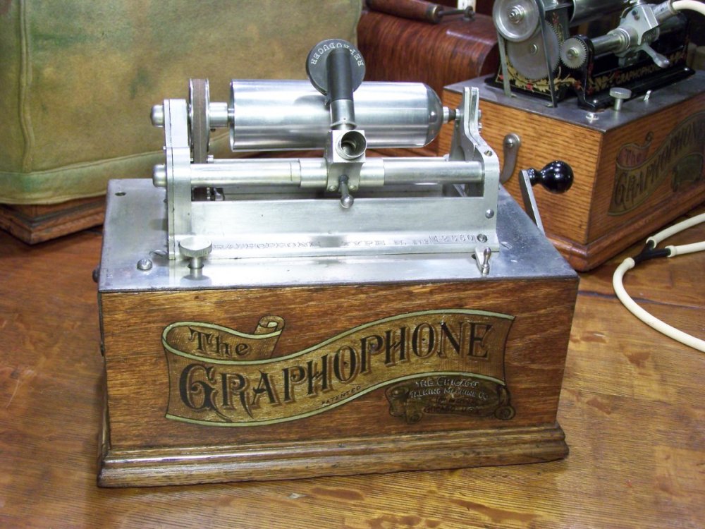

Here is an example of the conventional version of the Type N Graphophone.  This one is #42660.  The on/off lever is unmarked.  This one happens to have a Chicago Talking Machine Company decal applied over the lower right-hand portion of the Washington DC Graphophone decal.

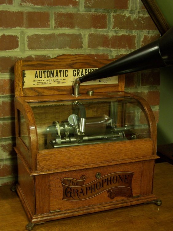

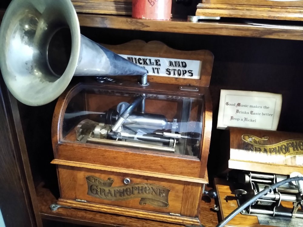

Here's an N coin-slot.  This one is #44981.  Unmarked on/off lever.  Also sporting Chicago Talking Machine Company markings.

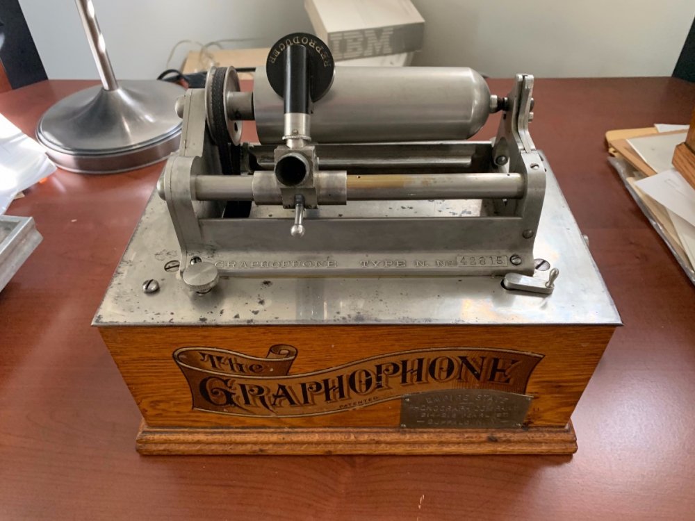

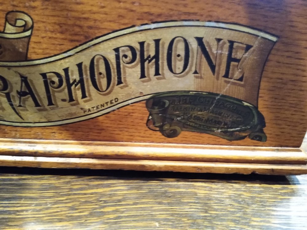

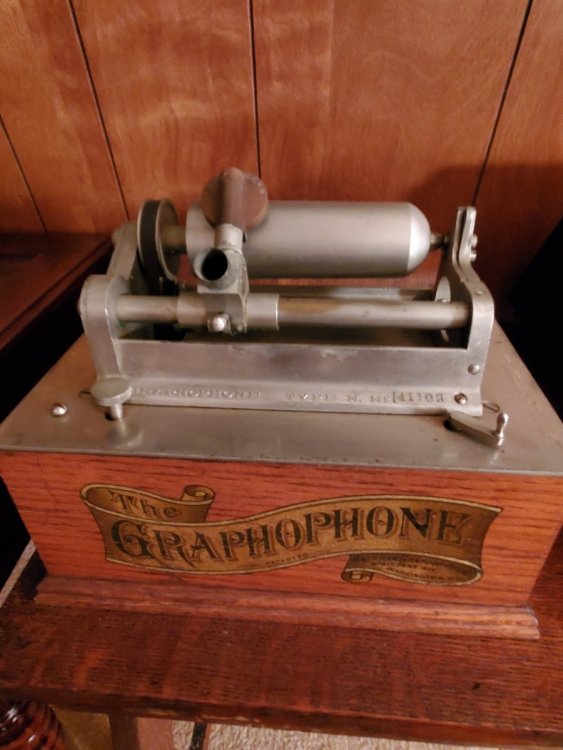

SN 41803
Case is typical except(?) for two ~2-inch x ⅛" notches cut into top left edge.
No stamping on switch lever.
A "The Chicago Talking Machine Co." decal covering the Washington D.C. portion of the Graphophone decal.
No Gutta Percha reproducer came with it (as I suspect is the case for many).

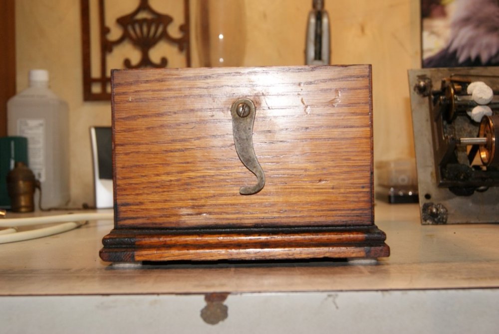

I assume the lid latches may have been the same throughout, but in case not, photo attached.

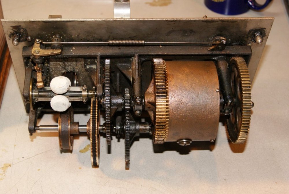

I'm also attaching a photo of the motor, in case you might identify any significant changes over the course of production.

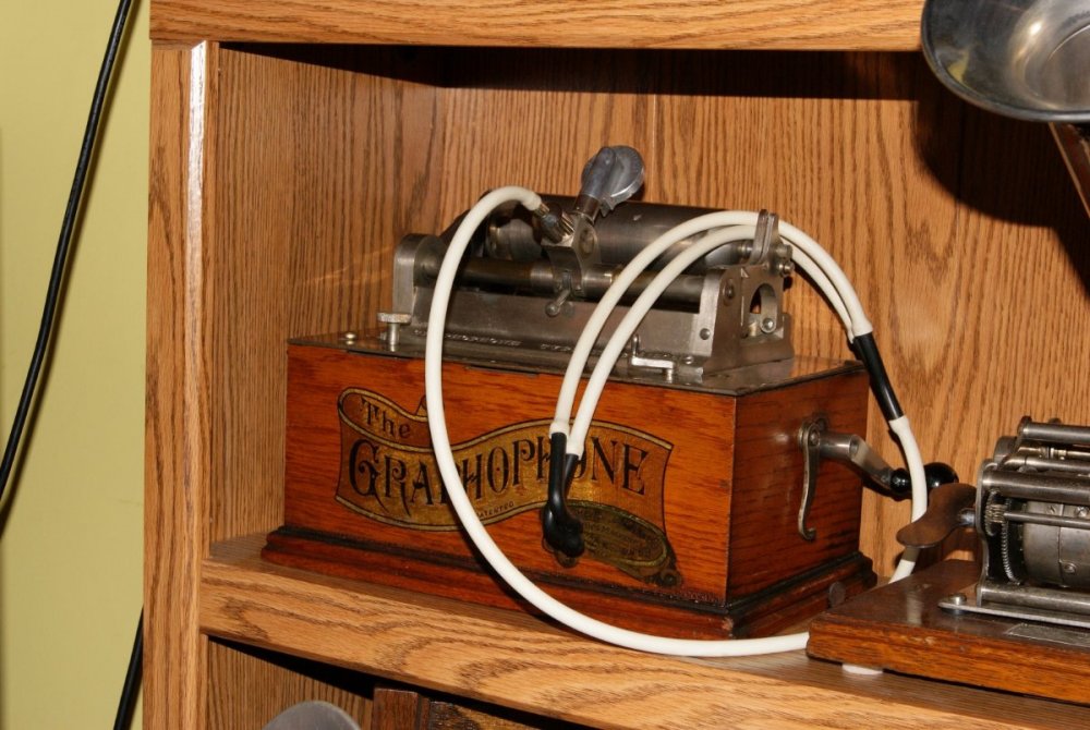

Another source of pride for me is that the former owner (George Paul) contributed a very nice photo for the March, 2015 issue of The Antique Phonograph to accompany his article "The Type N 'Bijou' Graphophone", and has given me permission to share it here alongside my own images.
It's merely a happy coincidence that it lives right next to an Eagle. ?

One curious data point at the moment is that there's a wide range from 43889 to 44981 which are all coin-ops (six in total).  This is, of course, based on very limited data, but it's interesting. There's one coin-op well below that range, and one well higher, but that cluster comprises 75% of those recorded to date. I find it very unlikely that Columbia made a thousand-plus in a single run. I don't even believe they made anywhere near a thousand in total. Obviously we need more data!

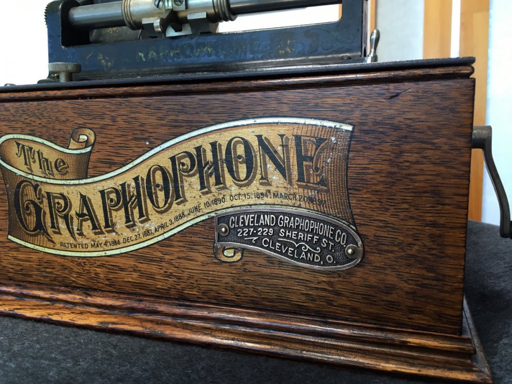

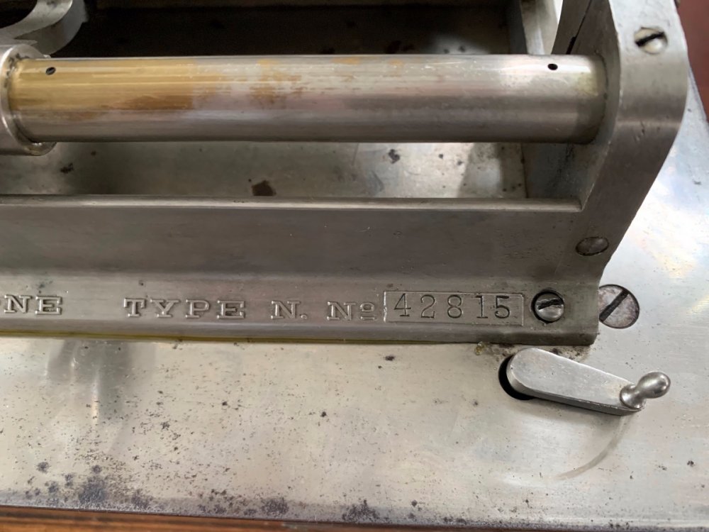

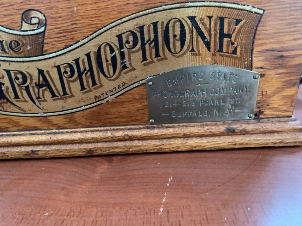

s/n 42815 with spiffy Empire State Phonograph Co. tag
I'll second that comment -- I love that dealer tag!
Back off, you two!  Mike has already promised that machine to ME!  (You do remember, don't you Mike?  Old buddy, ol' pal?)?
  • Haha 1
This is slightly off-topic since it's on an AN, not an N, but it's in the family -- and it's one of the coolest dealer tags I've ever seen.
That's really nice Rene! Metal no less. Gorgeous.
-Fran

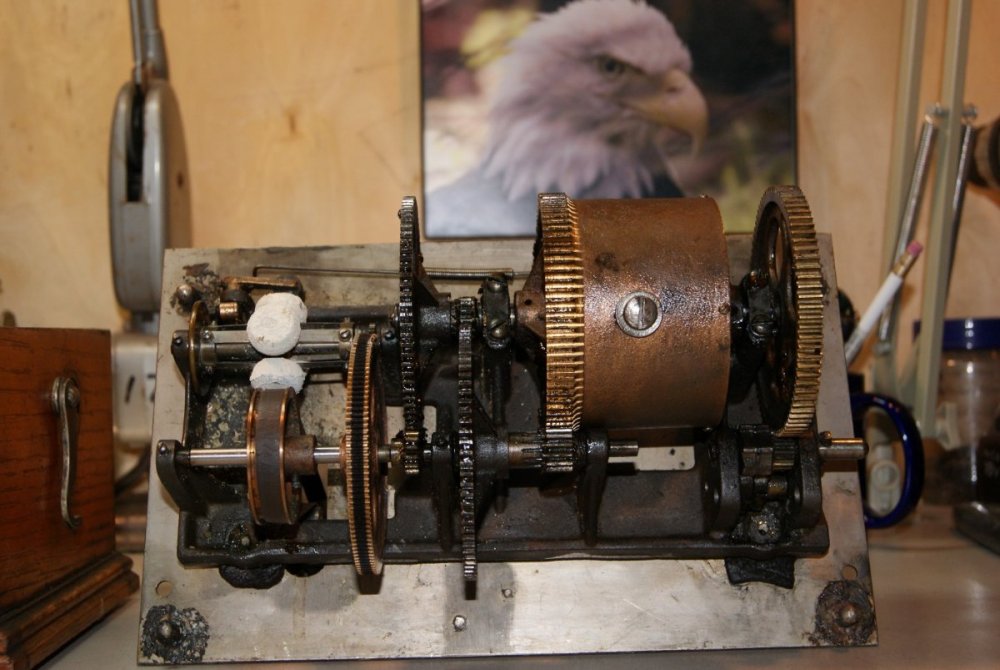

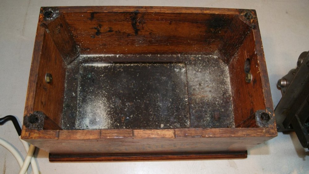

I promptly forgot to post a photo of the motor in mine, my apologies. I understand that wonder if the earlier motors had a cast iron mainspring barrel, whereas mine has been replaced long ago with a brass one (the original cast iron barrel had broken).
I'm not able to amend my earlier post, so I'm attaching photos of my motor here, and hope others might also for posterity.
Rene, do you have information as to when (through serial numbers) the change might've taken place? I hope I'm not taking this thread too far off course.

In the course of examining a number of Type N and Type F Graphophones, as well as Macdonald motors that were sold to convert Class M Phonographs to spring operation, I noticed that the earlier motors had cast iron spring barrels - - as did Fran's No.41803.  (It was broken - with a piece missing - when I acquired it, but I was fortunate in finding a partial Macdonald motor with an intact brass spring barrel.)
As with other production changes in early talking machines, there may not have been an immediate switch from cast iron to brass, but in general only early Type N Graphophones will have cast iron barrels.
Thank you, George. I'm always curious as to design/production changes. Especially the "invisible" changes most are/were not aware.

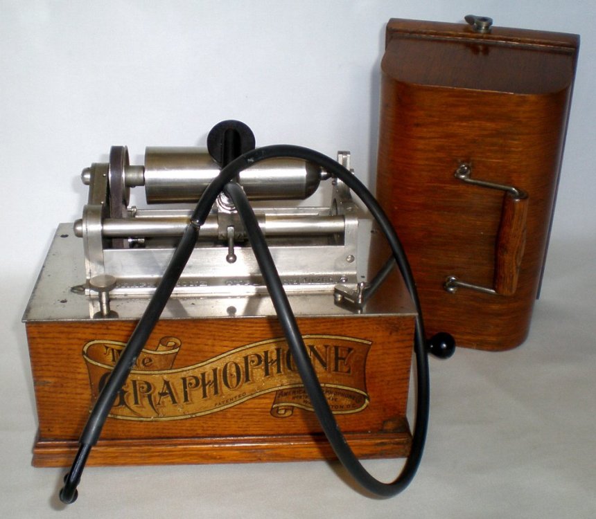

Hi Rene,
Here is my contribution.  This is a great topic.  I've learned something.
Rob
What an exquisite example! And very early.

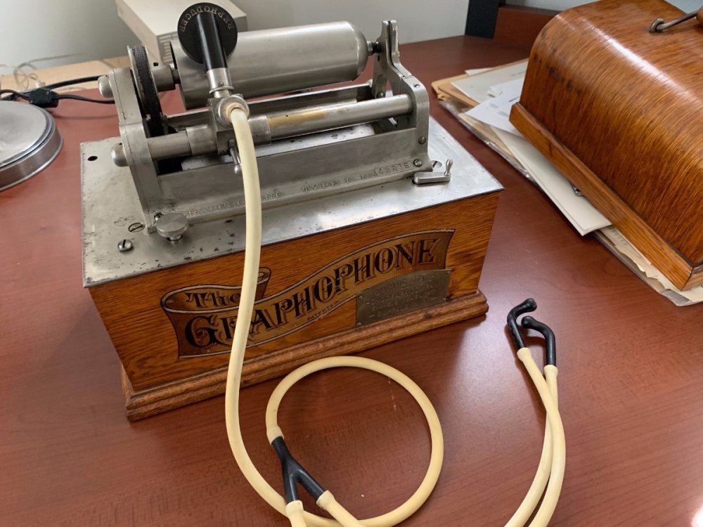

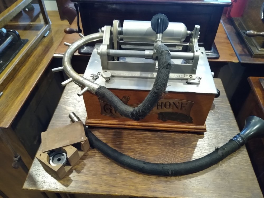

I have two examples.  A home N with a crescent listening tube rail and Chicago Talking. machine decal. SN 41847.  No markings on the on off.  Gutta  percha reproducer / recorder.

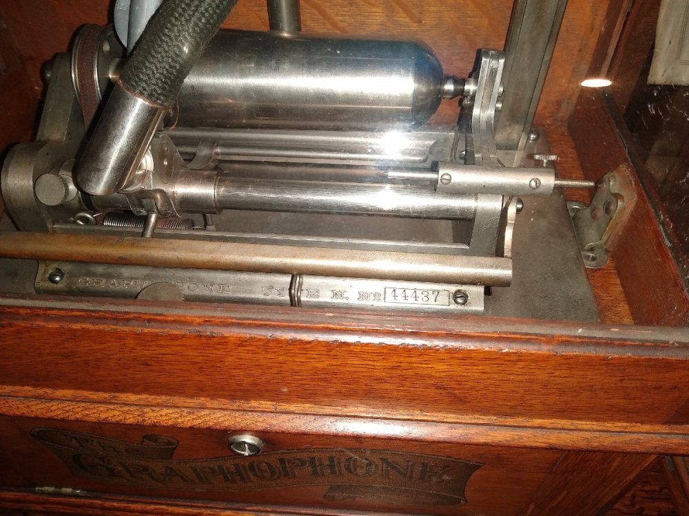

Second is a coin drop version. SN 44437.  Original throughout.
Gregg
Say Gregg, your No.41847 is only 44 units beyond Fran's No.41803 - - which originally had a cast iron spring barrel.  Is yours cast iron or brass?
George,
My N has a cast iron spring barrel..
Gregg
