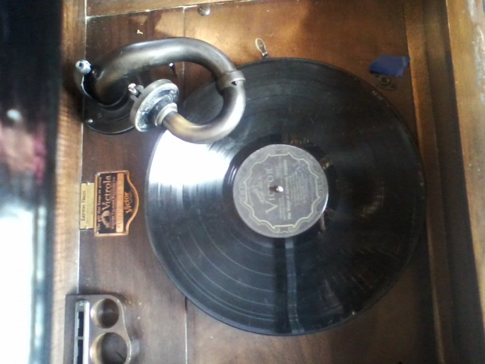

  So, a post 1925 Canadian Victor gramophone sits happy and waiting to be fixed and played. In short description, it is a HEAVY mahogany? with black lacquerer finish cabinet, the size of a small end table. It has the two doors for the 'speaker', with the original grill cloth intact. The Interior is near perfect. The machine is from Canada, see the poor excuse for photos. It runs but it 'grinds' when it turns.

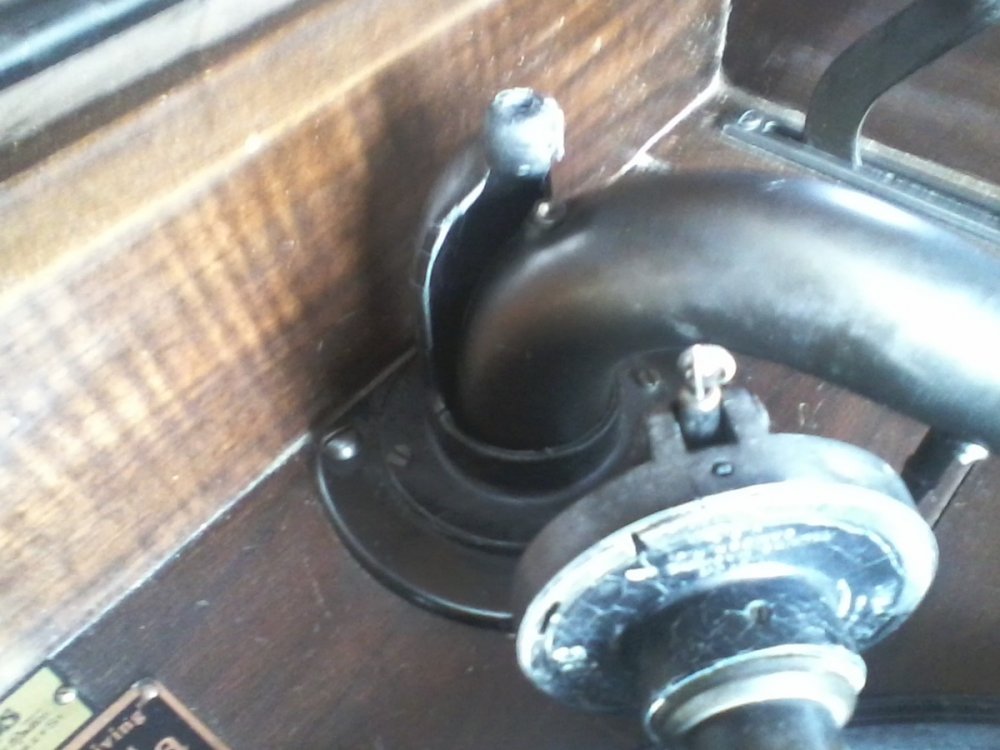

 Now the questions, 01} after I take out the 04 screws, and lift the turn table, how do I get the wooden cover off the motor?  It LOOKS like the brass speed adjustment device is screwed to the wood work{see the photo of the interior, the dial is marked with blue tape], and the motor?? 02}. You will note the tone arm is broken. IF I unscrew the tone arm, and  separate the two parts, do I just need one LONG screw to put it to working condition --OR??--?  03] Most Important, can anyone point me to Source Material on this, so I can learn of it-- and any repair shops for the motor, in the New England, {USA} area, for any repairs??  Sure, by the videos I have seen 'its easy". The videos do NOT know this 'mechanical challenged' writer of this story!!

1)  You didn't mention whether your machine's motor is spring-driven or electric.  In either event, you don't need to remove "the wooden cover" from the motor.  The motor is mounted to that wooden motor board.  Simply remove the screws located at the corners of the motor board.  If your motor is spring driven, be sure to remove the crank.  Once those screws are out, the entire motor board can be lifted up and out of the cabinet.  If your motor is electric, you will need to unplug the cord connecting the motor to the cabinet's interior.

2)  The bracket that supports your machine's tone arm is cracked and broken.  This is a common problem with Victrolas of this vintage, but Ron (referenced above) has these replacement brackets available.
3) Your sound box (the part that holds the needle) was made from the same pot metal as the tone arm bracket, and it too looks like it needs attention.  The best guy for these Orthophonic sound boxes is Wyatt Markus:
restorationarts@gmail.com
Wyatt's not cheap, but he can resurrect sound boxes that others cannot.  Best of all, he will not ruin it.
