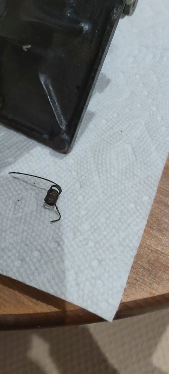

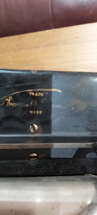

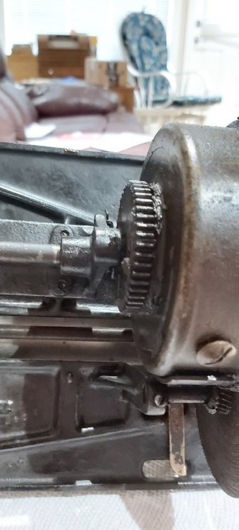

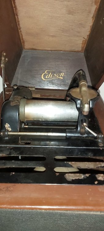

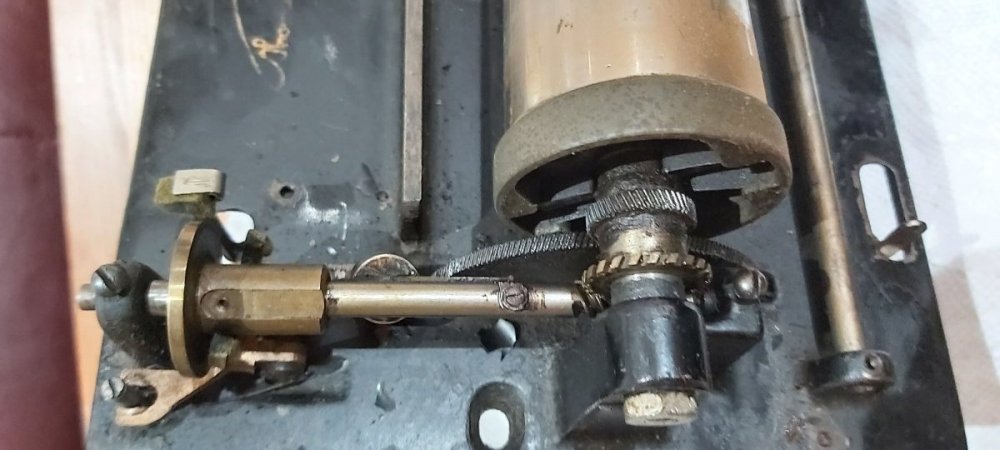

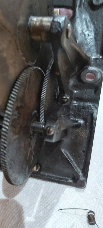

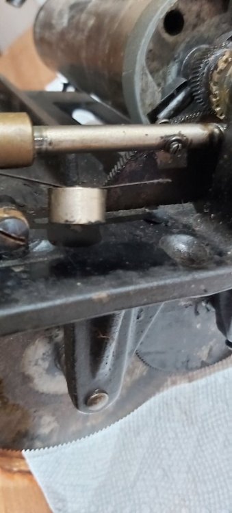

I believe I have an Edison Traditional but not sure. If anyone can help identify it
Also where does the little spring fit -35
In 307 I think it is almost a centrifugal weight but it is only connected on one end.
Are there any mechanical drawings online?

I think I have the Grafonola Victrola. I have seen an ad that says the model is "favorite"
I also see I need three centrifugal weights.

Hello Gordon,
Your machine is an Edison Amberola 30.  (The Grafonola was a disc machine made by a different company, as was the Victrola. )
The Amberola 30 was introduced in 1915, and yours was built during the first two years of manufacture.  The Amberola 30 will play 4 minute cylinder records made of celluloid ONLY.  Fortunately, these are commonly found as Edison Blue Amberol Records (note that "Amberola" refers to the machine, and "Amberol" refers to the record), 4 minute Indestructibles and 4 minute Everlastings.  Here's an article that will help you recognize them:

You need governor weights and governor springs (there are 2 on the Amberola 30).  I'd suggest calling Ron Sitko about these, as well as any other parts you may need:

If you are in doubt about your mechanical ability, or if you don't have proper tools (a set of good quality small screwdrivers is a must), don't hesitate to send your entire mechanism (don't send the cabinet - just the mechanism) to one of these repairmen, and they will return it to you ready to go.

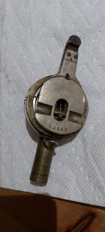

Your reproducer is an Edison Diamond C, and you should not attempt to disassemble this unless you are familiar with these devices.  Let an expert do it and it can actually save you money.
