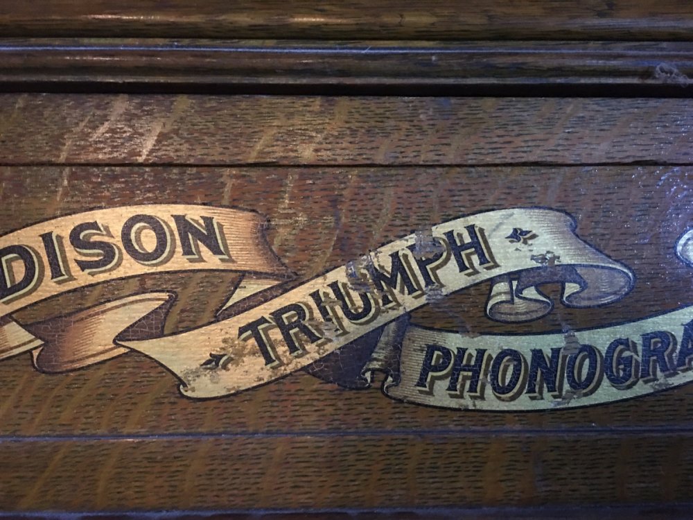

I have an Edison Triumph with an already worn decal, and I would like to use Howard's Restor-a-Finish on the case, but I'd like to know if this might damage the decal. Can anyone give me any advice? Thanks.

I have never used Howard's Restore-a-finish, but I did a quick online search.  The company describes its product as having "...just the right amount of solvent..."  It sounds like the product might re-amalgamate the finish, which could destroy a decal unprotected by an intact finish coat.
Post a picture of your decal and perhaps there is a better approach for your Triumph.
I can tell you that if you follow the instructions and use steel wool, it will flake the decal. Even using a rag alone will still cause loose decal bits to come off on the rag. In my experience it has never dissolved a finish but will definitely even out the color. I like their products but decals and even some painted metal name plates, like on a Pathe, can be damaged by their product.
Here is a picture of the decal.
So it sounds like I should not even try a gentle wiping of restor-a-finish with a rag?
John
On 3/6/2021 at 5:59 PM, johnsky said:
...So it sounds like I should not even try a gentle wiping of restor-a-finish with a rag?
John
You can expect some minor loss, yes. I have never seen it take one off completely
Gee just go around the decal! Simple solution I have used often. Love the product.
THANK YOU phonogfp, Mainspring, Auxetophone, and Neilvanstem all for the advice and information! Much appreciated. The case is actually not in bad shape, so I'll see, so I think I'll wait and consider my options. I have a few machines (and a paneled oak horn) that I've never cleaned up, so this is all good info for me.

Or for another option, use the "Skidmores' Beeswax polish and or the Restoration cream. Neither have any petro chemicals {which I THINK the Renaissance wax has in it} To see how it works, look at my photos posted here, of its use on my Victrola. "Skid mores' is sold on Ebay
It's very difficult to clean over or around a decal and very few could tackle your banner decal with a satisfactory result.  Personally, I'd leave it as it is.  It's way better than average.
