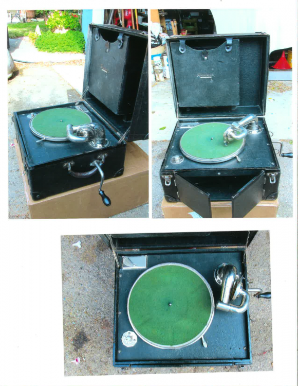

Who Can Identify This Brunswick?
The APS received an inquiry today regarding the model of this Brunswick.  What is it?
It's not shown in R.J. Wakeman's book (at least I didn't find it there).
Can anyone help?
I think it's the second variation of the 101, changed from the first design in 1923.  The first one had the one large drop down door and the swivel style tonearm on the opposite side reversed with the needle tin.  (I tried finding a period ad but couldn't find one.) I don't know when Brunswick changed the design in either 1924 or 1925, I thought the goose neck patent already expire for victor between 1922-1923.
