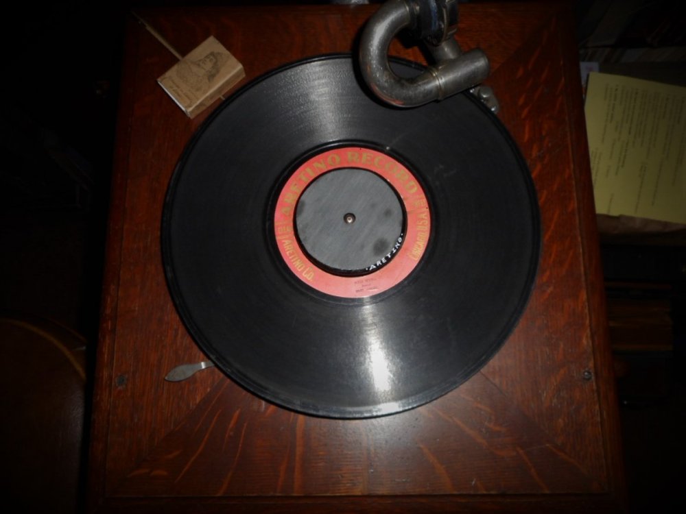

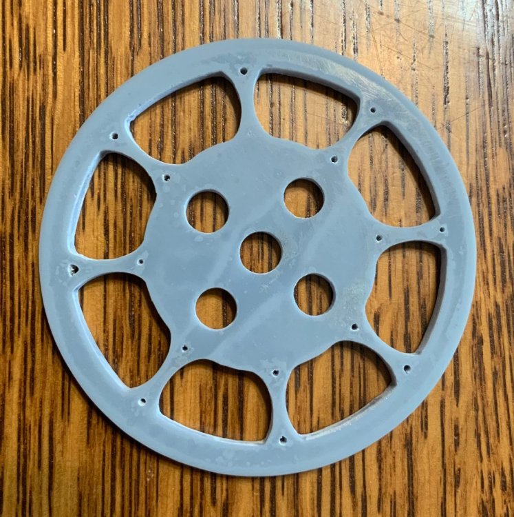

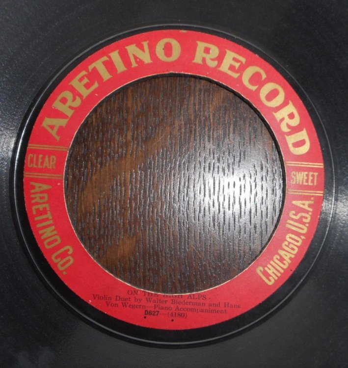

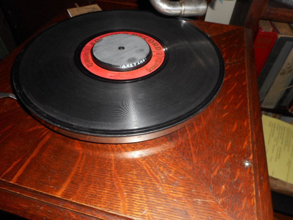

If you have any Aretino records with the 3" spindle hole you are familiar with the problem of playing them without an Aretino machine. There are plenty of simple solutions. I used to use the potters trick for centering clay on the wheel which worked but, it took some time. I recently purchased a 3D resin printer and started experimenting with 3D modeling software and came up with the adapter pictured below. Works a treat. There were 3 versions before this so a little R&D did go into. If anyone has a 3D printer, or know someone who does, I have made the .stl file available here. You will need to clean it up and file out the center spindle hole a little to get a perfect fit.

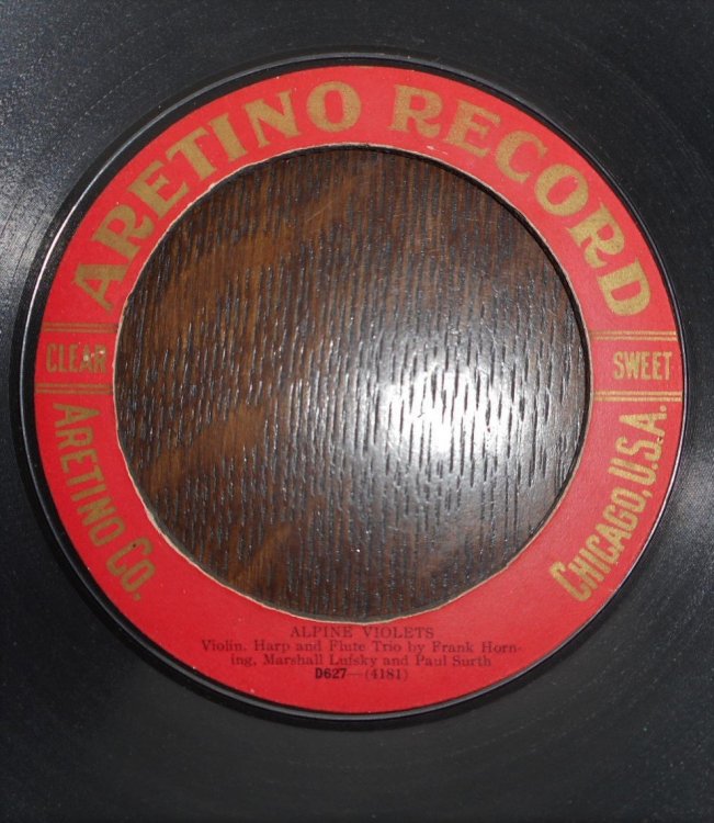

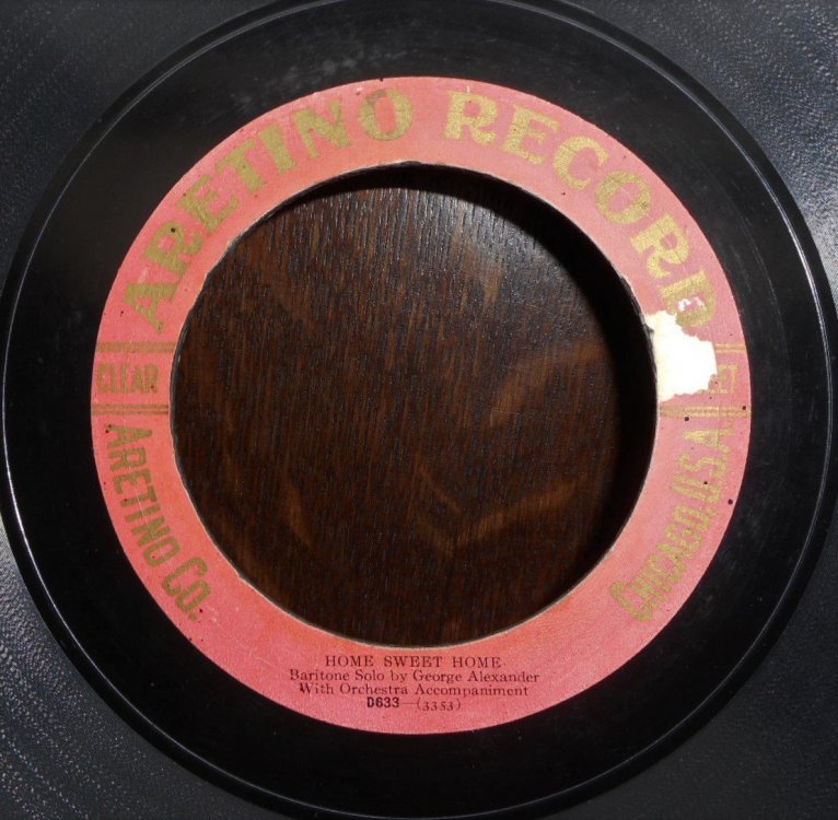

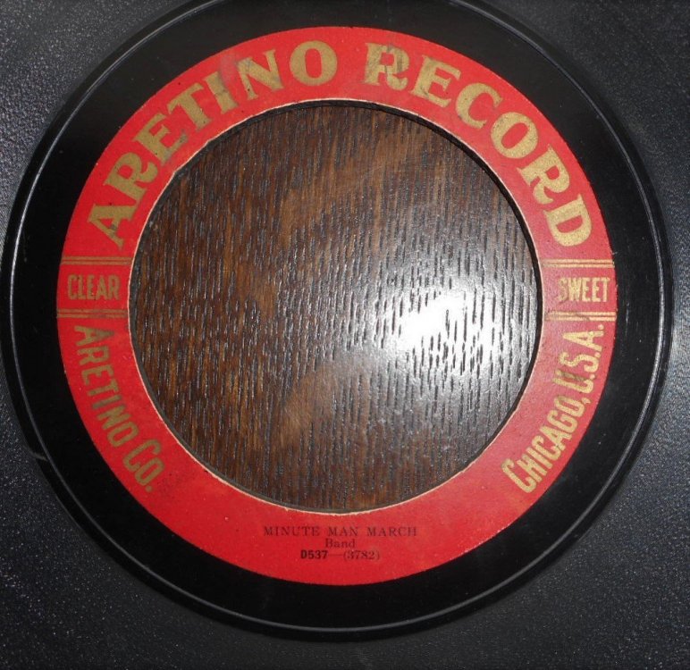

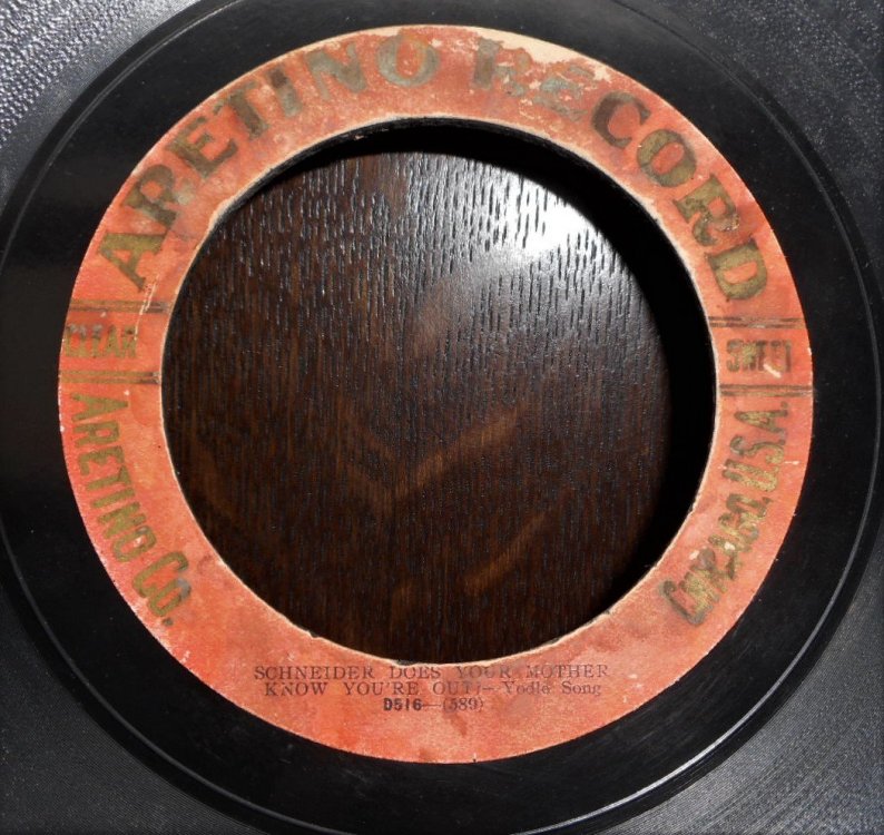

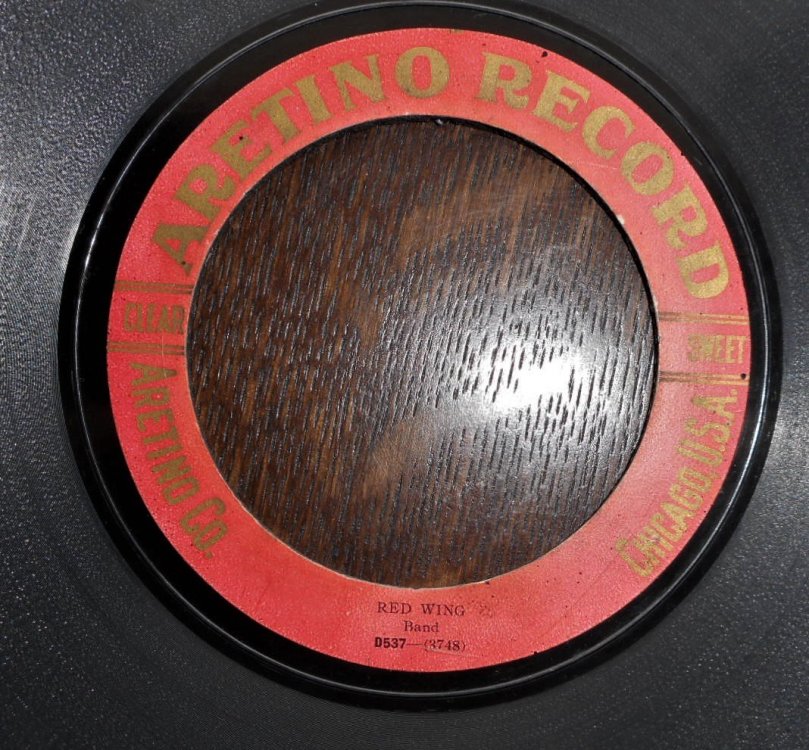

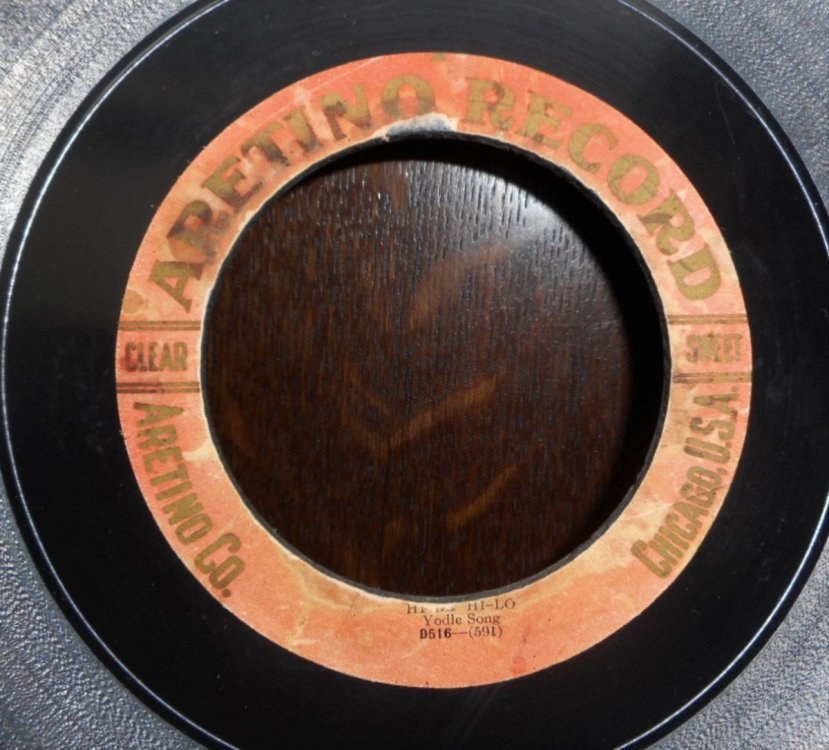

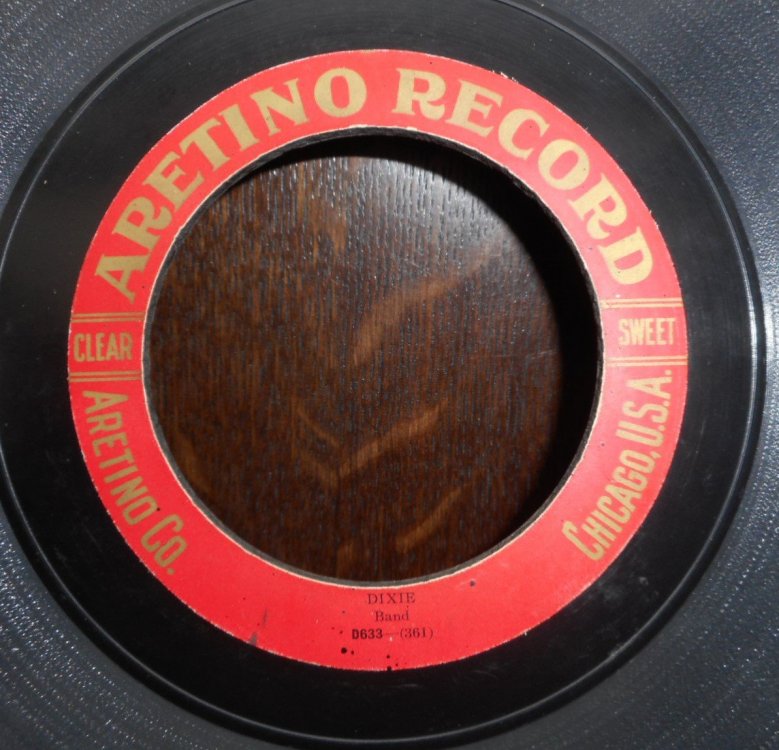

Since I do not have the ability to do that I bought adaptors and here is the one I use and my most recent records too. I bought these and some United. I have plenty of the Standards with larger hole.
