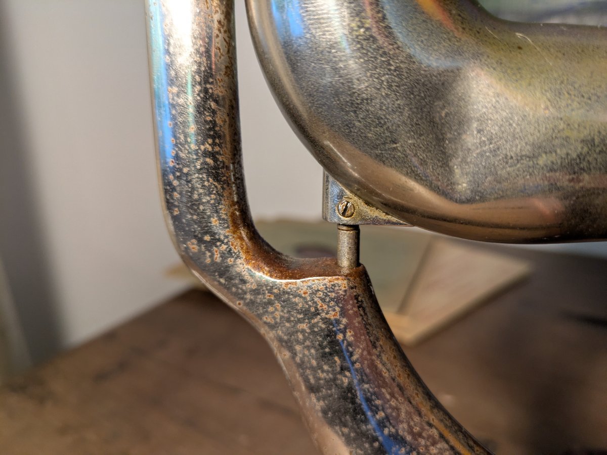

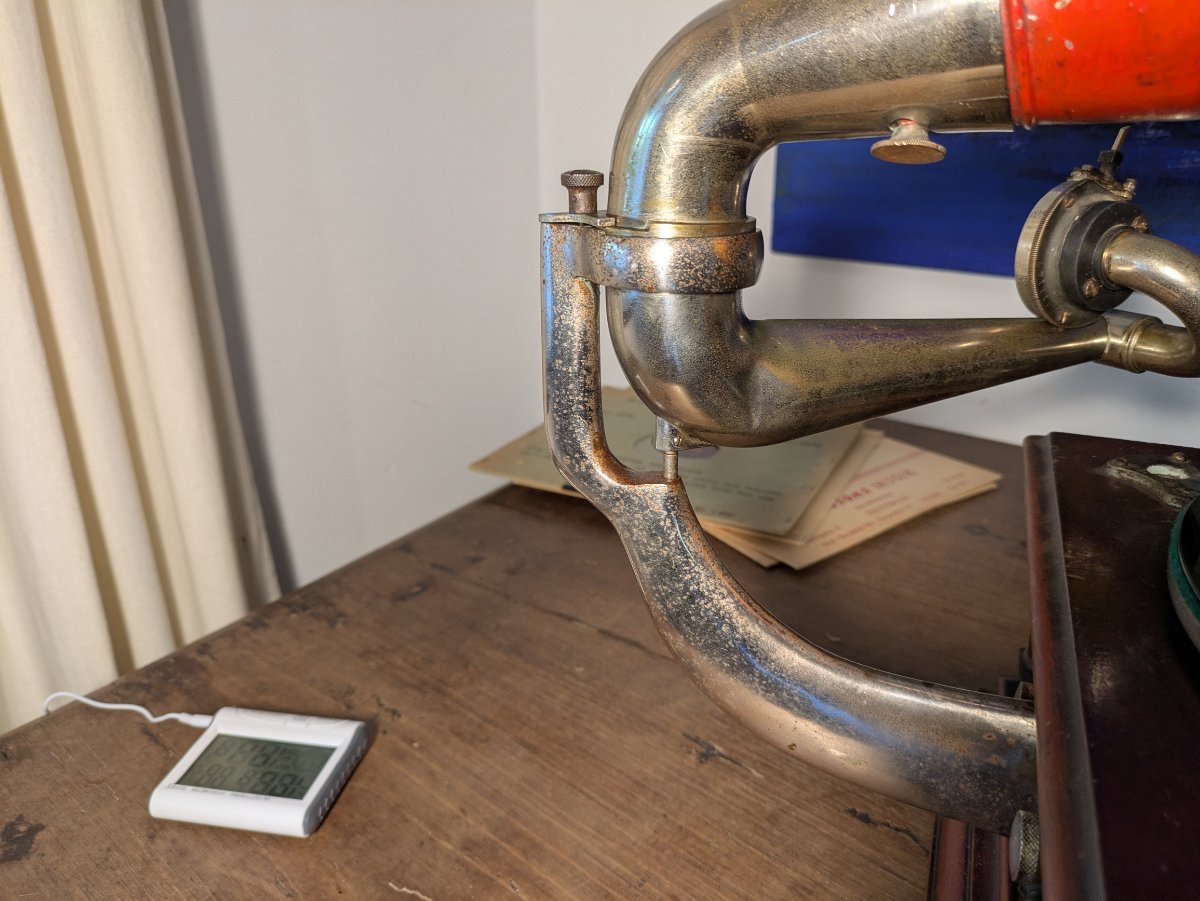

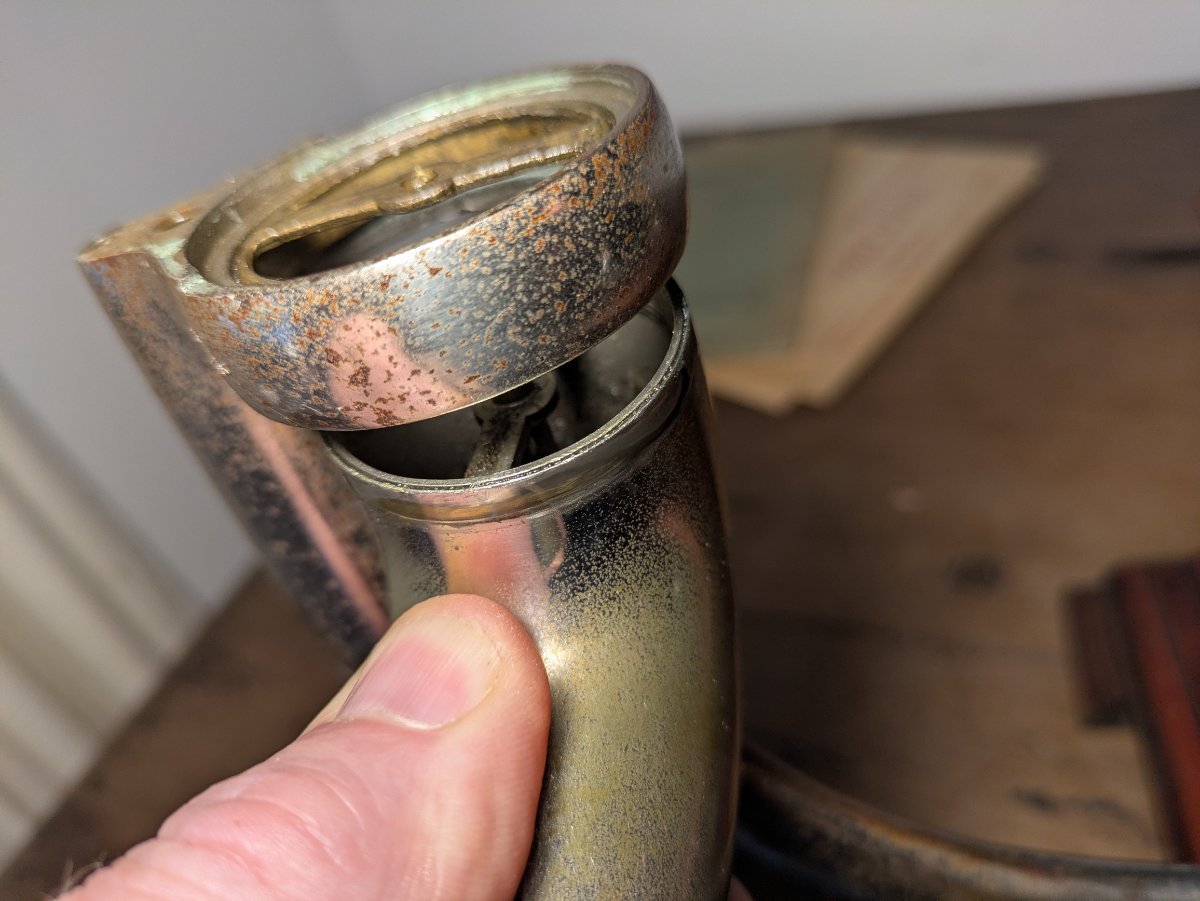

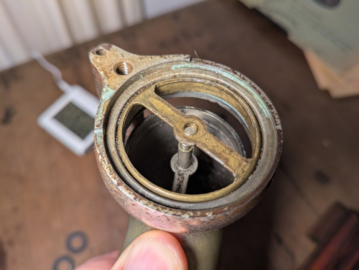

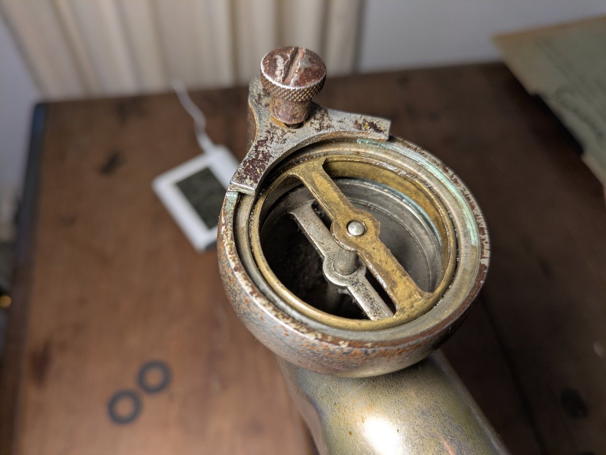

Hogan Posted October 25, 2025 Posted October 25, 2025 My problem is this arm won't move freely right to left and consequently starts skipping tracks. I wonder if anyone has any experience/advice? It appears to be undamaged. What I've tried so far is: cleaning and oiling everywhere (sewing machine oil). Moving it back and forth 500 times (true). I've lowered the arm a little bit so it doesn't press onto the ring at the top, unscrewing the little screw at the base. Nothing doing. It moves a little better when I remove the reproducer, the weight of it seems to add friction. See photos. There seems to be friction and wear at the part of the arm facing the turntable. I suppose the arrangement with the tap at the top and the bottom should eliminate this but doesn't? I'm really at a loss here...

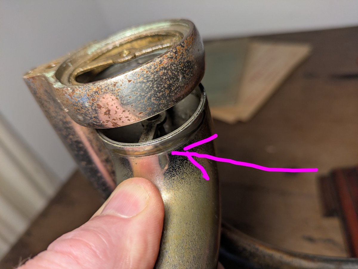

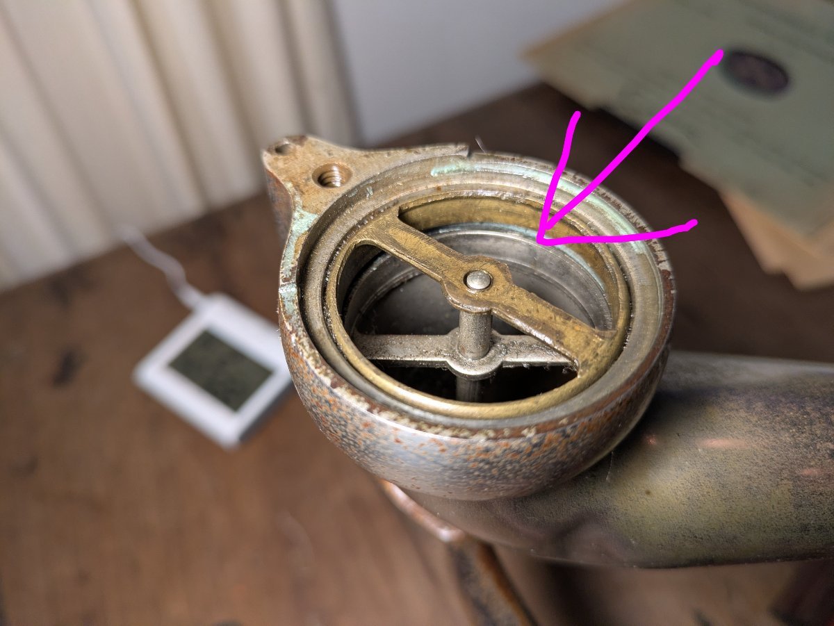

Jerry Posted October 30, 2025 Posted October 30, 2025 (edited) The last picture shows what your issue is. The hole in the cross bar is so worn, (or abused), that it allows the arm to droop and rub on the back bracket, in the area you have pointed out. If it's possible to remove the cross bar, rotate it 180 degrees, and reinstall it, it may alleviate your issue. Edited October 30, 2025 by Jerry
Hogan Posted October 31, 2025 Author Posted October 31, 2025 Thanks Jerry! That makes sense! There is definitely too much movement there, almost enough to try and fit a thin metal in on the right side. I've tried moving the cross bar using a good pair of pliers and force but it doesn't budge. Question is: should it? Or is it welded stuck (I see no indication of that) Maybe using some kind of chemical or freezing the whole thing would help loosen it up?
Jerry Posted November 2, 2025 Posted November 2, 2025 (edited) The cross bar piece is tightly pressed in place. It's not intended to be loose, so it's not a matter of its being stuck and needing to be freed up. In all honesty, it would be difficult to remove and press back into place if you're not accustomed to doing that sort of work. Edited November 2, 2025 by Jerry
Hogan Posted November 2, 2025 Author Posted November 2, 2025 I see, no I'm not sure I would be able to do that. Don't have the proper tools for it either (nor am I really sure which they would be). Perhaps another option would be to slightly bend the little rod that has too much play at present? A few small whacks in the direction of the turntable - or would I risk making things worse, could it brake off?
Henry Posted November 2, 2025 Posted November 2, 2025 (edited) You need to bush the hole. Problem is, the dimension needed to fill is likely vanishingly small. Measure the diameter of the pin, fashion a bushing out of brass tubing (hobby shop) or small hollow brass rivet (hardware store) with appropriate inner diameter to fit snugly (but not binding, of course) over the pin. To install the bushing, it will be necessary to enlarge the hole in the cross piece. If you work carefully, you can make it a press fit (or “fudge it” with super glue). HTH Edited November 2, 2025 by Henry

Hogan Posted February 27 Author Posted February 27 So, I'm back in Spain - and here's the gramophone after Pedro fixed it, he did a really good job! A bronze ring now supports the arm and it swivels freely! Here it is playing a 50-ies Eartha Kitt, it's fitted with a Decca telematic soundbox since I play a lot of electrically recorded records and that soundbox performs really well even bass-wise. Lately I started making my own bamboo needles, using black bamboo which I find works a lot better than the other kind, it grows here on the farm! PXL_20260227_113156318.TS~3.mp4 1
