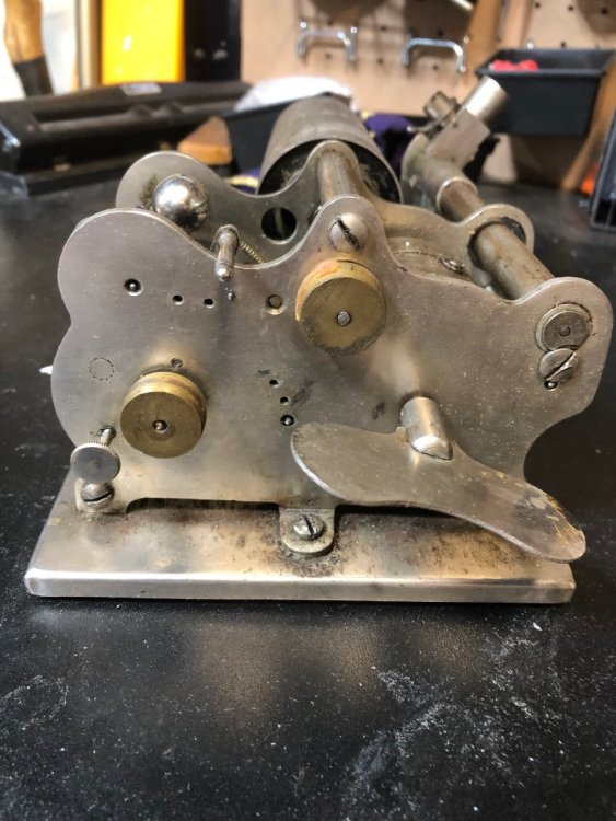

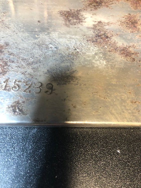

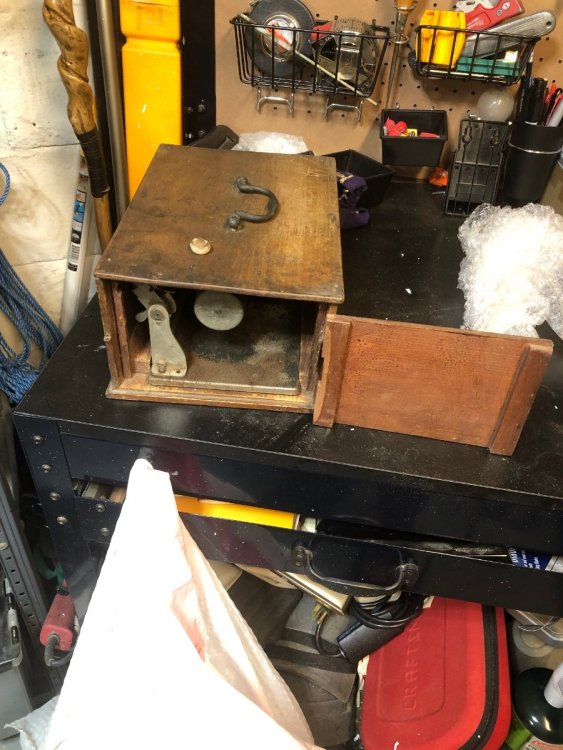

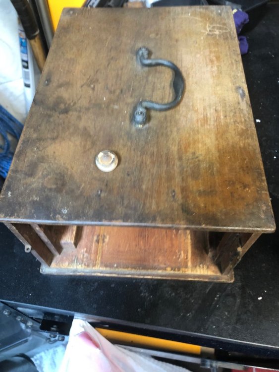

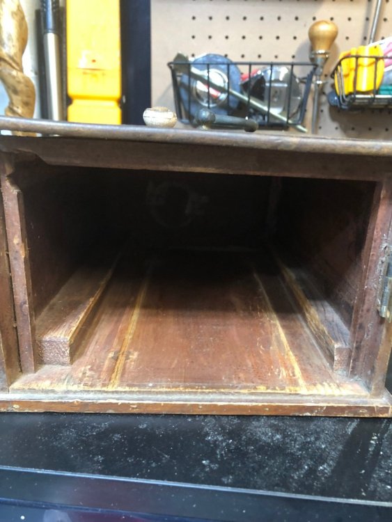

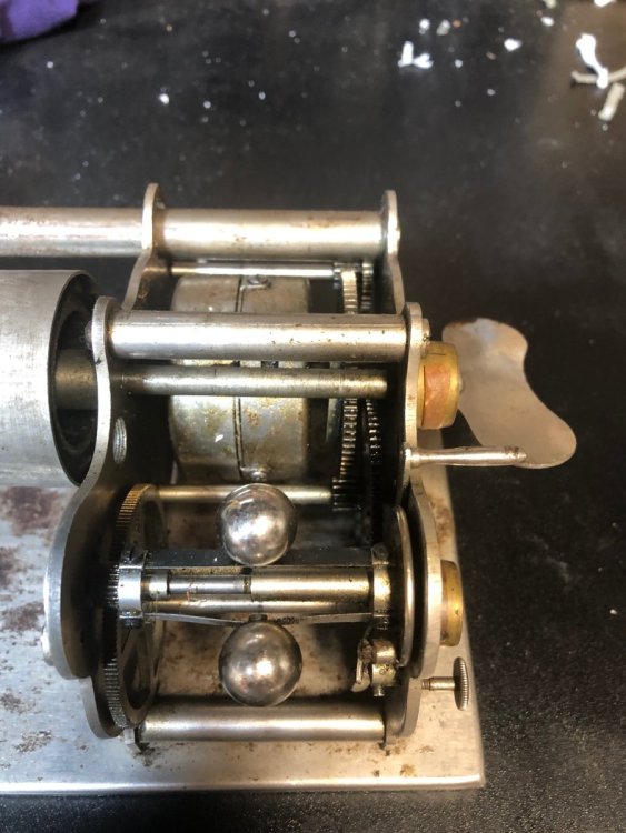

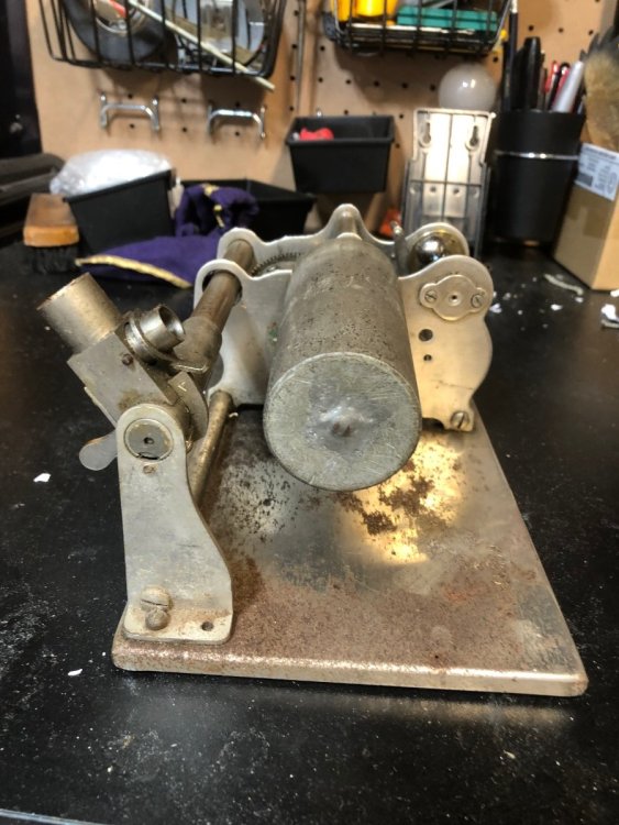

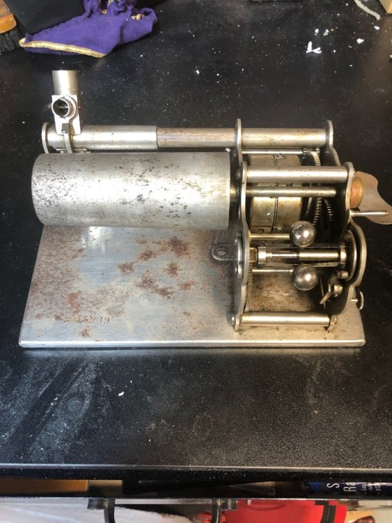

Dan Posted August 25, 2024 Posted August 25, 2024 I bought this from someone in England it looks like a Columbia eagle except for the base. There is a 5 digit number on the base plate , it os on the opposite side of the governor. Any info would be greatly appreciated? It came with a slide in wood case , the case looks homemade??? see pictures Thanks Dan ps- I posted this in the acoustic machine forum and was told try this forum .
CurtA Posted August 26, 2024 Posted August 26, 2024 There were several Type B knock offs made in France or Germany - this is probably one of those. The case is interesting/unusual... What do you plan to do with it?
Dan Posted August 26, 2024 Author Posted August 26, 2024 I’m going to clean and repair the case , clean up and get the machine working. It’s pretty complete need a reproducer ( what type?)and cover for belt if it had one. I need to do more research on the machine before I start looking for parts . Maybe after a cleaning I’ll see more markings beside the serial # Dan

Dan Posted September 9, 2024 Author Posted September 9, 2024 On 8/30/2024 at 7:38 PM, Dan said: Thanks for the pictures , that looks just like it , are the reproducer and horn , parts that are available or impossible to find. Thanks for the help. Dan This machine turned out to be a Pathe Aiglon Thanks all

Jerry Posted September 11, 2024 Posted September 11, 2024 Dan, What differentiates this as a Pathe, versus a Styx? The Styx example shown appears identical to yours.
Dan Posted September 11, 2024 Author Posted September 11, 2024 I reached out to Julien Anton a collector in France he sent me the following: Good morning Dan, As I told you in my previous message, your phonograph is not a Styx, but a Pathé, it is the Aiglon model. To convince yourself, you can consult my originals catalogs on my site (you can enlarge the pages). You will see the mechanism of your phonograph on this page of the Pathé catalog for the English market dated 1903 : https://www.phonorama.fr/kp57.html In the first pages, we see the mechanism. The base has rounded edges, the plate was stamped, which gives it this particular shape. This model was sold without a wooden case, buyers were able to build their own custom box, like that of your phonograph. Styx phonographs looks like the Pathé, they bear the Styx brand in an oval: The base does not have rounded edges like on the Aiglon, the plate was cut with right-angled edges. You will see Styx phonographs in this catalog: https://www.phonorama.fr/kf04.html The Pathé Aiglon is a fairly common phonograph, easy to find in France or Great Britain. The reproducer and the horn that would be needed for L'aiglon are listed at the end of the Pathé catalog.
