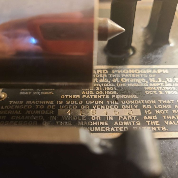

A. I have the serial number 419460, is this a 1905 model?

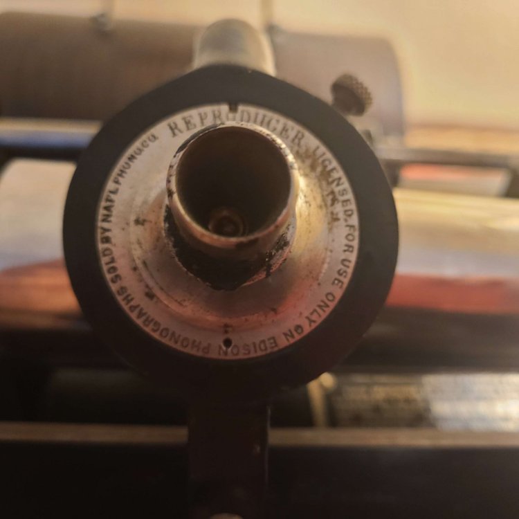

Thanks for the welcome and answer. Almost certain it's a 2 minute one but the reproducer did not have a discernable letter from what I can tell. The machine was demonstrated as running on eBay and I have no reason to doubt it.20240427_192611.thumb.jpg.fc984fc3ea5c346b99742e1e7a2c2fb8.jpg
Edited by Koraxtheghoul
You're correct, it appears to be 2min only.  So, you can play 2min black wax or 2min celluloid "indestructible" period cylinders.  Black wax are more delicate and can be broken easily by dropping them or pushing them onto the mandrel too hard.  They are tapered inside, so only go on in one direction.  The Indestructible cylinders typically cost more, but are more durable.  They have a celluloid surface and a metal ring inside for support - use them if you don't want to worry about breakage.  They come in 2 and 4min versions - the latter are stamped 4M near the title.  Another good source is Vulcan ( https://www.vulcanrecords.com ) and Phono Works Germany ( https://www.phonoworks.com ) who both make excellent unbreakable new cylinders with period titles in 2 min format.   There are several other independent cylinder makers who make resin duplicate cylinders.  Hope this helps.

According to original Edison sales data, Standard #419460 left the factory in February 1907.
A detailed illustrated article on all models (A - G) of the Edison Standard Phonograph appeared in the December 2023 issue of the APS magazine.  A concise guide to Edison Standards is in the Table of Contents linked above.

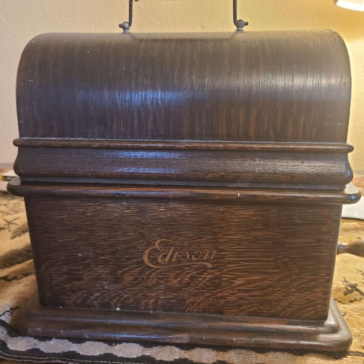

Thank you so much. Appears to be a standard B then from the last year before the 5 minutes came out.  I'm going to call a shop about the horn tomorrow and might ask about the recorder I'd need as well. Some of the listings on eBay are seriously overpriced (more expensive than my machine!).
Yes, it's a Standard Model B.

Your machine left the factory in February of 1907 according to a wonderful guide that appeared in the December 2023 issue of "The Antique Phonograph" that includes tons of information on the Edison Standard. You can get to the article from the Antique Phonograph Society home page, just log in and click on eJournal under "Member Resources". The article begins on page 26 and covers every version of the standard.  There is a similar article and guid on the Edison Home phonograph in the most recent issue of the magazine. (June 2024) It also includes a guide that makes it possible to see when a machine left the factory, using the serial number.
