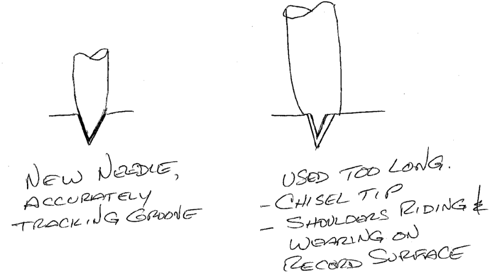

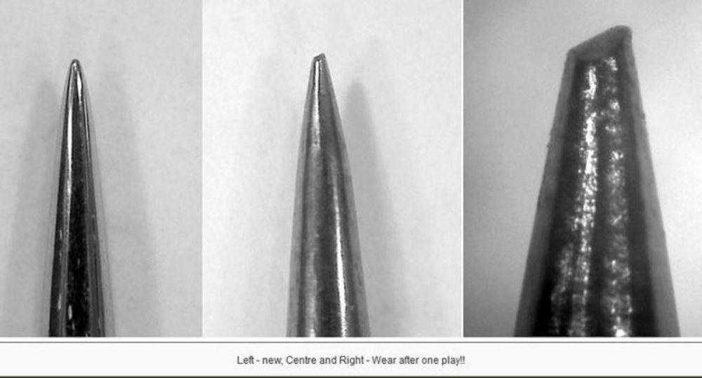

You change every time in order to preserve your records, and in the meanwhile, enjoy undistorted sound.
The records are made of shellac with an abrasive added to the mix. Why the abrasive? It grinds down the needle tip slightly in order to "adjust" its shape to better fit the record groove. The problem is, the record does not know when to stop wearing down the needle. Soon, like after 1 play, the needle tip becomes too distorted to accurately track the groove and begins to wear upon the groove itself. Have you ever noticed how "muddy" the music sounds if you use the needle too long? It's because it no longer fits closely enough in the groove to accurately track it.
Edited by Jerry
Clever people have discovered that turning the needle 90 degrees will improve the quality of sound once the needle has worn too far. Resist the urge to rotate the needle! Yes, it will improve the sound quality a bit, but it will also destroy records. DON'T BE A NEEDLE TURNER! 😉
