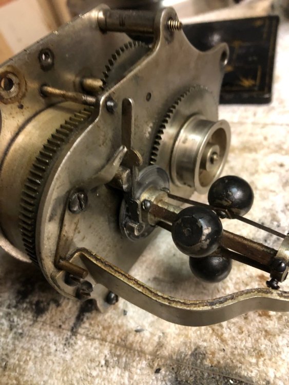

Dan Posted October 15, 2023 Author Posted October 15, 2023 Thank you all for the advice. I acquired ot a few days after the Wayne show wish I had before I went. Can someone please tell me what’s missing / wrong with the speed regulator in the picture . I think a spring is missing or something to keep the arm following the screw and the lever looks like it doesn’t do anything maybe positioned wrong. Any help would be great appreciated . I can’t find any clear pictures online. Thanks Dan

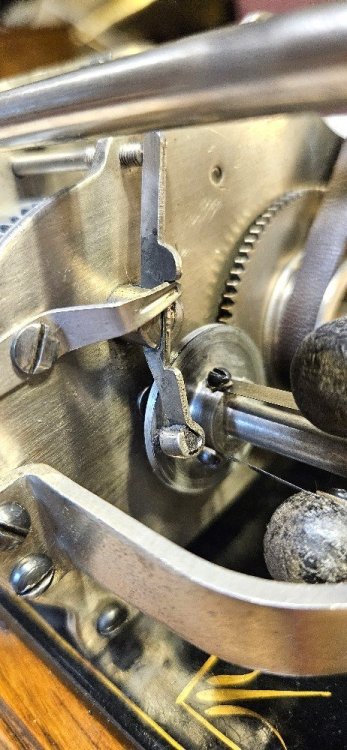

Dan Posted October 15, 2023 Author Posted October 15, 2023 10 hours ago, Dan said: Thank you all for the advice. I acquired ot a few days after the Wayne show wish I had before I went. Can someone please tell me what’s missing / wrong with the speed regulator in the picture . I think a spring is missing or something to keep the arm following the screw and the lever looks like it doesn’t do anything maybe positioned wrong. Any help would be great appreciated . I can’t find any clear pictures online. Thanks Dan I found a clear picture it looks like the lever isn’t right, in the picture I found it looks like it should fit in the notch on the speed reg arm ( sorry for the nomenclature not sure of parts names) that has the felt pad that rubs on governor plate. Again any info is appreciated. Dan
AudioAntique Posted October 15, 2023 Posted October 15, 2023 Dan, It appears that the "on-off" lever is positioned incorrectly. The side opposite the handle should ride on the top edge of the friction pad arm so that when moved up and down, the friction pad arm will move on and off the governor disc. The knurled speed adjusting screw can then be adjusted for the proper speed. (From the looks of the screw the pivots the lever arm, it appears it has been worked on before.) Rob
Dan Posted October 15, 2023 Author Posted October 15, 2023 3 hours ago, AudioAntique said: Dan, It appears that the "on-off" lever is positioned incorrectly. The side opposite the handle should ride on the top edge of the friction pad arm so that when moved up and down, the friction pad arm will move on and off the governor disc. The knurled speed adjusting screw can then be adjusted for the proper speed. (From the looks of the screw the pivots the lever arm, it appears it has been worked on before.) Rob Yes thank you I found a picture and moved the lever it working now . Thanks for help Dan
