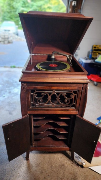

I am completely new to these so please be kind. Haha.
I aquired this Milwaukee Talking Machine today with some minor issues (everything seems to be running properly, EXCEPT it skips when playing).

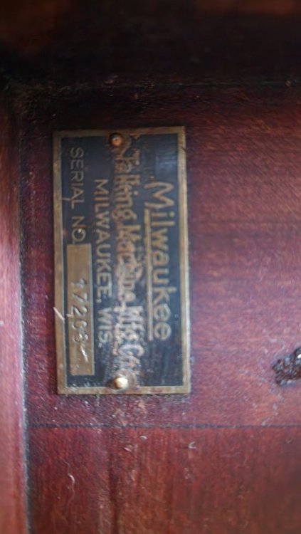

I was hoping to locate an owners manual online or any information to troubleshoot this problem, but it's proving to be trickier than I imagined! While a serial number is included, I can't seem to find anything! I have found some old advertisements for Dalions and Resonas and that's pretty much it! No pics match it!

Welcome to this great hobby!  Looks like you bought a very fine phonograph.  From the look of your reproducer (that's the round thing that you put the needle into) it looks like you have a dual model that can play vertical (requires a sapphire or diamond stylus) and lateral (requires a steel needle, good for just one play) records.  Vertical records include Pathe and Edison, Lateral records include Victor and Columbia).  You twist the reproducer to get the different types. Instead of writing a whole article here, I will let you Google some of this stuff to get more answers.  As for your skipping problem, maybe your tonearm is potmetal and has frozen tight, or maybe you are playing a lateral record with the reproducer on the vertical setting?

I believe your machine is a Dalion that's lost its' decal from being stripped and stained. Sadly, there's no serial number records surviving for these smaller brands to really narrow anything down. Based on advertising, a good estimate for yours is around 1919-1922. By late 1921, the Milwaukee Talking Machine Co. started making chair backs, likely in response to the pending phonograph recession. I couldn't find a model that matched yours identically, but some very close. (For these smaller brands there's often inconsistencies.)
Finding a manual specific to this brand is going to be hard. Many of these smaller companies outsourced the mechanical parts to a third party, making them in mass for any business assembling their own phonograph. I kid not, you'll find hundreds of phonograph brands that used the same tonearms and motors. It's this reason, I don't think the tonearm on yours is original. It's from a Pathe', and they had their own tonearm designed and patented for their own machines. (Pathe' did have cabinets made in some Wisconsin factories, but it's doubtful its original.) Yours likely came with a supplier tonearm that broke over time from a poor metal composite, (Pot Metal.) and someone replaced it with what they could find.
In regard to it skipping: The tone arm might be too long/short and needs to be adjusted to lineup the tracking. (The reproducer may also be out of alignment.) I'd suggest playing around with it to try and improve the tracking, by lining up the needle with the spindle. I also recommend the beginners section:(https://www.antiquephono.org/#/collectiondetails/16) Hopes this helps!

Here is a demonstration on how to play a phonograph with the Pathe reproducer, which you may have.  One thing he doesn't mention is that I think he has already put a steel needle in the reproducer, since that's what you need to play a lateral Victor record.

Two areas to check that might cause skipping... both of these joints need to move/rotate freely.
Use some good quality fine oil on them.Screenshot2023-09-08at2_40_32PM.png.23a1273563bf28a2e03c79623014ab7c.png
