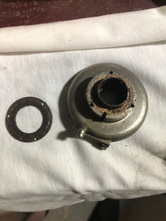

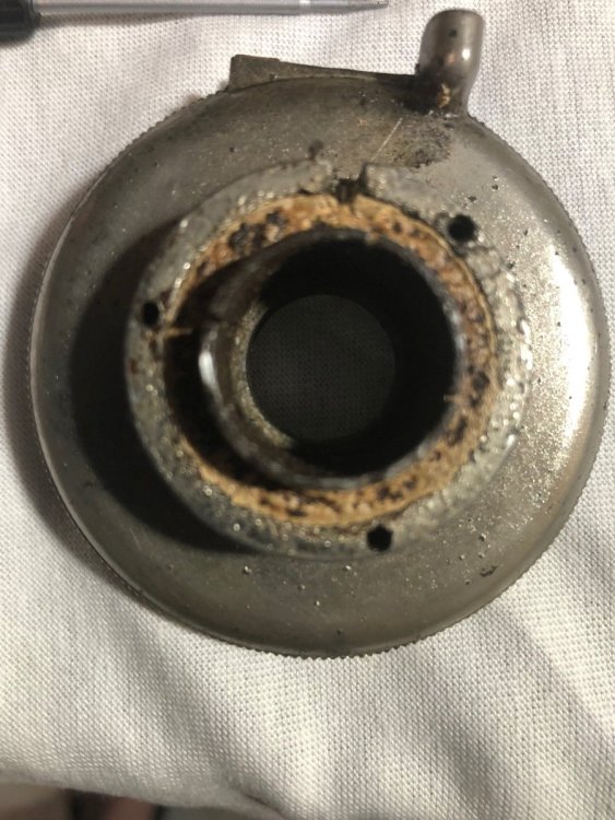

Good evening all I bought this reproducer to practice taking one apart and restoring it. I watched a few video read some articles etc. Everything went well, I took the ring off back and this whitish hard paste (???? )is packed around a ring/tube. Does anyone know what it is and what it is for ? See pics Thanks

Not familiar with the brand of this reproducer,  but I would figure that this was (originally) a white rubber insulator to cushion between the reproducer and the tone arm yoke. I doubt there are reproductions made for this model. You may be best suited to replace it using a short piece of soft rubber tubing of the appropriate inside and outside diameter.

Thank you for the information,  there is no name or markings anywhere on it, upon further investigation I see a pin from the rusty tube/ring is inside a small cutout and looks like the hard white paste(??) might be holding that ring/tube in space . The white stuff is pretty hard. Everything else is cleaning up nice though.
Yes, that makes sense. Similar to how the insulator ring is in a Victor No. 2 or Orthophonic reproducer. That pin on the inside of the ring of course is for correctly angling the reproducer on the tonearm and locking it into position.
