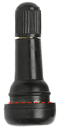

To play Hit Of The Week records, use a tire valve as a record hold down.  Obtain a Schrader valve from your local tire store (usually free) and cut off the large end as shown.  This makes a perfect hold down to keep the records from spinning...
