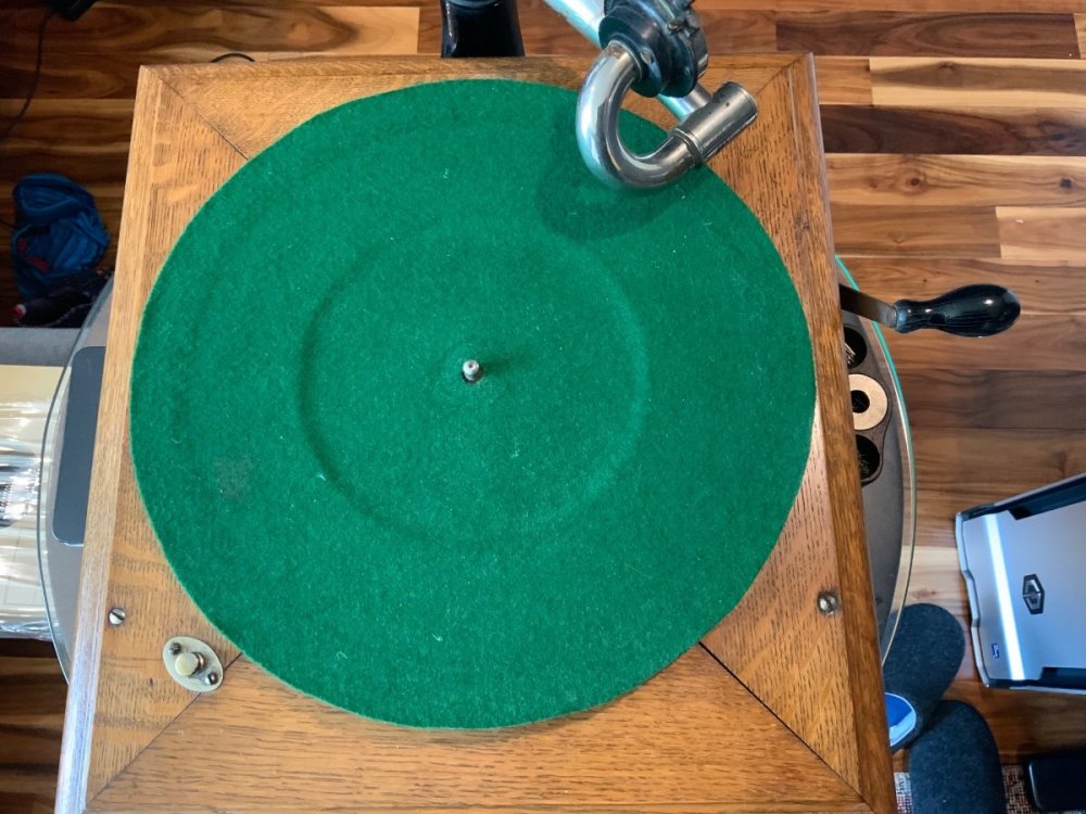

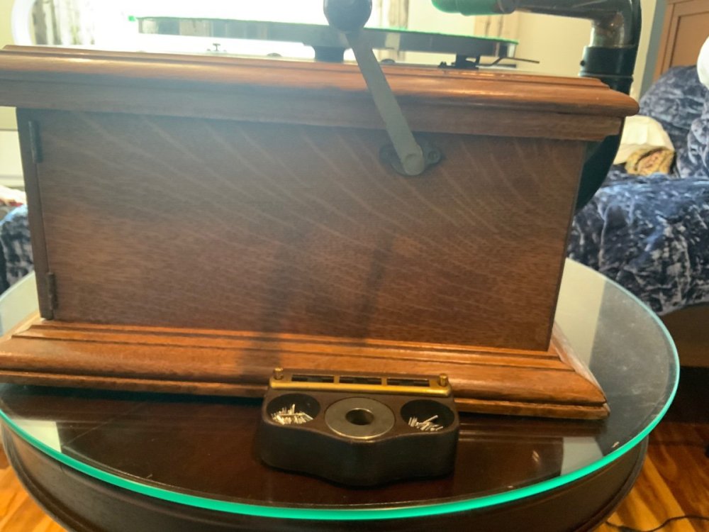

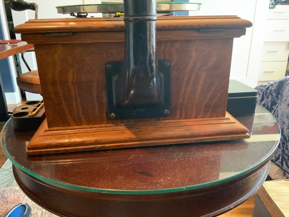

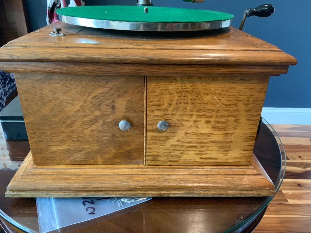

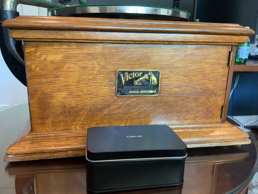

How to disassemble this VV-VI and maybe some tips for greasing the main spring
I’m new and need to grease the main spring (I’ve never done it) and don’t wan’t to damage the phonograph
I also don’t know what grease to use (there isn’t a manual, at least I don’t think so)
