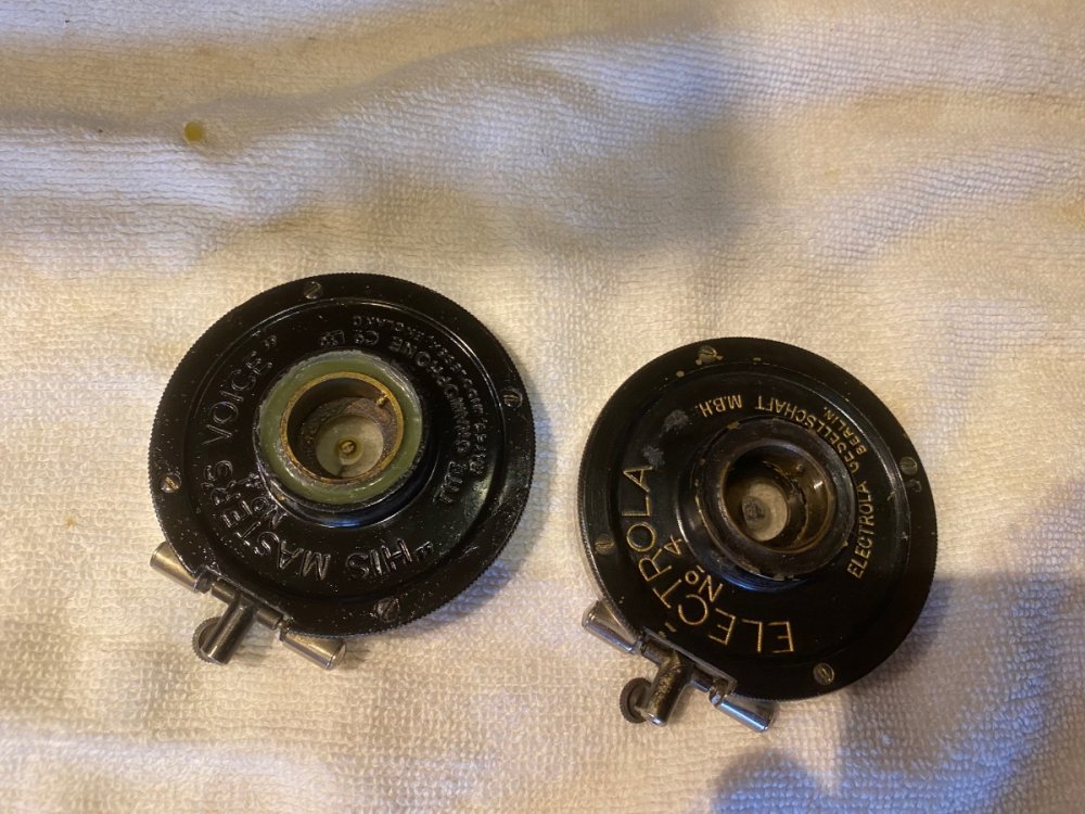

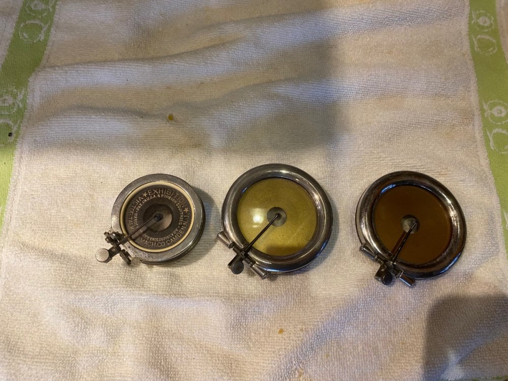

I don't know if you can get much better than  a Victrola no. 4 if you want to play late 20s, even early thirties discs on an early 20s or earlier acoustic Victor machine.  The numbers 5 and 6 fix to a larger diameter elbow so they would not fit.  Pictured below are the H.M.V. (British) and Electrola (German) No 4.  They are exactly the same as the Victgrola no. 4 except marking.  Also pictured is an Exhibition for comparison. CFCE5820-7C5A-426F-94A9-E628B52171E5.jpeg
