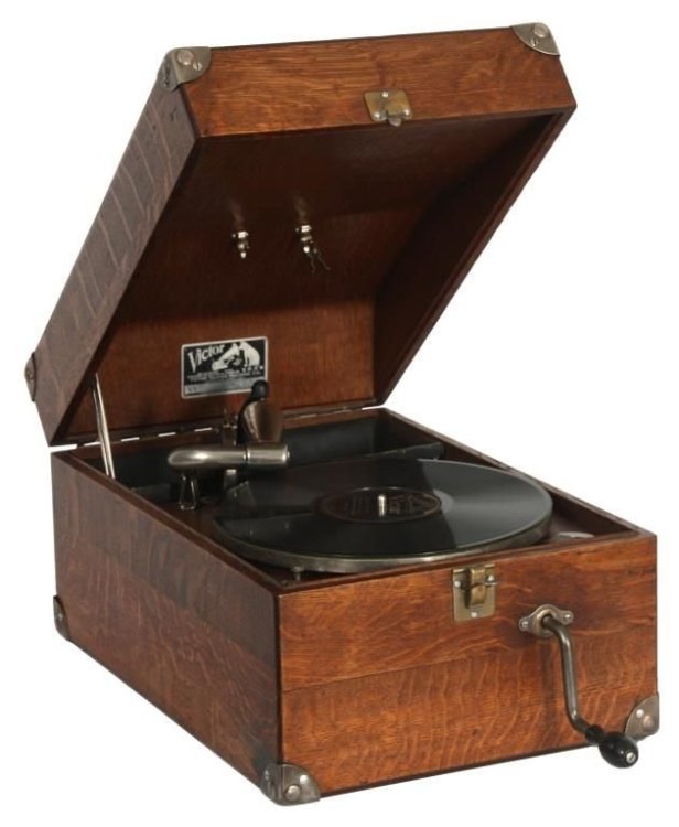

Another reasonably priced Victrola is the VV-50, which is a robust portable type enclosed in an attractive wooden case.  There are several variations of it in either oak or mahogany.  I like them because they are easily transportable and play like a full size machine.
