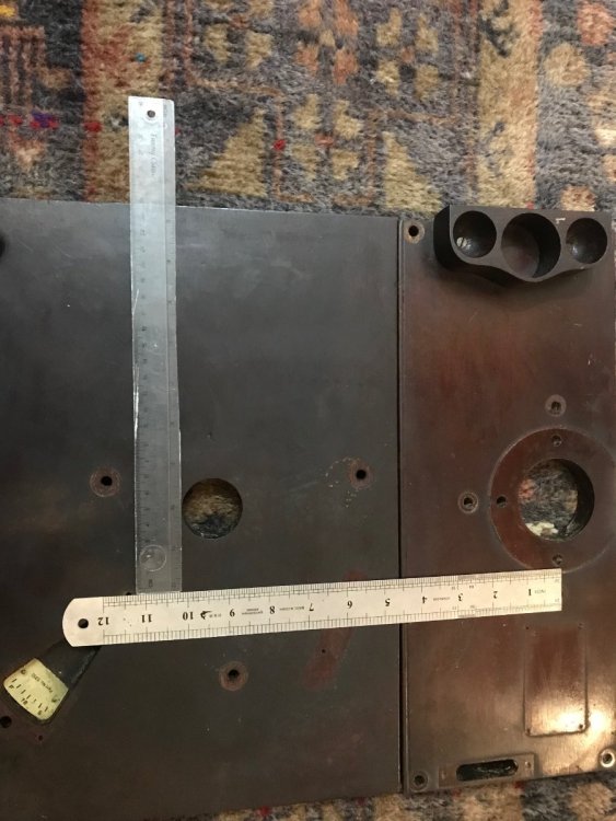

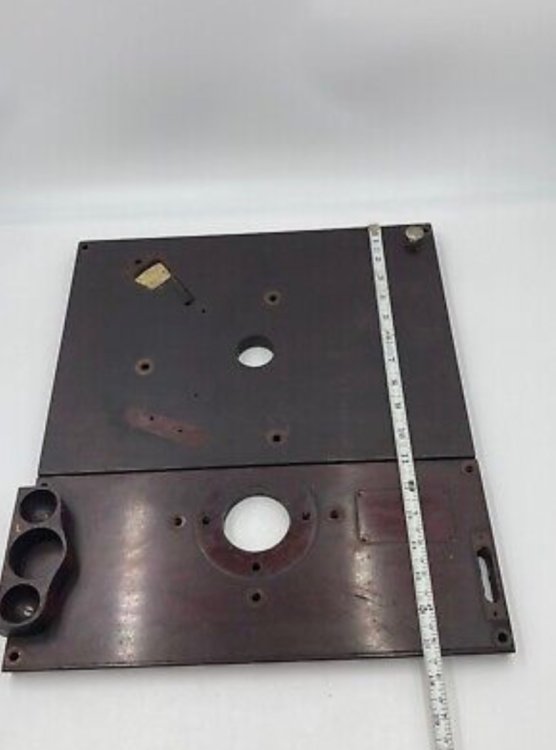

Sheraz Posted November 25, 2022 Posted November 25, 2022 Will you please suggest which type of Victrola tonearm and reproducer should I buy for this machine?. Please also suggest the appropriate Victrola plate indicating the model number for this machine which should I buy for this phonograph. The pictures of the motor board and motor are here so you could suggest. Please note that the brake I have is the shorter arm type.? Thanks and regards Sheraz
Sheraz Posted November 26, 2022 Author Posted November 26, 2022 Hello ! I do not have the Cabinet . Just the motor and board with all top stuff except tone arm. Please advise. Thanks

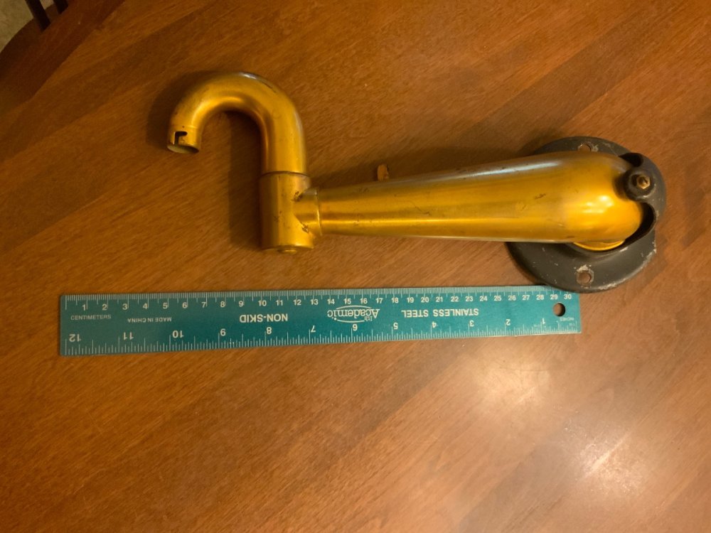

mattrx Posted December 16, 2022 Posted December 16, 2022 Do you know if the arm should be acoustic orthophonic or pre-orthophonic. I have a box full of both and may be able to help. The serial number/model number of the machine would be a great help. Measure the center of the tone arm bracket hole to the center of the turntable hole and post it. I will try to compare this information with the tone arms that I have. Maybe that will help you. Matt
Sheraz Posted December 16, 2022 Author Posted December 16, 2022 It is pre-orthophonic. Here is the picture with measurements. Please advise. Thanks and regards sheraz

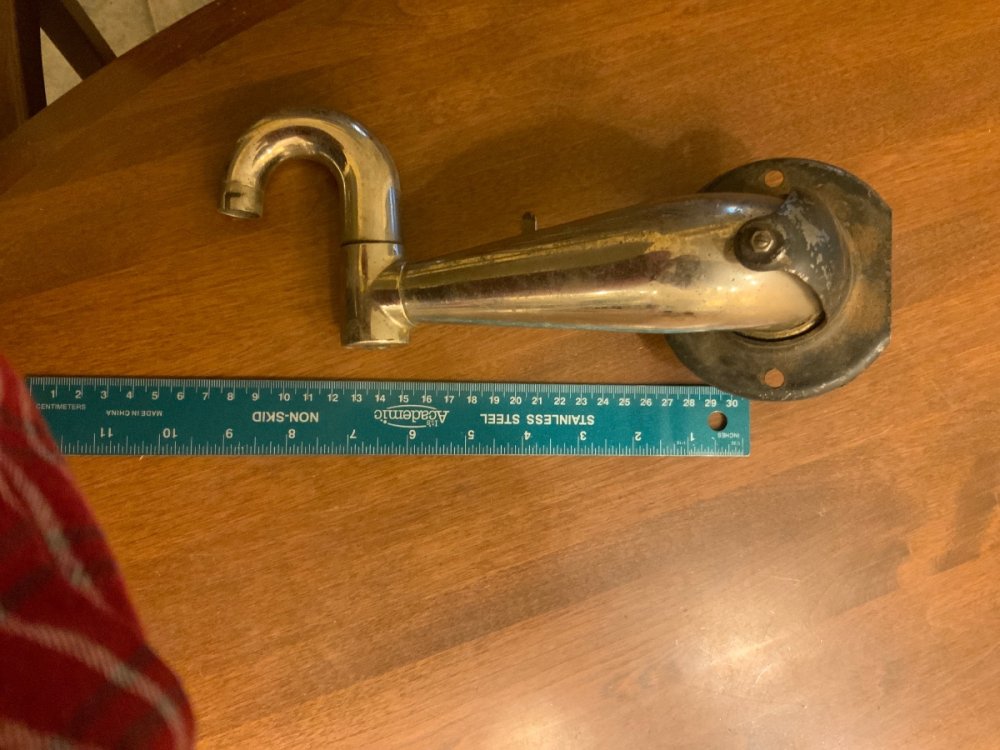

mattrx Posted December 16, 2022 Posted December 16, 2022 Maybe this one? The motor board looks 20’s to me, I could be wrong. Victor was using this “fat” tone arms then. I probable have the same arm in nickel. Matt

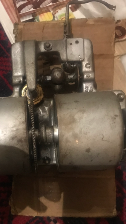

Sheraz Posted December 17, 2022 Author Posted December 17, 2022 I trust the board with me and all parts on it belongs to a Victrola 260. However it has a four spring motor. It has a short arm brake. Probably this means it will have a long tone arm. Now you can make a better idea of what I need. Thanks and regards Sheraz
mattrx Posted December 18, 2022 Posted December 18, 2022 Pics online of a VV-260 show an arm similar to the nickel finish arm I posted. With the reproducer installed, the needle should strike the center of the spindle hole. Take a look at the measurements I have posted and compare to your motor board. Good luck with your restoration! Matt
