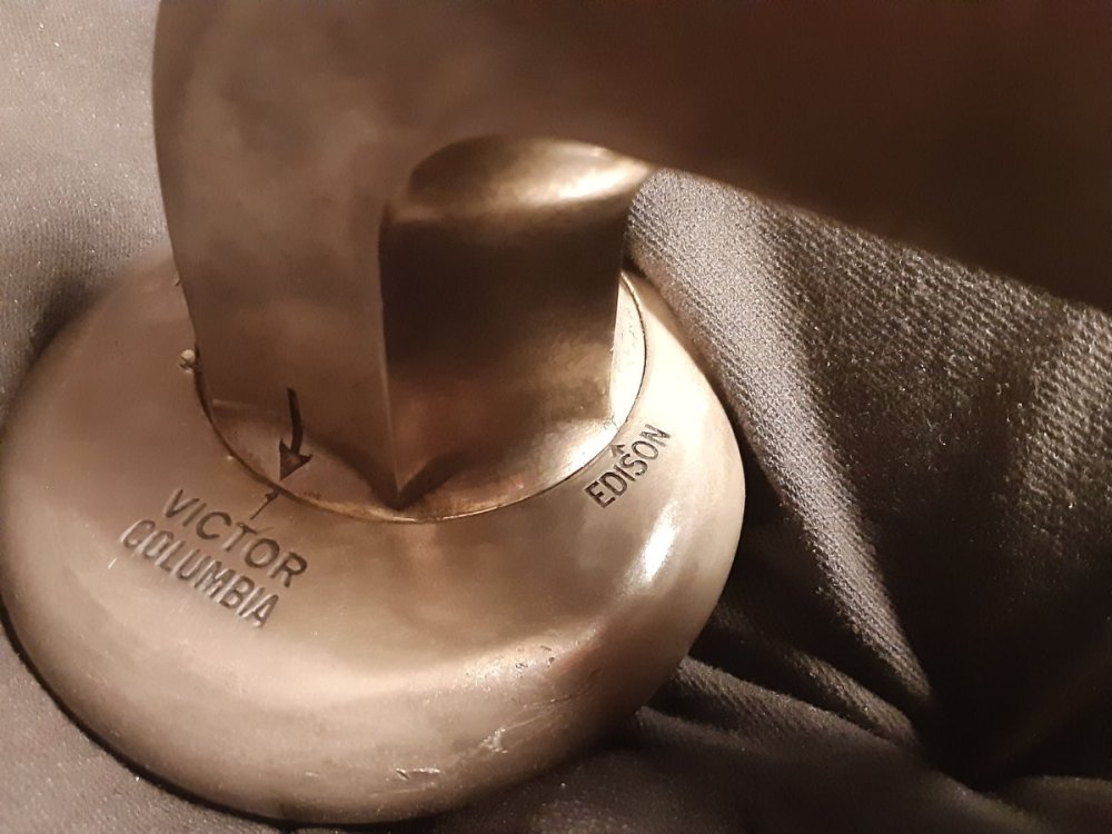

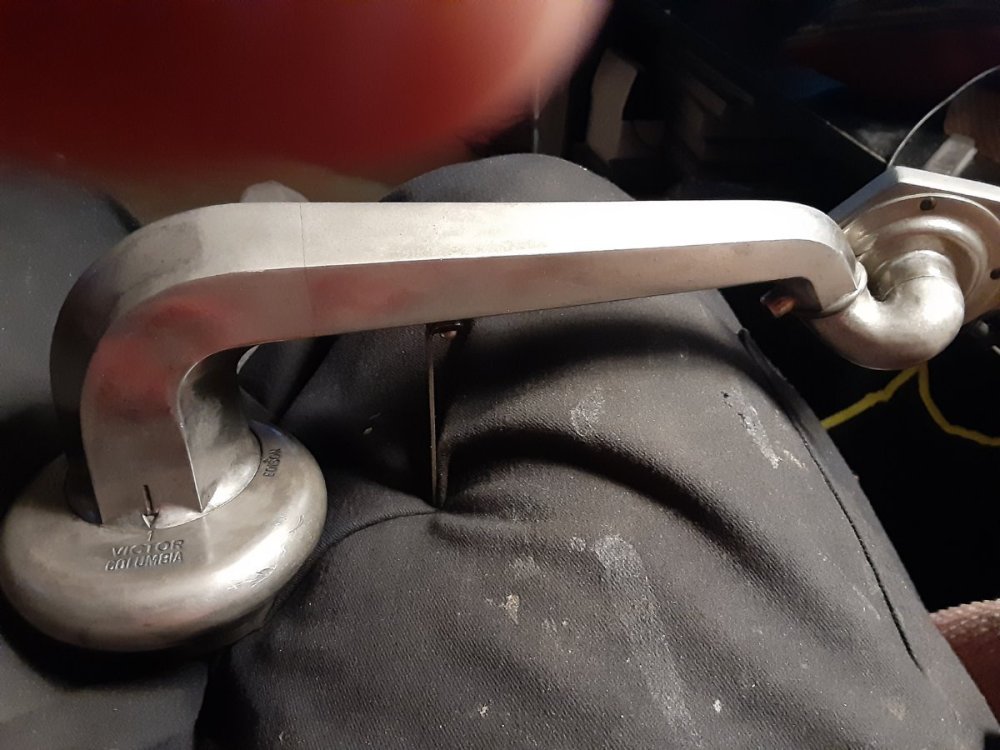

Just got an antique Burnham Record player - everything seems OK except the arm - it has an adjustment on it that I cannot figure out how to use

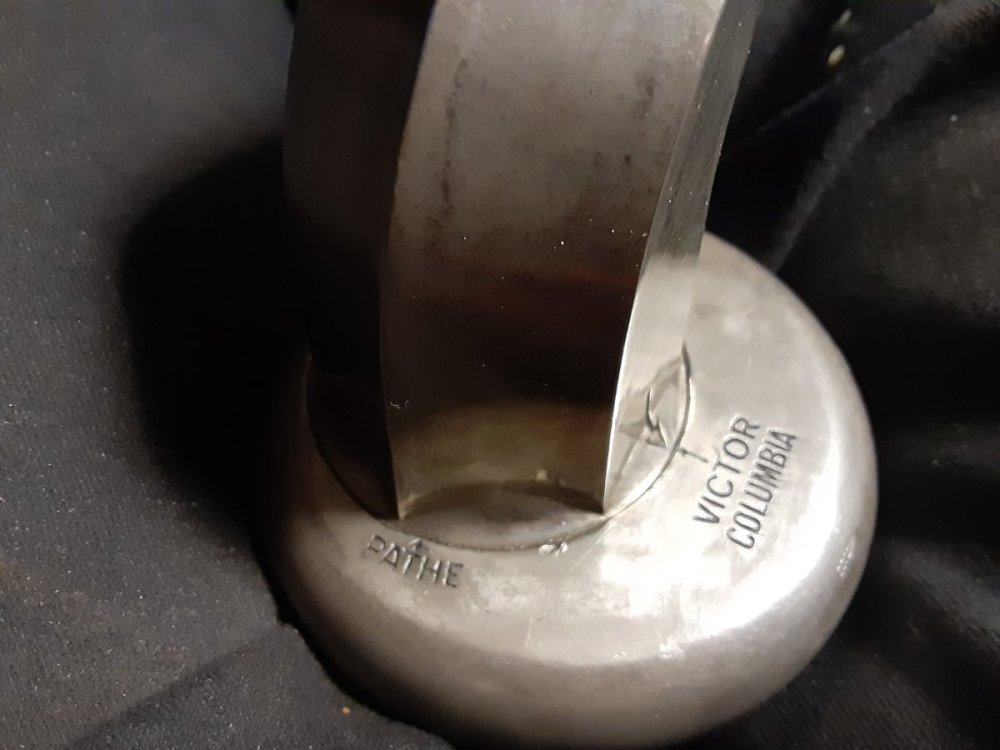

On the arm there is a weight that you are suppose to be able to change, depending on the company who made the record- I cannot get it to rotate
See attachments  - any idea?       I tried using it, but the record I presently have went around OK, but when I tried the arm, it was too heavy and stopped the table from going around (I think the weight was in the wrong place for the record I have)
Recommendations?
Burnham used the supplier company Fletcher on a lot of their machines for tonearms.
If the counterweight isn't moving, I'd suggest soaking it in penetrating oil for a while then trying to get a little grease inside where it moves. (I haven't worked on a Fletcher tonearm, so I don't know if you can remove the weight.) The motor may also need to be serviced if the plater slows down when trying to play a record.
