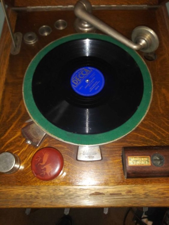

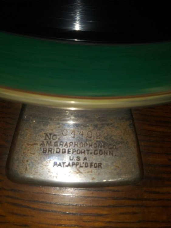

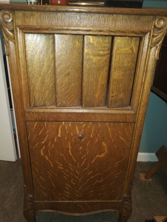

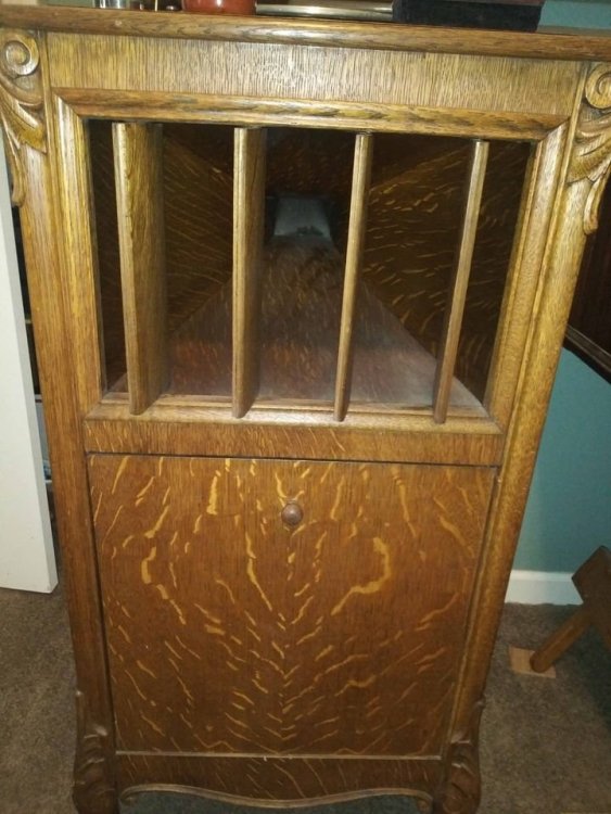

In the past, you gracious gentlemen helped me with an inquiry regarding an antique phonograph, and so I'm here once again to tap upon your knowledge and expertise! I have been admiring both the look and sound of antique phonographs for some time now, but being a novice in the world of antique phonographs, (and not knowing exactly what to look for and/or what to possibly avoid), have been reluctant to "pull the trigger" and actually become the proud owner of one! I recently came across this one for sale in my hometown, am very interested in potentially becoming it's new owner and am wondering whether you can help me with the answers to a few questions. I have included photographs below. It is in working order, and appears to have been restored and in very good condition. It is described by the owner as "an American Graphophone in very good to excellent condition." I've reviewed this site's price guide, but am uncertain as to what exact model it is. Any help as to its exact model number, when it was produced (was it between 1888 and 1912?) and its value in the current market would be greatly appreciated! Please let me know if you need any additional information. Thank you so much for your help in advance!
Columbia sometimes made it rough for us collectors to identify certain Grafonolas.   This pictured machine is either the 1914 style of the "Mignonette" or the 1915 "100" (they are identical, since the 100 was simply a renamed "Mignonette").  The 100 seems to have been phased out around 1918.
The APS Public Price Guide currently values a Mignonette/100 in Fine/Average condition at $210-$260, and in Excellent/Restored condition at $$285-335.  The quality and extent of the work done to this Grafonola will ultimately determine its market value.  Being in oak, the machine's desirability is enhanced.
( https://antiquephono.org/wp-content/uploads/documents/APSPriceGuide_Public.pdf )
I had one of these in mahogany for many years, and it was the loudest upright machine I owned.  I liked its size, the amount of decorative trim, the tilt-out record storage, and especially its performance.
