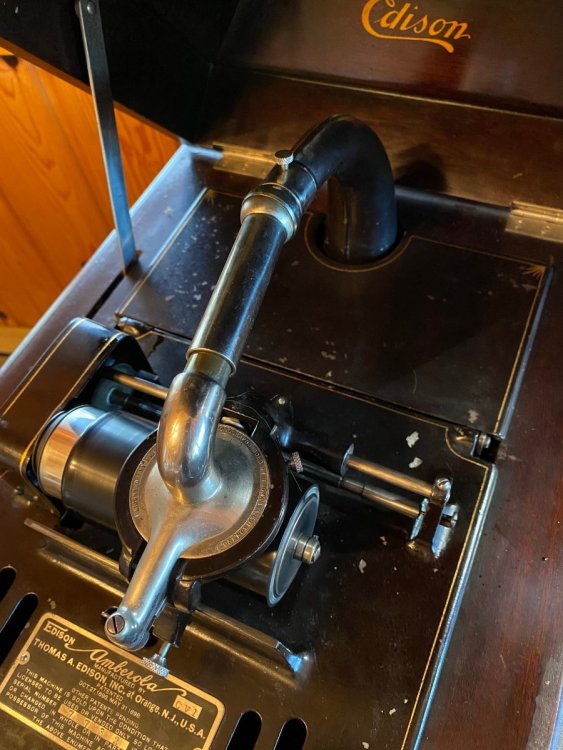

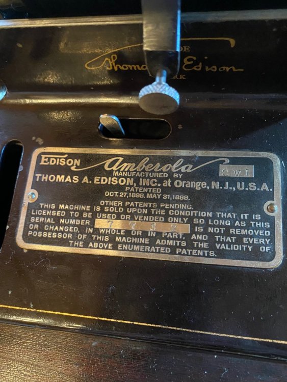

I have a similar question on the age of our Amberola CV1. Any info on it?
 Thanks,
Al
Edited by AlB1
 Thanks,
Al
Sorry - your Amberola was sold after May 1908, so I have no precise data for you.
That said, the Amberola C VI was introduced in 1914, and the factory fire of December 1914 brought its manufacture to a close.  Therefore, it's safe to say that your C VI dates from 1914.  That's about the best I can do.
