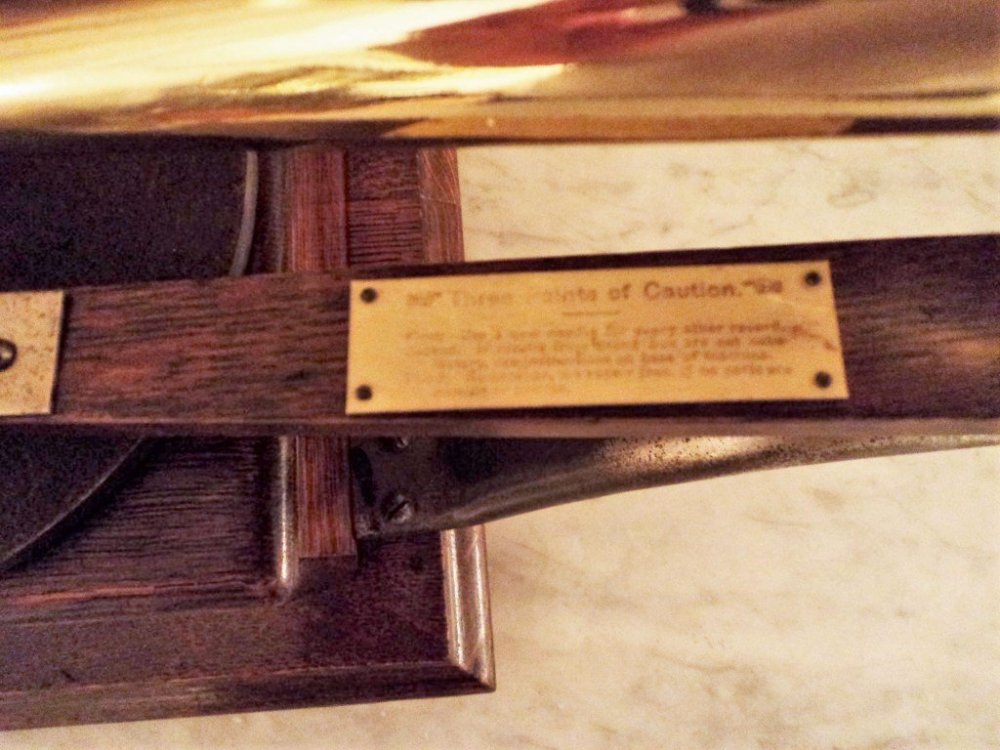

3) "Caution" tag?  Yes.

#24337: Has a dark cabinet finish, top brake "c," and a celluloid tag (as pictured below).

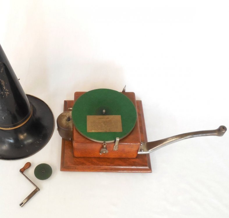

Thank you Michael.  You have quite a collection of these.  I have data now on 32 machines.  One that is out of the ordinary, is the fourth one you listed.  I believe you said it is serial number 24428, but that is well within the range for the top brake models, yet that one has a side lever brake.  It is also in the "Caution Tag" serial number range.  It is possible the motor was replaced I suppose, or mixed styles were still going out in the late Spring of 1899.  Perhaps double check that number again as sometimes they are tough to make out due to corrosion or wear.
Your last one (#25139) is also within the range of serial numbers that typically appeared with Caution Tags, but tonearms are sometimes switched among machines, so that isn't quite as strange an anomaly.
Again, many thanks for taking the time to reply.  George has shared his database as well, so hopefully we'll be able to do a fairly comprehensive article on these soon.
Mike

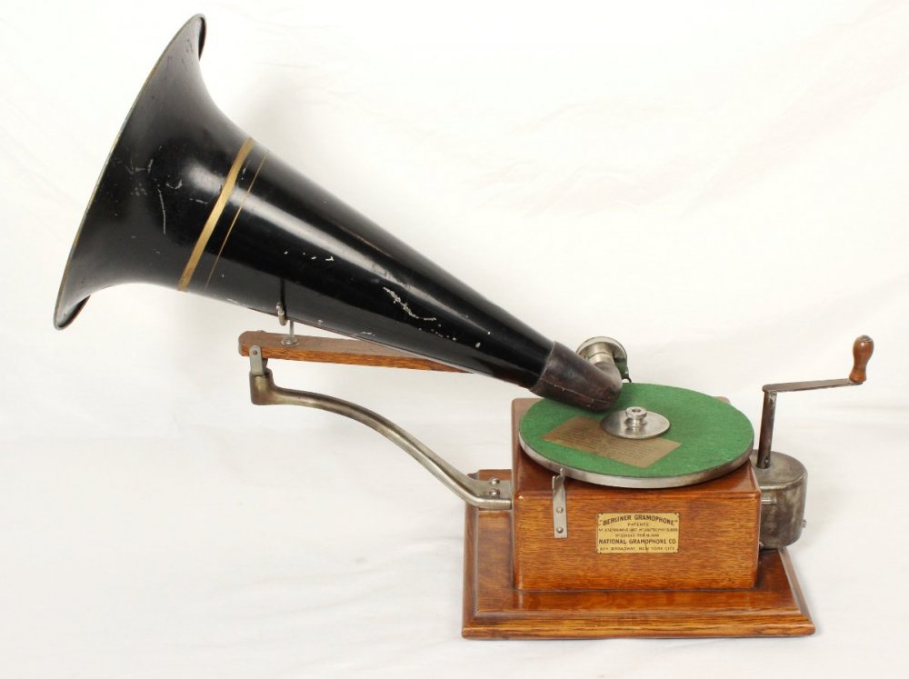

Sorry I'm late to the party.

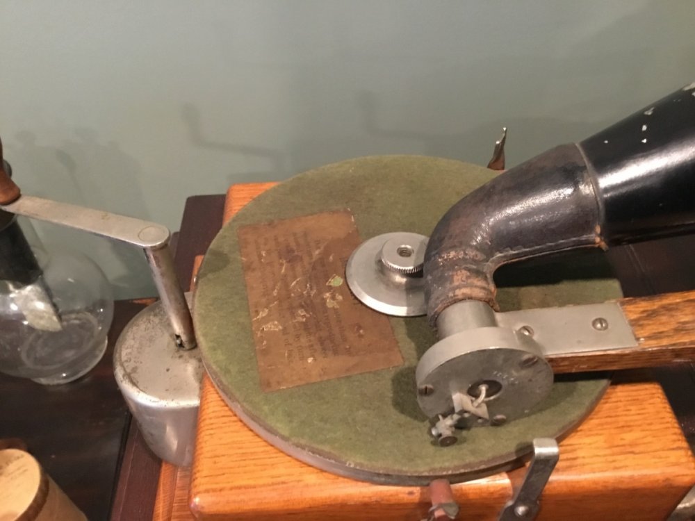

I believe that my Trademark is 100% original.  Was found in a steamer trunk in Boston Mass with a Berliner record (3430 Cheerfulness - Pryor & Higgins) on the turntable and a blanket over the machine.  The record must have preserved the paper tag.  Who knows how long it sat that way.
Here's the data:
1) Type of brake:   b
2) Sound box rest on opposite side of decal?   a
3) "Caution" tag?   b (no)
4) Record clamp:   a
5) What type horn?   d
6) Serial number?  19335
7) Serial number of sound box?  J 13751
Mine has a paper tag on the turntable felt just like Gregg's.  Also has a nice paper tag on the bottom regarding operating instructions.

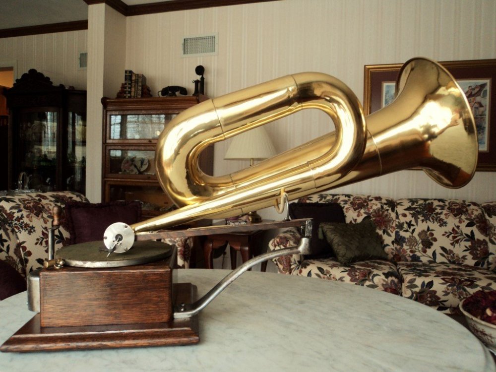

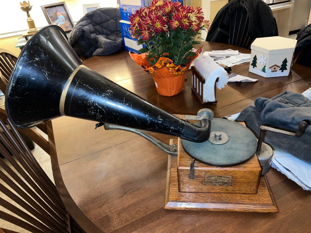

Mike, Here is the information on my Berliner. Thank you for your effort on this research.
 1. Top Brake
 2. Reproducer rest on same side as the decal
 3. Celluloid caution tag present
 4. Record hold down has no hole
 5. The horn is the optional Coronet  Horn that I believe was sold through Montgomery Ward.
     This is the horn that was on the machine when I bought it.
 6. The motor serial number is 23276
  7. This is an original Berliner reproducer, but it not original to this machine.The original was reproducer was not present  when I found it.
       Serial number of this one is 25537.

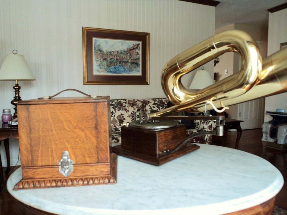

 The pictured Berliner record cabinet was with the machine, filled with Berliner, Berliner pirated, Improved Gram-O_Phone, and early Victor records

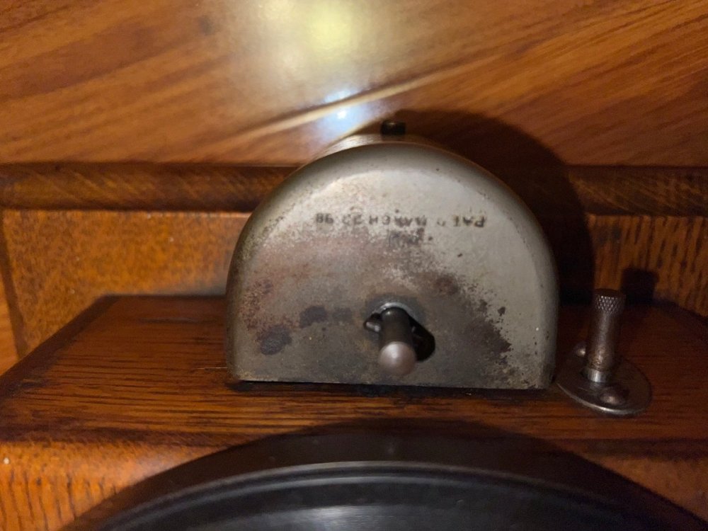

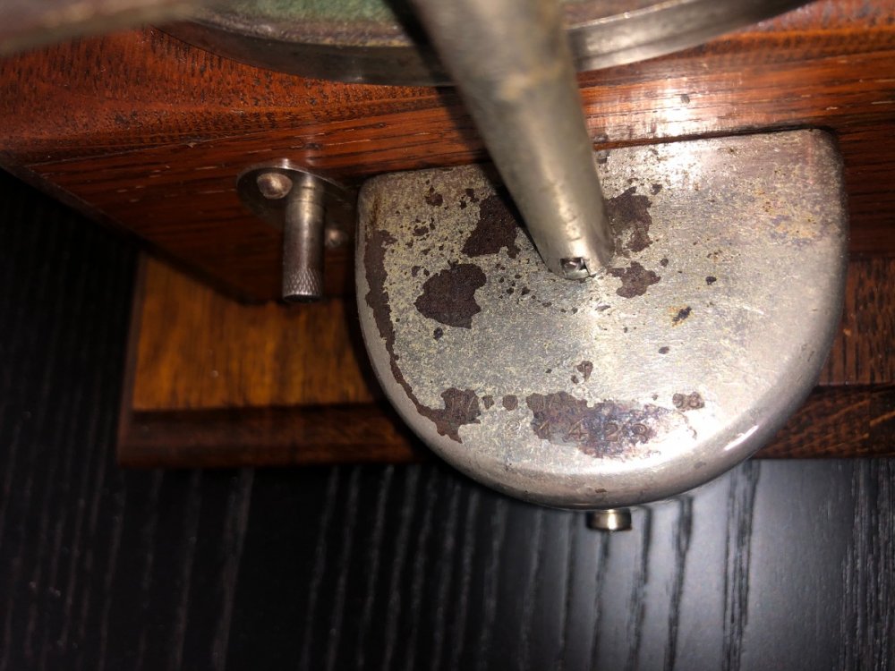

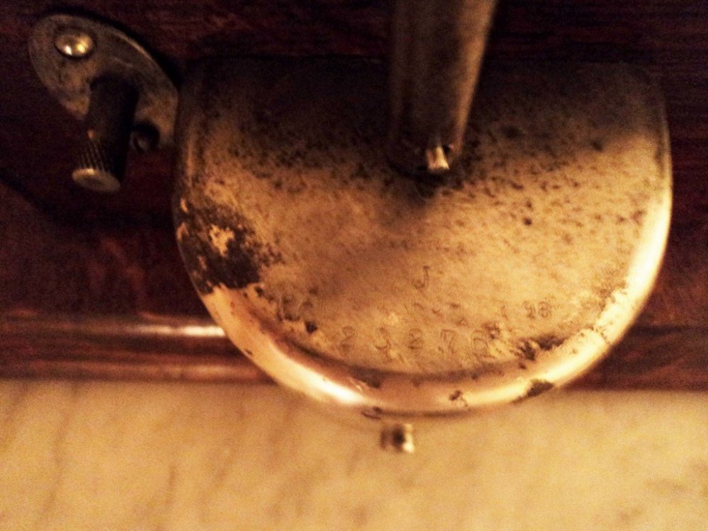

Here is a photo which clearly shows the 24428 serial number. I found it curious that a side break model has such a high serial number. While cranks, reproducers, record hold downs, horns and tone arms are often missing and easily separated from the machine, and thus commonly changed among machines. It seems that it would be unlikely to have had the motor housing changed from a different machine.
Mike

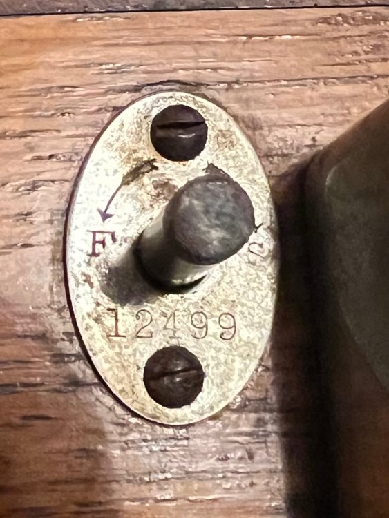

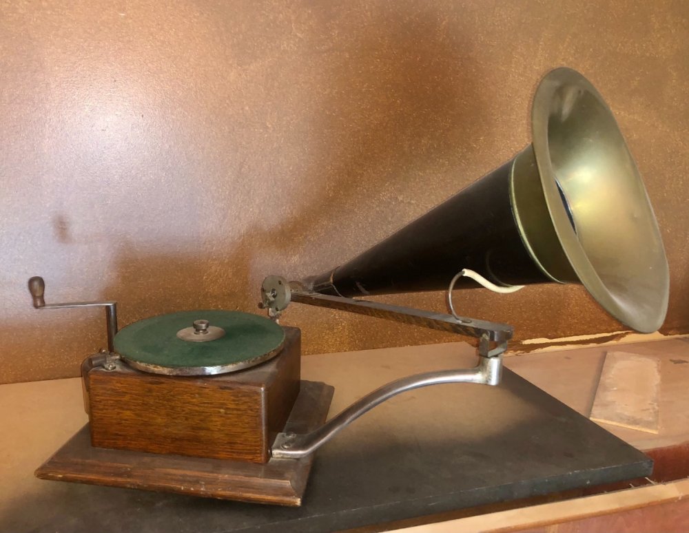

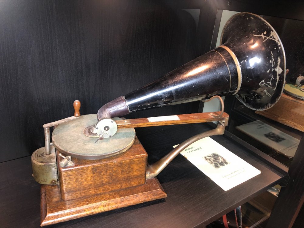

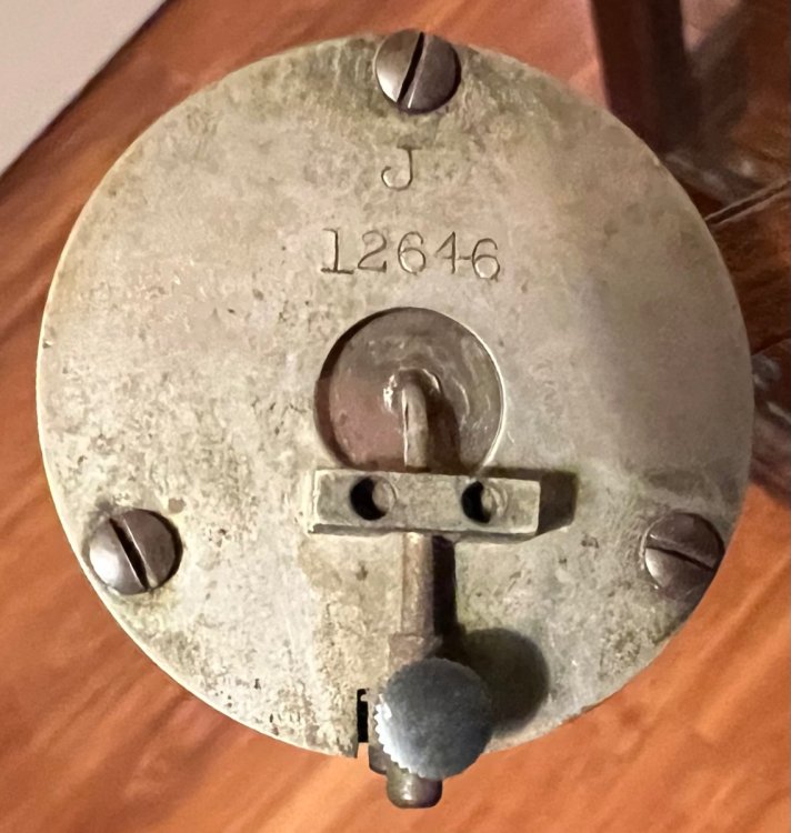

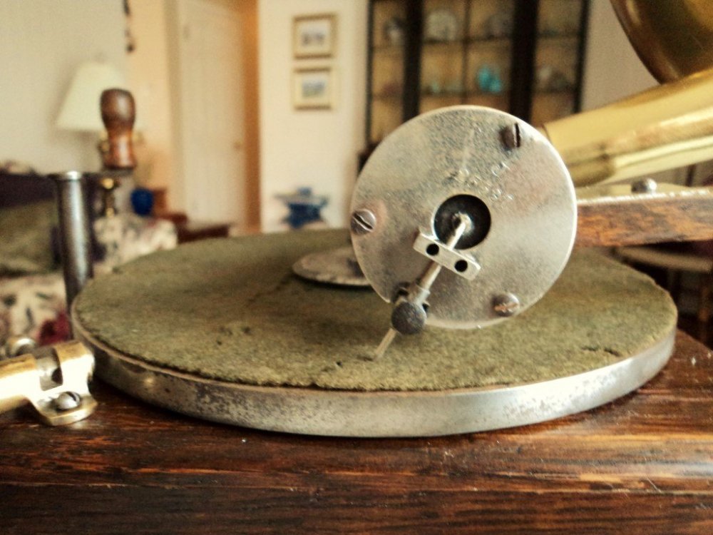

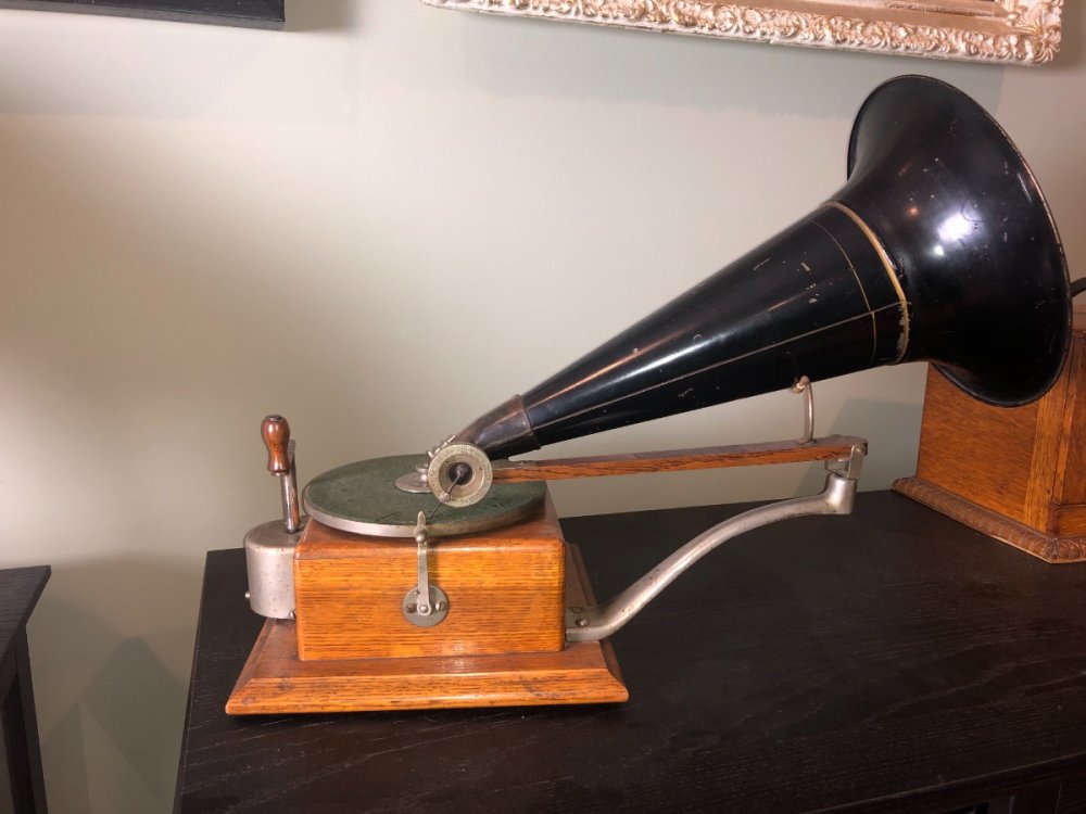

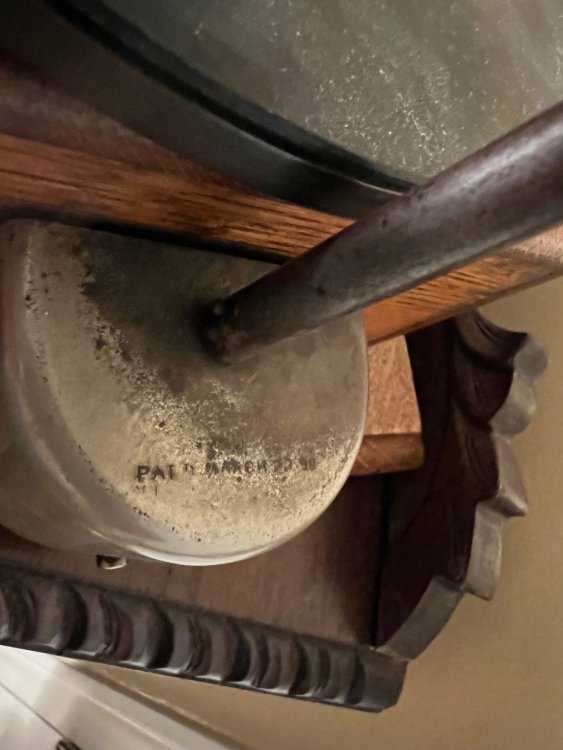

I recently acquired my first Improved Gramophone and thought I should add it to this thread.  There is no serial number on the spring barrel housing that I can see, but there is one stamped into the speed control bezel.  This seems a bit odd compared to the pictures I’ve seen and the articles I’ve read in The Antique Phonograph.
Matt
1) Type of brake: b (side brake with lever).
2) Sound box rest on opposite side of decal?  Yes.
3) "Caution" tag?  No.
4) Record clamp: no hole.
5) What type horn?  A: Black Funnel Horn.
6) Serial number?  12499
7) Serial number of sound box: 12646
Thanks for posting your Berliner here, Matt.  I don't recall ever seeing a Berliner serial number on the speed control bezel.
