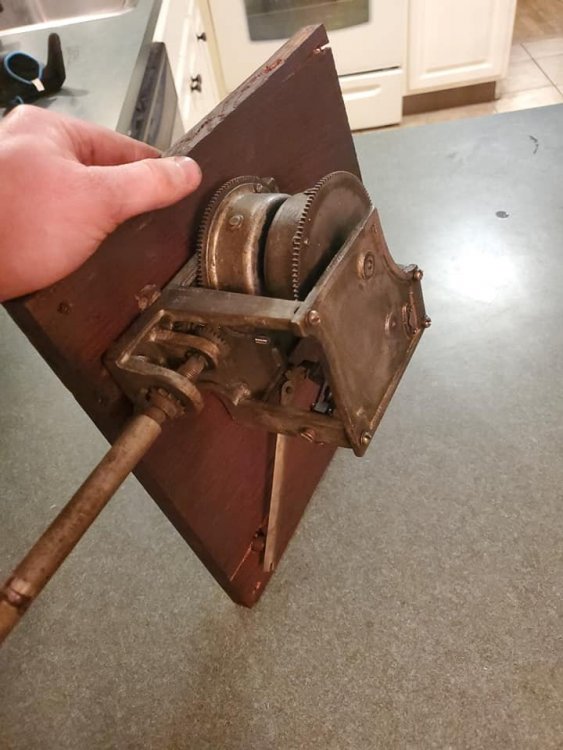

Hi all,
I have an upright phonograph that I'm having trouble finding information on. This was a piece from my grandfather and has been broken for the last 40 years or so. I took it apart and repaired the double clockspring mechanism, regreased and reassembled the geartrain, and got things working again there. The head spring is not adjusted correctly and there are two rotary slipjoints that I'm also not sure how they should be positioned or when they should be adjusted. (Total vinyl newbie) I'm aware that the drum head probably needs resealing as well. It's a variable speed unit with a dial adjuster for 70 to 100. I assume this takes the one-use steel needles. I found two in the workings when I took it apart.
The manufacturer appears to be the Melodius Phonograph Corporation of Newark, NJ. Cursory google searches don't turn up much. Is this an off-brand cabinet? Anything else I should be aware of? Thanks for your time.

Thanks George, that was all incredibly helpful. I'm not concerned much about collectible value. The cabinet is missing the upper and lower front doors and the finish is in poor shape, so most of this is my own curiosity.
Apologies for the terminology mistakes. I'll try to correct them here. The tone arm has two rotary joints that allow angular adjustment of the soundbox. You can see in the first picture I posted that the soundbox is laid over at quite an angle. Adjustment of this (IE, should it be off-vertical ever? Why?) and the actual surface pressure that the steel needle should be exerting on the proper records are the two open questions I have even after reading through all the guides present on the website here. The spring in the back of the tone arm needs adjustment or replacement, I believe, and seems to not be tensioning the tone arm/soundbox properly. I can adjust it, but have no idea what I should be aiming for.

To play the common, laterally-recorded records made by Victor, Columbia, and hundreds of other companies, the diaphragm of your sound box should be perpendicular to the record's surface.  (in other words, vertical.)  Your tone arm and sound box were designed to play both laterally- and vertically-recorded discs, but the latter require a special sapphire ball stylus.  This interchangeability was the reason your sound box can be rotated on the tone arm.
Most tone arms in the acoustic period lack any needle/stylus pressure adjustment.  Those that do may have been an attempt to play the vertically-recorded discs better.  In any event, I wouldn't worry too much about it.  It probably wouldn't hurt to adjust the spring so that the least possible weight is on the needle - you probably won't hear any difference in sound.  It may be that the adjustabilty was more gimmick than anything else.
