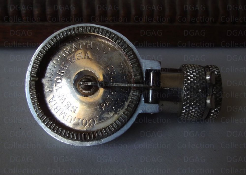

Unusual(?) "Heavy Eagle" reproducer
  • Grammophon changed the title to Unusual(?) "Heavy Eagle" reproducer
The compression ring looks like that of an Edison Reproducer.
You are right. It looks like a clamp ring from an Edison reproducer. Thank you very much. It seems to be a historical repair, which I leave in this condition. The Columbia AB came from a private owner who was no phonograph collector.
I agree that it seems to be a somewhat later repair but very interesting.  I also would leave as is.
Is the body of the reproducer threaded to accept the ring or is the threaded ring just pressed in?
