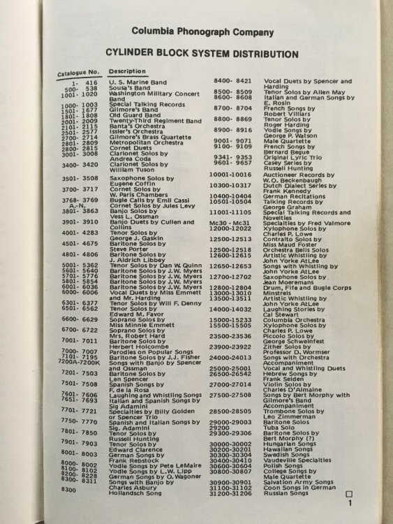

Analogous Posted October 27, 2020 Posted October 27, 2020 Hi George, You're right that the absence of XP marketing makes no sense. After all, we're talking about Columbia! My source - and I suspect Allan's - is the Lorenz discography. If anyone has Columbia catalogs from 1899 - 1901, that would help clarify this conundrum. The answer to your block system question is "sort of yes." By 1899, some blocks had gotten large (e.g. Columbia Orchestra) and new blocks were needed for new artists and genres (e.g., Bert Morphy and Hebrew songs). So, for example, most J.W. Myers cylinders are in the 6000 block but the ones made later with orchestral accompaniment are in a new 24000 block. In 1900, one sees a lot of these higher numbered Columbia's, all produced pantographically. With the rationale for block numbering undermined by catalog size, the handwriting was on the wall. In early 1901, one sees the last set of block titles, Russian songs in the 31200 block. Then, when migrating to a chron system, did Columbia create a clear separator (like starting at 40000)? Nope! They just went to the next logical block (31300) with their revised cataloging system. Hope this helps. John

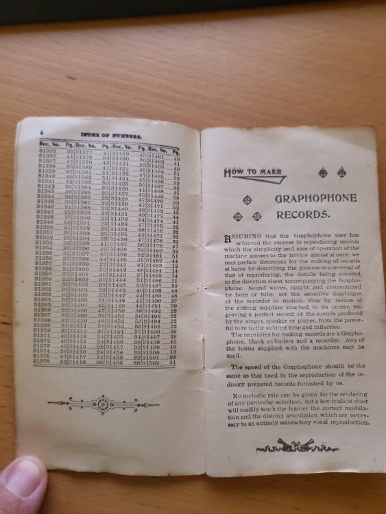

Phonomark Posted October 28, 2020 Posted October 28, 2020 George and John- I have an original 1901 Columbia Record Catalogue. There is no month printed anywhere, so I'm not sure when in 1901 it was published. The numbering system is continuous thru 31502. It appears that 31300-31302 was dedicated to Chinese Vocal Solos. 31303-31307 was dedicated the Negro Dialect Talking Records. And 31308-31502 was randomly dedicated to vocal solos, coon songs, and others. After 31307, there does not appear to be a dedicated run of numbers to a particular selection or genre. But I have not checked closely for blocks associated with particular artists. The catalogue is delicate and I have to handle it carefully. I've attached some photos for you. Mark 1
phonogfp Posted October 28, 2020 Posted October 28, 2020 Mark, thanks for showing that 1901 catalog. It's clear that Columbia's conventional brown wax was numbered well into the 31000 series. I did some sleuthing today in The Music Trade Review and found what I was looking for. In the last weeks of 1901 and the first 8 weeks of 1902, Columbia's advertisements mentioned only the 50 cent "Small Records" and the $1.00 "Grand Records," along with the new "COLUMBIA DISC GRAPHOPHONES using FLAT RECORDS." Then in the March 8, 1902 issue, a new ad appeared, offering "The Celebrated Columbia Records" for only 30 cents apiece or $3.60 per dozen. These were formerly 50 cents each, or $5.00 per dozen. The same ad asks in large font, "Have You Heard the New Columbia Moulded Record? A WORLD BEATER. Adapted to all machines; almost as loud ad the Grand." Then, taking a dig at Edison's newly-introduced moulded records, the ad states: "All Columbia Records can be shaved and the blank recorded upon. This is true of no other new record on the market." Neat, huh? I have already contacted Allan Sutton, and he graciously thanked me for the heads-up, and said that he would be taking down the current work (which he admitted hadn't been updated in many years) and replacing it with a much improved and updated version. George P. 1

Analogous Posted October 31, 2020 Posted October 31, 2020 George - not sure what you mean by “conventional” brown wax. The 31300 and above titles are all molded. The ones <31300 are pantographed. There’s a reason this era is called transitional!
phonogfp Posted October 31, 2020 Posted October 31, 2020 On 10/31/2020 at 4:42 AM, Analogous said: George - not sure what you mean by “conventional” brown wax. The 31300 and above titles are all molded. The ones <31300 are pantographed. There’s a reason this era is called transitional! Expand John - are you suggesting that Columbia listed pantographed records and moulded records side-by-side in a catalog with no distinction (including price)? The final image of Mark's catalog shows #31498 on the lower right of the right-hand page.
Analogous Posted October 31, 2020 Posted October 31, 2020 Yup. That’s what they did. As old inventory was depleted they recorded a new 160 rpm molded version often replacing piano accompaniment for an orchestra and sometimes changing artist.
Phonomark Posted October 31, 2020 Posted October 31, 2020 Per the second photo that I uploaded, this 1901 catalogue goes thru 31502.
phonogfp Posted October 31, 2020 Posted October 31, 2020 On 10/31/2020 at 2:59 PM, Analogous said: Yup. That’s what they did. As old inventory was depleted they recorded a new 160 rpm molded version often replacing piano accompaniment for an orchestra and sometimes changing artist. Expand But what about the price difference? There's no mention of that in the 1901 catalog. I understand that an earlier title made on a pantographed record was often remade on a moulded record, but this is a 1901 catalog. 1901 - showing numbers as late as 31502. In 1901 - - and probably early 1901, since the company wouldn't want a catalog to be "outdated" in a month or two. George P.
Phonomark Posted November 1, 2020 Posted November 1, 2020 Guys, while looking up a title for Bob, I realized there are a couple more blocks per the attached photo. 31356 thru 31370 for Church Organ and 31458 skipping some number to 31478 (Church Organ) with Violin Obligato, If you read the caption below the Church Organ title, it notes that these selections are being listed for the first time. PS The catalogue is 64 pages long...!! Mark
phonogfp Posted November 1, 2020 Posted November 1, 2020 Mark, I presume that there's no mention of moulded records in this 1901 catalog. Is that true? George P.
Phonomark Posted November 2, 2020 Posted November 2, 2020 George....No there's no mention of moulded records. And the price is stated as 50 cents each or $5.00 per dozen. Mark
phonogfp Posted November 2, 2020 Posted November 2, 2020 On 11/2/2020 at 4:41 AM, Phonomark said: George....No there's no mention of moulded records. And the price is stated as 50 cents each or $5.00 per dozen. Mark Expand Thanks Mark. George P.
