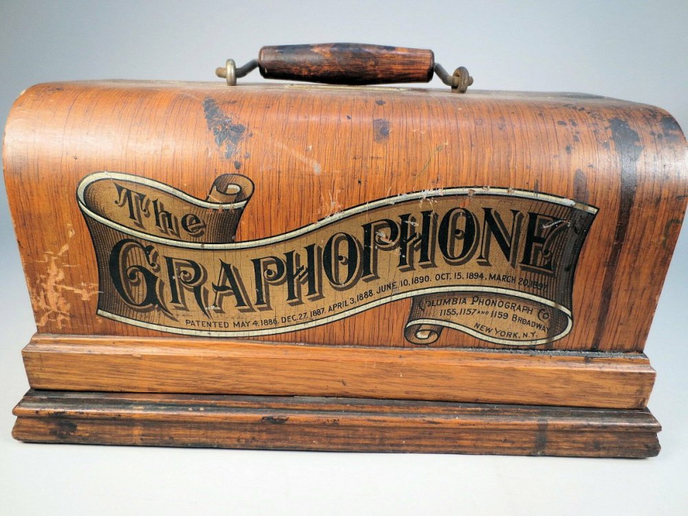

All too often, folks who are unfamiliar with antique phonographs - or sometimes antique in general - happen across an artifact that appears daunting in its need for cleaning.  Unfortunately, some of these well-meaning folks may attempt to do the job with harsh household/workshop products and ultimately damage the item.  Here is an Eagle Graphophone which suffered from decades of dirt and careless handling around wet paint:

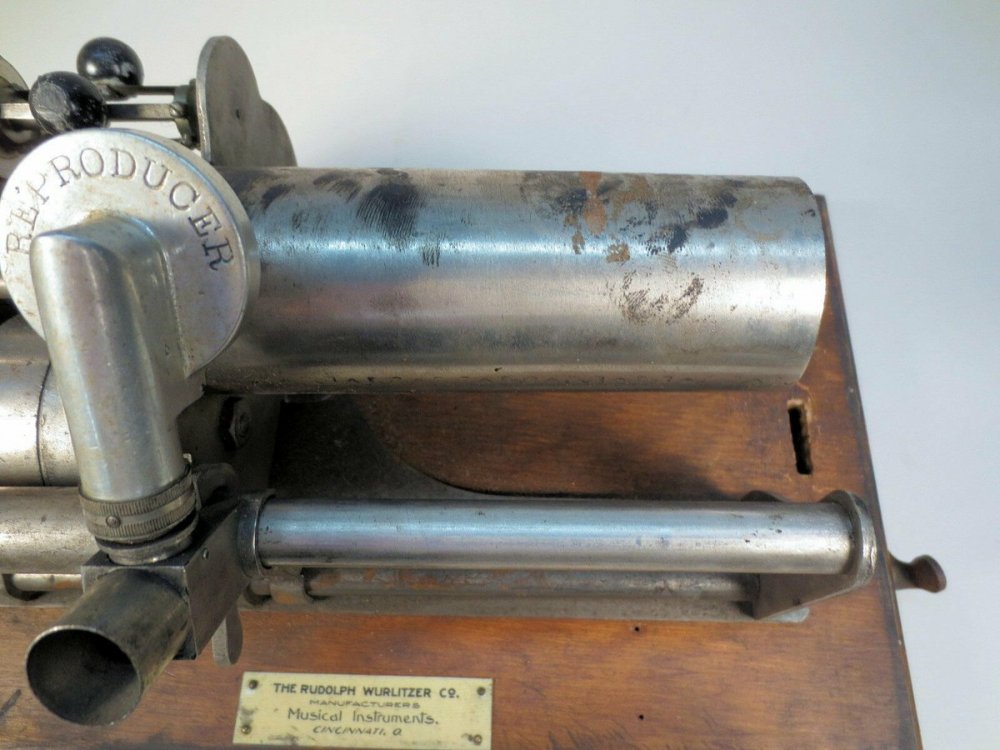

Look at the paint on the mandrel!  Some fingerprints were good enough to convict whoever did this...

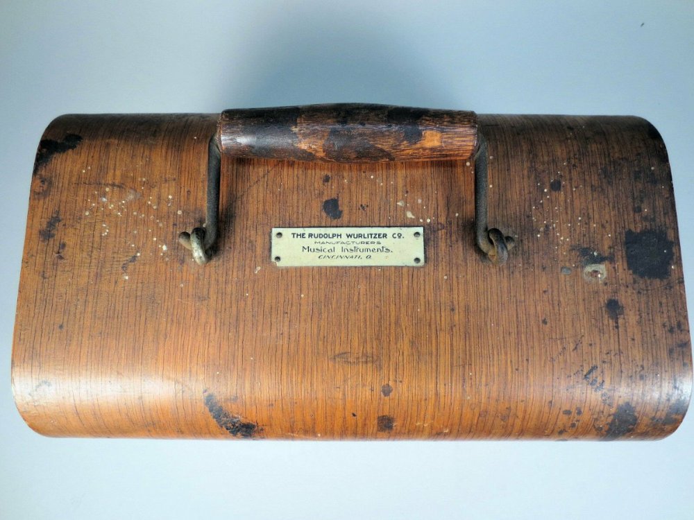

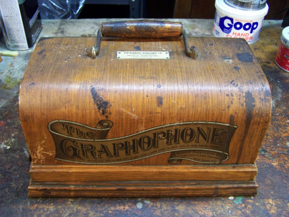

Then there was all the paint on the lid...
Luckily, the decal was relatively undamaged.  Considering the scratching just to the left of the decal, and the lack of thick black paint on the decal, it was almost miraculous:
The Eagle is a pretty easy machine to clean up, because there's no paint to deal with.  The decal(s), however, can be very tricky.  The company decals always had a finish applied over them, so they're somewhat protected.  A retailer decal is a different matter, and they must be very carefully handled - - preferably left alone if possible.  This particular Eagle has two celluloid plates with retailer information ink-stamped on them.  I've seen similar celluloid plates wiped clean of ink by folks who didn't realize how fragile the old ink is.  No cleaning agents should ever be used on these - - just a bit of damp rag carefully and lightly wiped across the surface.

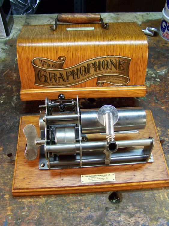

Well...time to start.  Get out your nitrile gloves!

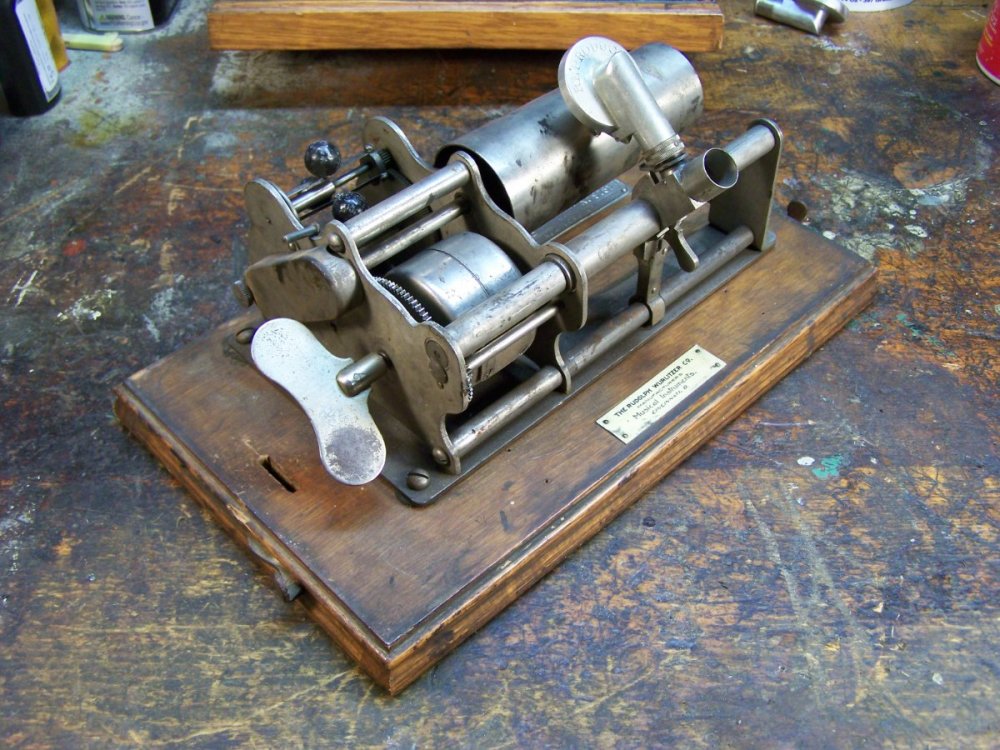

This Eagle must be taken apart; down to the last screw.  There's no other way to properly clean it, and if it's not clean, you can't expect it to work properly.  I tend to let metal parts soak in WD-40 overnight to loosen grunge.  Then I use 0000 steel wool to remove hardened grease, fossilized oil, and - in this case - paint.  Once the metal parts are clean and dry, I'll polish them with Nevr-Dull or Mother's - - sometimes both.  I haven't figured out why one product will sometimes work better on one part while the other product works better on another.
...But what about the wooden parts?
To remove grime, I use Goop, GoJo, or similar NONPUMICED hand cleaner readily available from big-box stores.  Just wipe it on with a clean piece of paper towel, let it sit a minute, then wipe it off with another clean paper towel.  I have a box full of worn-out socks that I use for final rubbing once the paper towels start coming out clean.  Oftentimes, a second application is necessary.  If the surface feels a bit sticky, it needs another application.  CAUTION:  some of the cheaper machines used cheaper finishes, and after a couple of applications the finish will still be tacky.  Allow the wood to dry overnight or even a couple of days.
Now, hand cleaner won't remove all that paint, and that's where 0000 steel wool come in handy again.  EASY DOES IT.  You want the 0000 steel wool saturated with hand cleaner, and you want to rub only where the paint is at first.  if you've done a general cleaning with the hand cleaner already, the paint may have softened enough that it will come off with little effort.  Don't rub any harder than necessary - - you don't want to go through the finish.  You'll have a sore thumb for a day or two, but it will be worth it.  Be very, very careful when working over decals, and stop immediately if you see the decal losing color.
When all the paint is gone, wipe everything clean with a soft rag (old socks?).

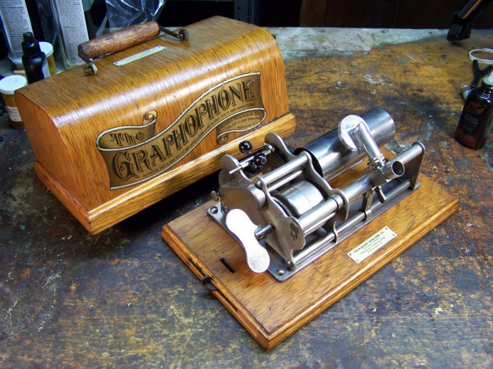

Now you can reassemble everything, applying a small drop of quality oil to bearings and gear teeth (no Three-In-One because it gums up in time).   If you were careful, it should look something like this:
As always, know your limitations, ask questions when unsure, and take your time.  Good luck!

This Eagle is very lucky to have found you, it looks great now!
Thanks - - this Eagle was very lucky that none of the black paint got on the celluloid plates, and that the decal somehow avoided damage.

Really nice work George.  Just the way it should be done.  Nothing worse than seeing a machine with a botched amateur restoration knowing that if just cleaned properly, it could have looked like your Eagle.  Oh and that slopped paint over the front of the decal must have been especially delicate.
Edited by Valecnik
added thought
Thanks Bruce.  Yes, the paint on the decal was tricky - - and you'll see that I didn't remove quite all it.  I'd rather have 100% of the remaining decal plus a bit of paint on it, rather than 90% of the remaining decal with no paint.  It's a call we must make on each project, but I just wasn't comfortable trying for "perfection."  Maybe someone else, someday...
