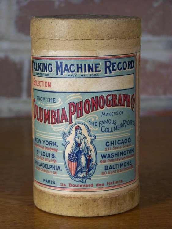

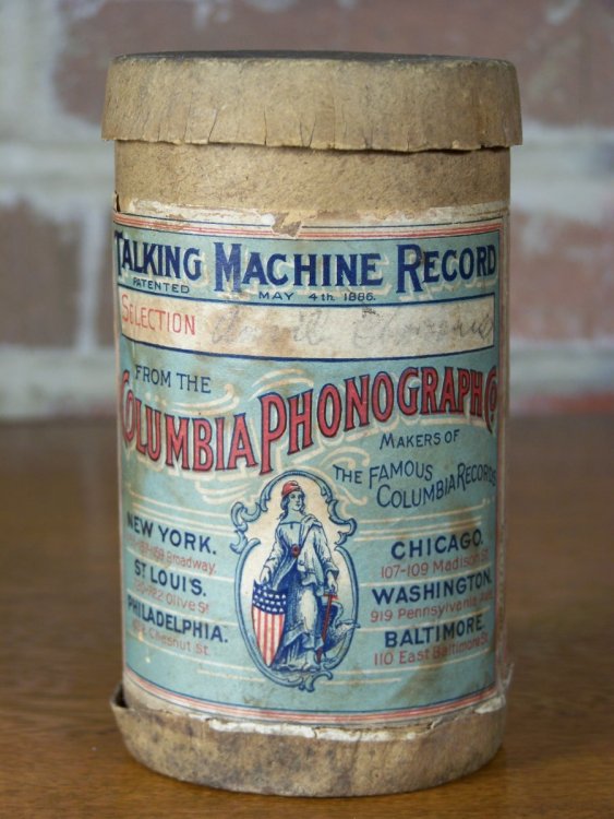

TYPE 1, Columbia's first known labeled cylinder box featured a small image of Columbia holding a shield:

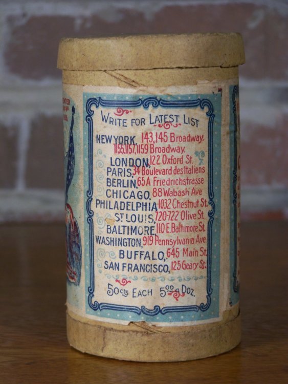

TYPE 2: Columbia's second known box was (except for a change of Chicago's street address) identical to Type 1, but with the addition of the Paris Office address:

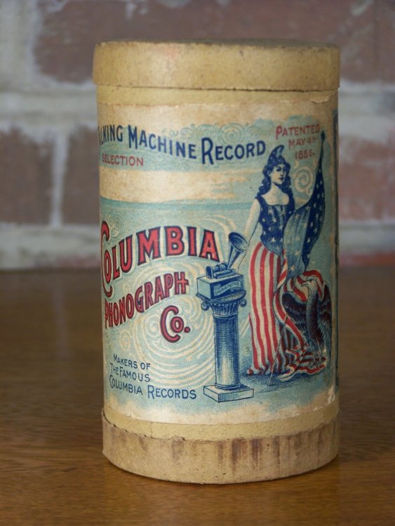

TYPE 3, "First Flag."  The red, while, and blue palate was continued but with a substantially larger image of Columbia - now holding a flag.  A Type A Graphophone appeared beside her, with the decal lettering misspelled "GRAPHAPHONE."

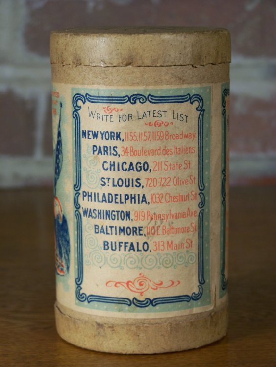

TYPE 3 detail:  Note below that the list of cities with Columbia offices ended with Buffalo, and the label cited a price:
TYPE 4: The "First Flag" design was unchanged (including the misspelling), but no price was shown.  In addition to conventional brown wax records, Columbia's first moulded cylinders (also in brown wax) were sold in this style box:

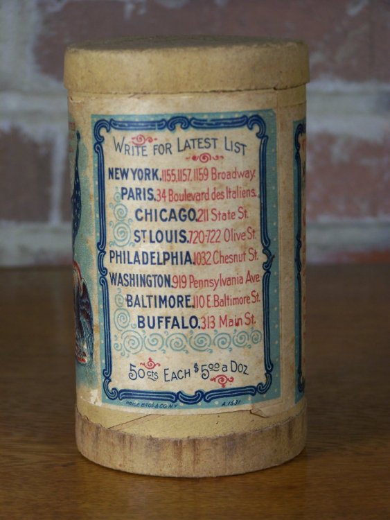

TYPE 5: In this "Third Flag" version, the misspelling was corrected to GRAPHOPHONE, San Francisco was added to the bottom of the list of cities, and the price reappeared:

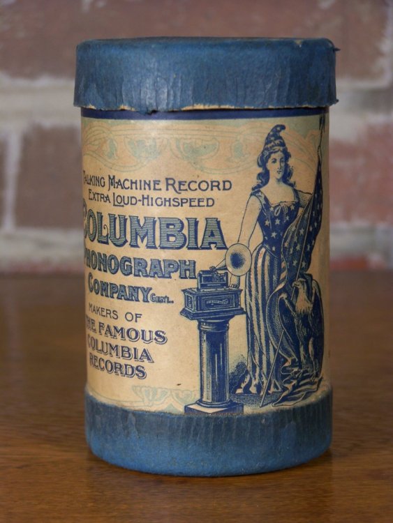

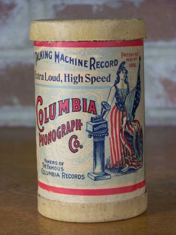

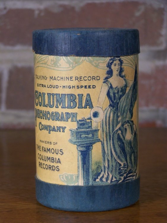

TYPE 6: In the "4th Flag" label (the final of the red, white, and blue series), the addition of "EXTRA LOUD, HIGH SPEED" made it clear that 160 rpm moulded records (although still in brown wax) had appeared.  This style box was evidently produced for only a short time:

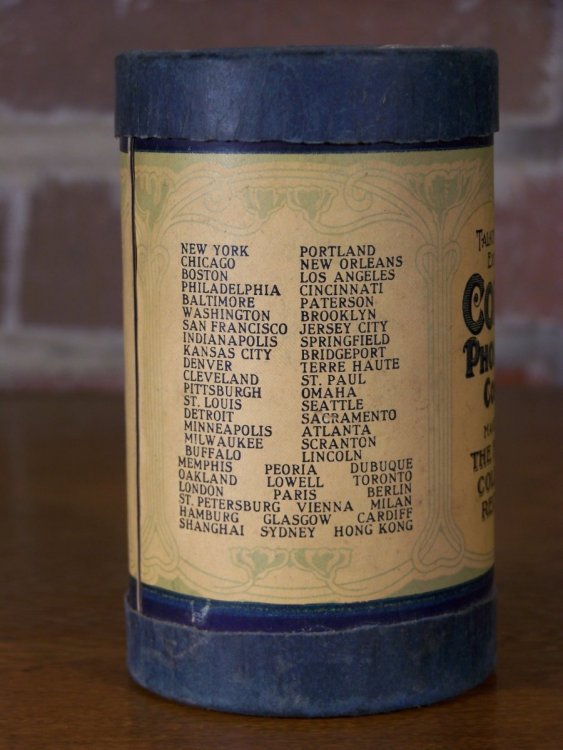

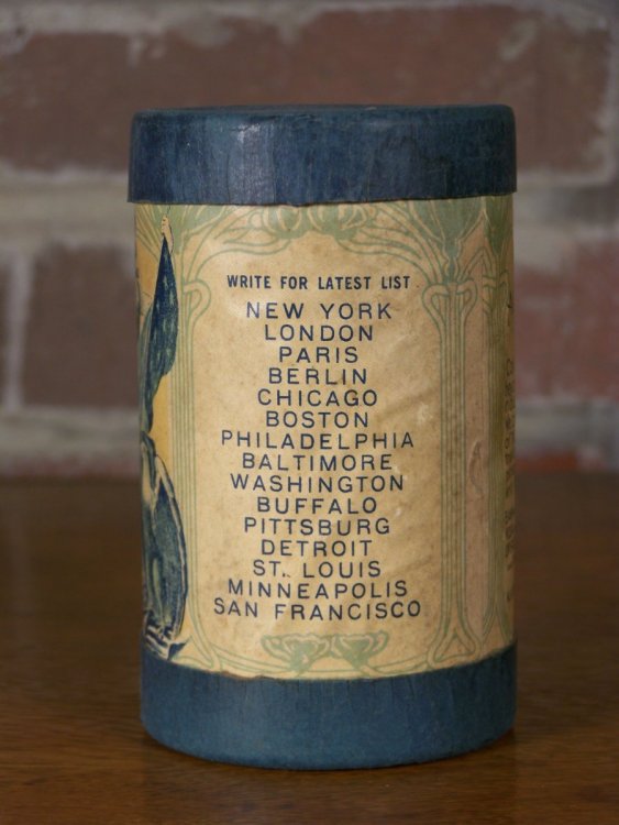

TYPE 7: The first "Blue Label" showed Columbia in blue on a buff background, and the image was noticeably larger than those which would succeed it.  The machine beside Columbia is a Type HG.  No price was listed.  The list of cities ended with San Francisco, and no patent dates were listed:
A detail from the Type 7 box, showing the list of cities:

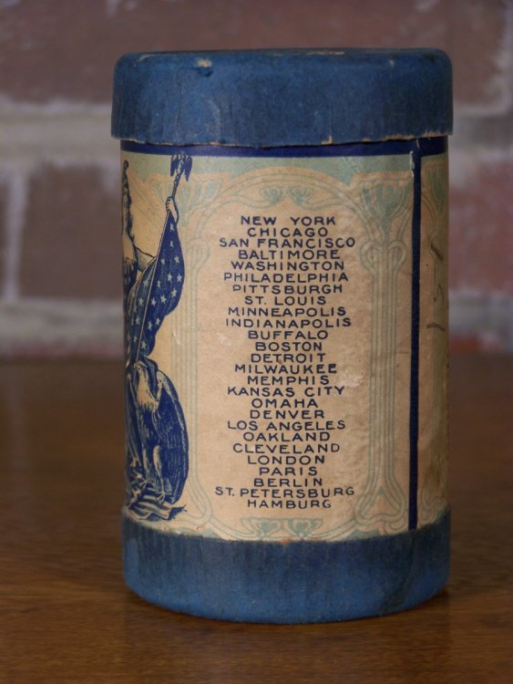

Type 8: The image of Columbia was noticeably smaller than Type 7.  A price of 25 cents was listed (this reduction was announced in the September 1903 issue of The Columbia Record).  The list of cities ended with Hamburg.  A list of patents was included, ending with March 10, 1903:
A detail from the TYPE 8 label showing the list of cities ending with Hamburg:

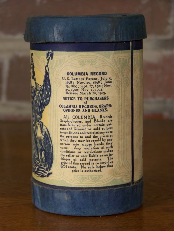

TYPE 10:  The "4th (and final) Blue" label appeared to be almost identical to Types 8 and 9, but the list of patents included "Reissue March 10, 1903," and Nov. 1, 1904.
2085648310_Col104thbluereissueMarch101903.thumb.JPG.b2f323e3cbd00479aa363391d4df3f2b.JPG

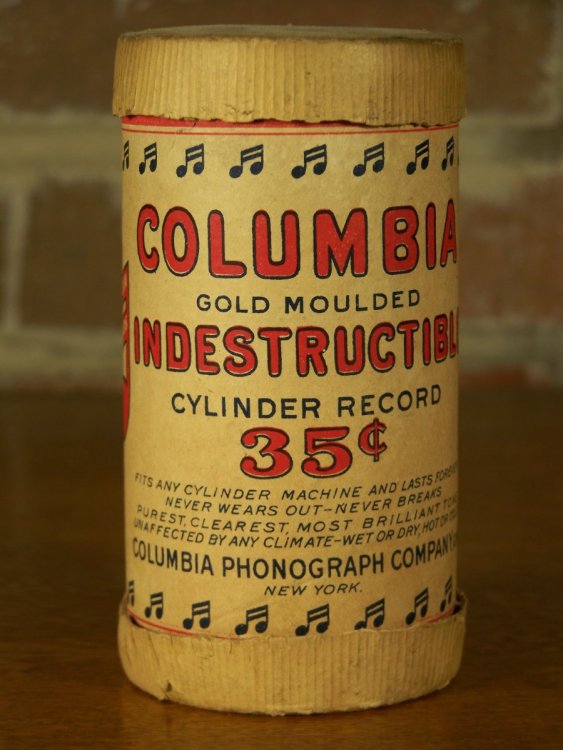

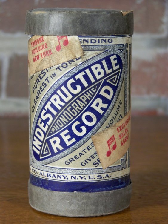

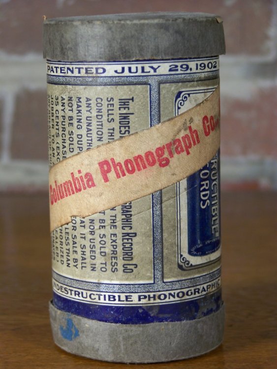

TYPE 11: In late 1908, Columbia became the sole distributor of the Indestructible Record Company's output of celluloid cylinder records.  Existing inventory were given an identification strip showing it to be Columbia product:
Another view:

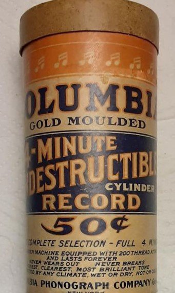

TYPE 13: A different design was necessary for Columbia's 4-minute cylinders.  (I could not locate a suitable box, so I borrowed this image from the internet):

I think - but am not sure - that George's sequence is correct, but for somewhat different reasons.
In January 1897, the company opened an office in NYC with some fanfare (and a modified record announcement).  The Type 1 box coincides with this period though, given its rarity, I don't think if was used for long.  The Paris office opened about a year later.  Record announcements were augmented accordingly as was this box with the Paris address added under the shield (Type 2).  However, this box change appears to have been short-lived while the Type 3 design was developed.  Since, by this time, Columbia's record business was exploding, they may have been concerned about a growing list of office locations cluttering up the front of the package.  Hence, these were moved to the side.
The record side of Columbia has a through-line of chaos that's reflected in the Type 3 box.  Despite its being one of the most eye-catching record packages ever produced, it has two typos.  The Graphophone banner is one.  Also, the box designer dutifully copied the addresses on the Type 1/2 boxes, misspelling Chestnut Street for the third time!  This error was corrected when these boxes were reprinted (Type 4) and pricing information was briefly dropped.
The growth of the company precipitated another re-printing - and a change in cylinder announcement - in early 1900 when the company opened an office in London (Type 5).
During this period, the company decided to drop location names from their recordings altogether.  The announcement was changed from New York & London to Columbia Phonograph Company (no city) until they started molding brown wax in late 1901.  Concurrently, recording speed was (finally) standardized at 160 rpm and the announcement was changed to Columbia Record.
Having seen 1000s of Columbia brown wax cylinders, there's something fishy about this box sequence that George has discovered too.  One would expect the prevalence of box types to parallel the prevalence of cylinders produced during the same time, but they don't.  There are relatively few Type 5 boxes during the 2 years prior to molding.  Furthermore, the Type 6 style is much less common than the prevalence of molded brown wax cylinders would imply.  Yet, the Type 3/4 boxes show up a lot.
Like George, I have found cylinders with announcements from later periods in Type 4 boxes.  Of course, it's plausible that a subsequent owner created the mismatch, sometimes gluing a label on the box or lid.  But, my empirical guess is that the company had a significant oversupply of these and used them after giving up on announcements and packages with aligned office locations.  I also believe that, having achieved great prominence in the record business, Columbia chose to adopt a more staid look (Type 7).  This design not only gave the company an established, solid look.  Its 2-color design was also cheaper to print.

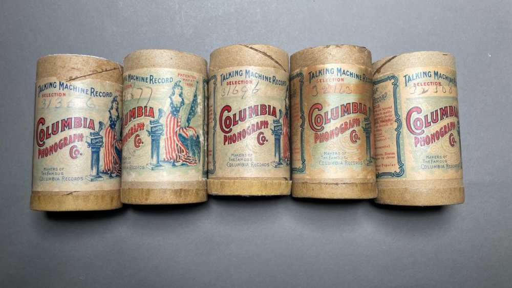

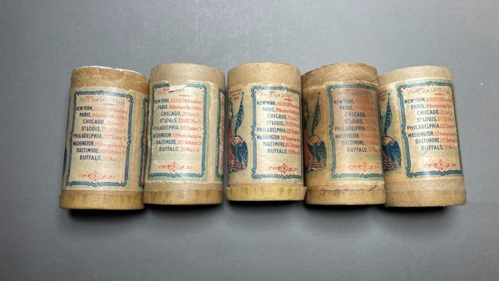

George did some great trailblazing about 4 years ago, publishing this series of Columbia boxes.  Back then, box aficionado Helmut weighed in, as did I.
One of the things I mentioned at the time was the quantity of Type 3 and Type 4 style boxes that show up.  Assuming the cities on the labels correlated with the record announcements, why would these be so much more common than the type 5 label that adds London to the list, concurrent with the "New York & London" announcement?
Tonight, I dug through all my Type 3 and Type 4 boxes and figured it out.  George - like all of us - assumed that the cities list grew along with the company, but that's not what happened.  All of the boxes shown below are Type 4 boxes with catalog numbers that are likely from the factory.  The catalog numbers on these boxes correspond to releases between March 1901 and the end of 1903.  These cylinders would have been announced 'Columbia Phonograph Company" or "Columbia Record."
So what is the proper sequence?  I believe that Type 4 and Type 5 should be swapped.  Since Type 6 was an outlier, likely used only for >160 rpm cylinders that are rarely found, basically the Type 7 box followed Type 4 around the time Columbia started to use black wax.
If others think I have this wrong, please chime in!
