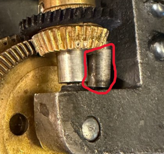

AaronDC Posted October 19 Author Posted October 19 Yikes! That's the retaining pin for the top of the governor. It fell down when I removed the governor. Anyway it was just sitting loose and wasn't doing anything. So, other possible causes?
Jerry Posted October 19 Posted October 19 (edited) Really difficult to tell from afar. The large bevel gear should have a flanged steel bushing in it. The flange needs to go between the gear and the cast iron motor frame. Installing it backwards can jam things up. Right now, I see an air gap in that area, suggesting that maybe the flange end is mislocated. Also, the brass spacer on the spindle shaft, between the small bevel gear and the motor frame, appears to be too short. The danger is that it will allow the spindle to raise and to bring the bevel gears out of mesh. Zing! ruined gears... I've done it. As to the bevel gears, it can be a tedious adjustment to set the height of the small bevel just right, so that it meshes well with the larger bevel. Enough clearance is needed so that the gears run smoothly, without binding, but not too much, which can allow the "zing" scenario, mentioned above. There has to be just a little bit of backlash between the two gears. Edited October 19 by Jerry
