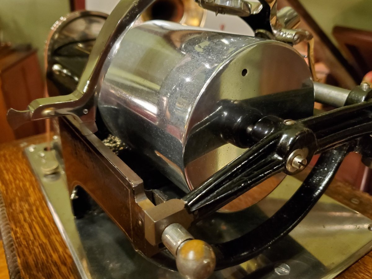

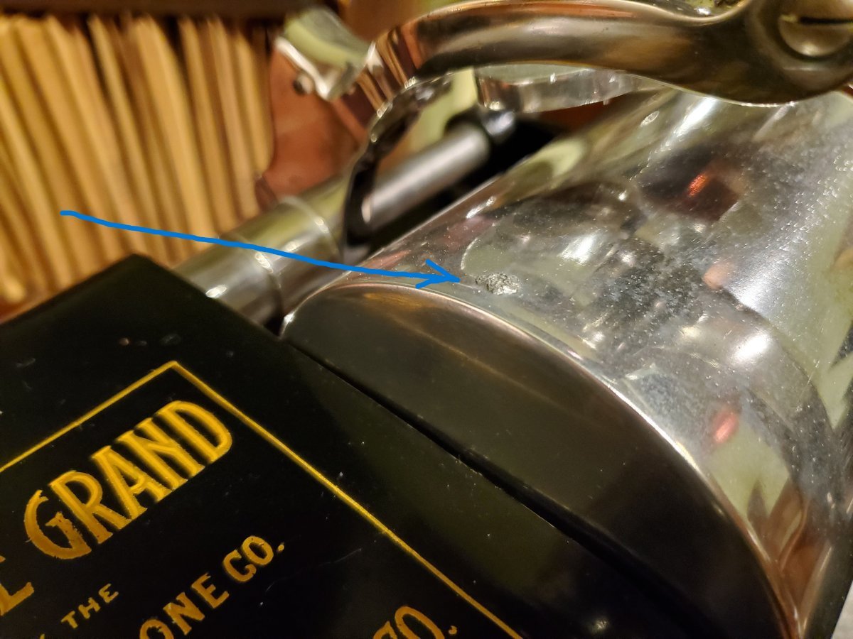

In your live stream yesterday you showed what you described as "indexing" holes in the mandrel, which would be necessary when recording multiple tracks on a cylinder record.  There is also a small hole on the side of the mandrel, the use of which is unknown.  Strangely (or maybe not), my Graphophone Grand (#344) has a similar hole the the side of the mandrel, as well as a hole on the mandrel's surface which appears to have been rather crudely filled with solder.  (It doesn't interfere with the records.)
I have always wondered why these holes are present, and have considered asking other GG owners if their examples have similar holes.  Perhaps it's time I did.
