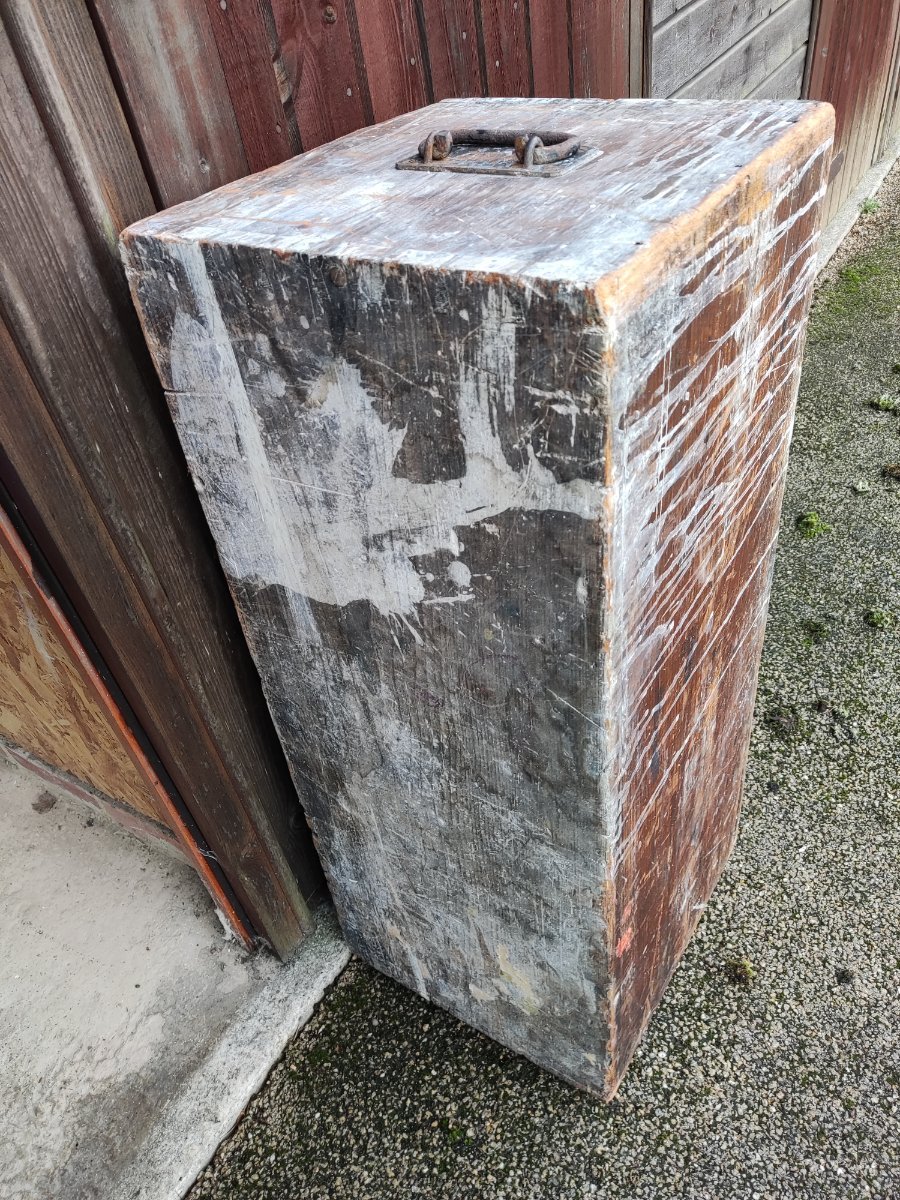

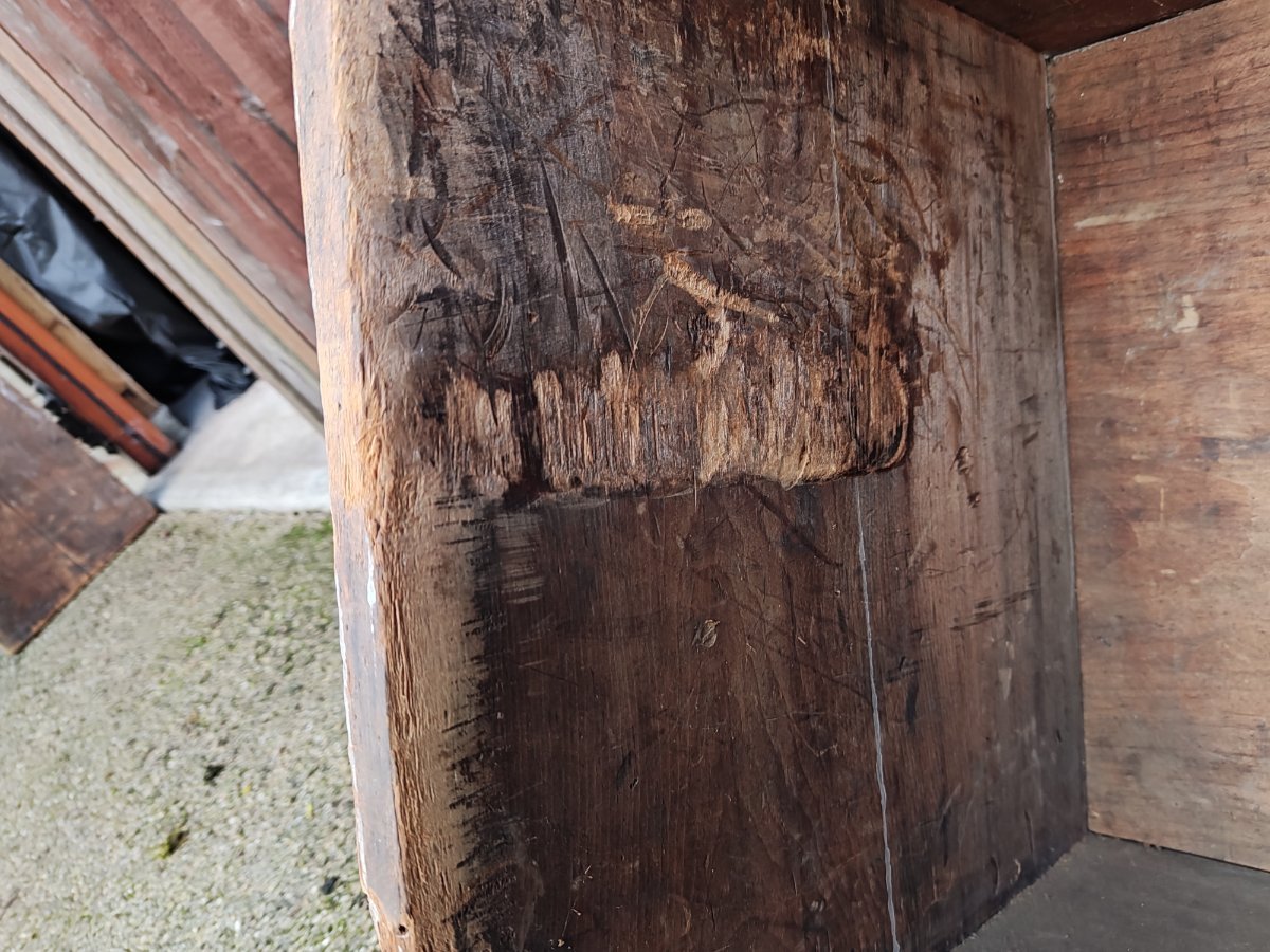

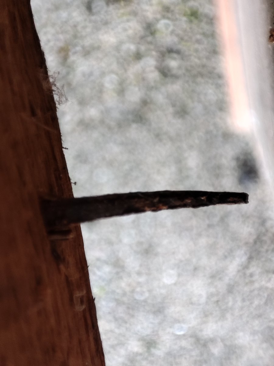

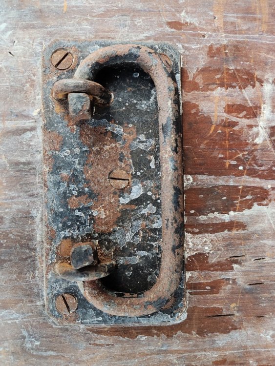

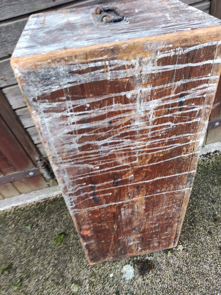

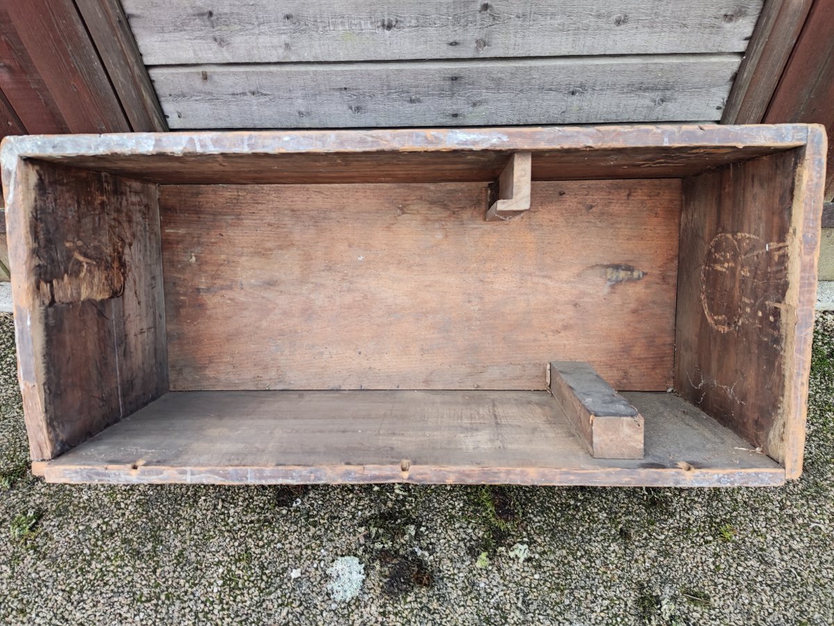

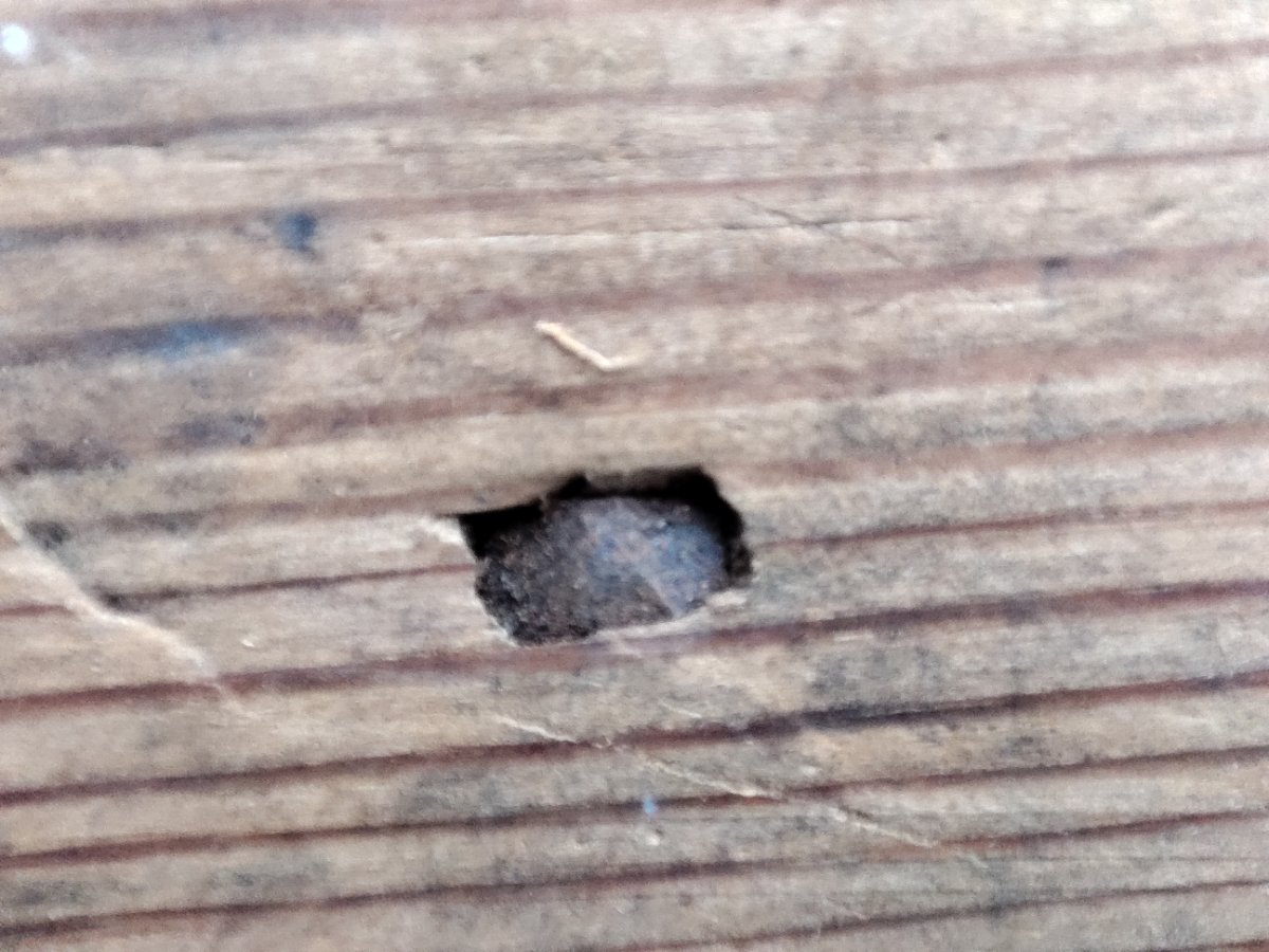

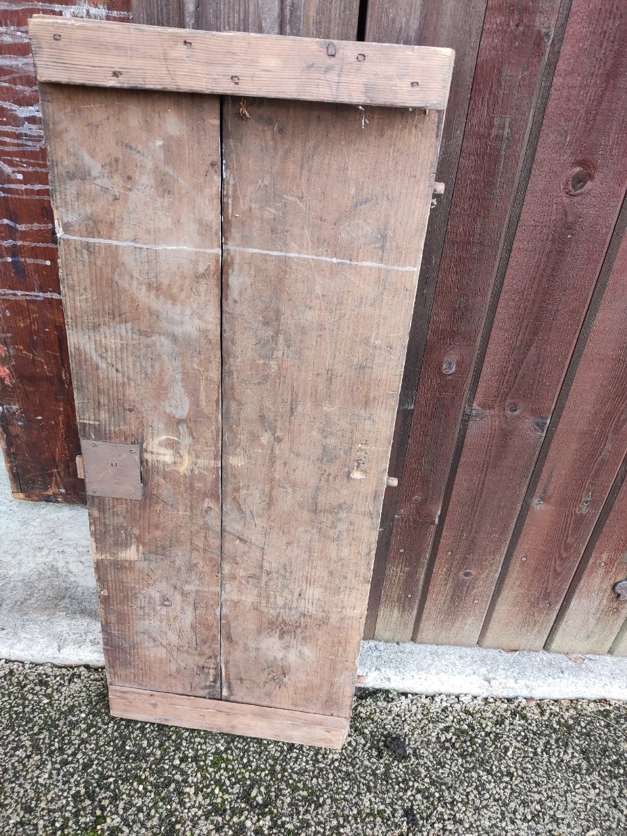

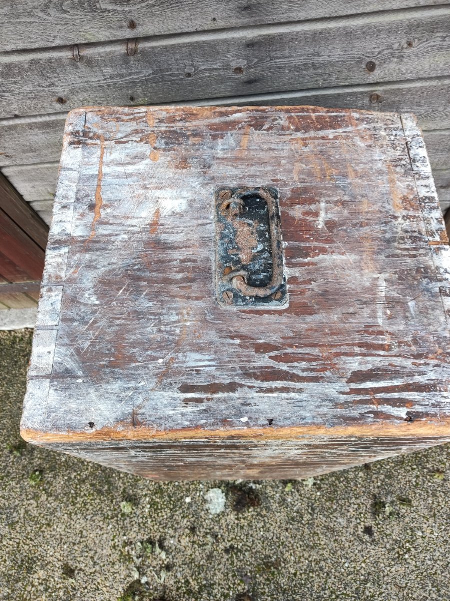

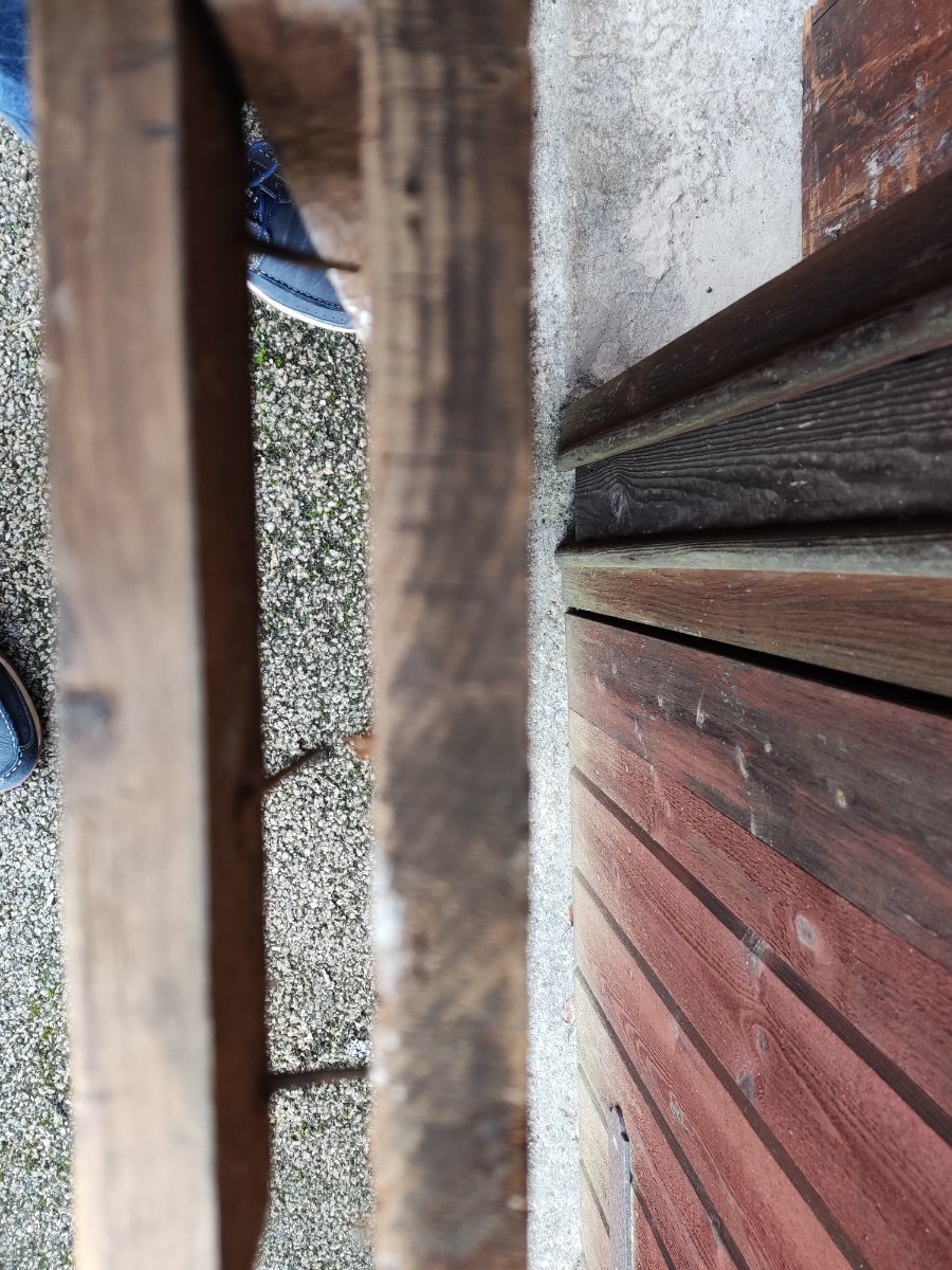

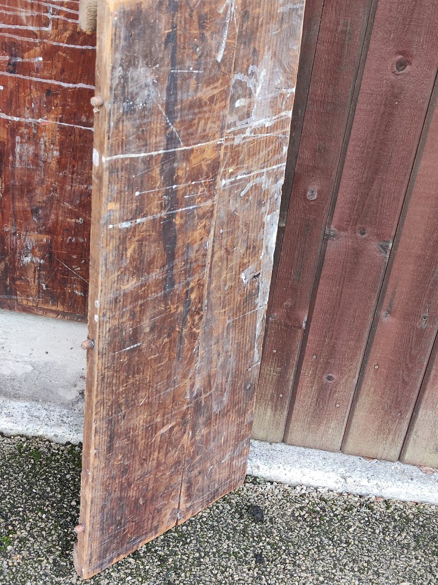

The final piece of the puzzle...and not a pretty sight.
This the case for the phonograph. I have absolutely no idea why it is covered in paint. All I can say it thank goodness the phonograph was inside not outside....From the interior markings you can see it's had a lot of movement over the years.
The front 'lid' is broken but that can be remedied. It just needs a couple of old nails to be sourced to move the plank back into position. Perhaps a little wood glue if it's not visible. The lock too - if it's salvageable - also needs some work and a new key.
The only thing is what to do about the condition. Of course the paint could be stripped, I think it's just white emulsion. However, this would destroy the 'history'. Also I love the fact that when people see it they will see the contrast. Didn't expect that inside!
Anyway, will be the last thing to deal with. Would much appreciate some thoughts on what to do anyone?
Thanks.

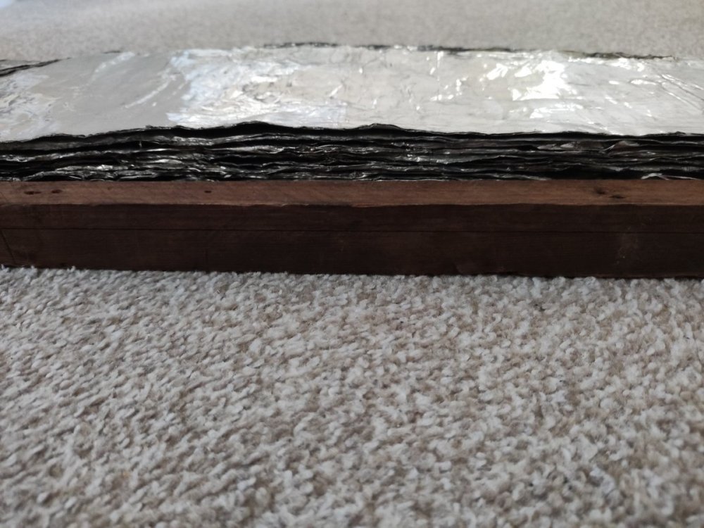

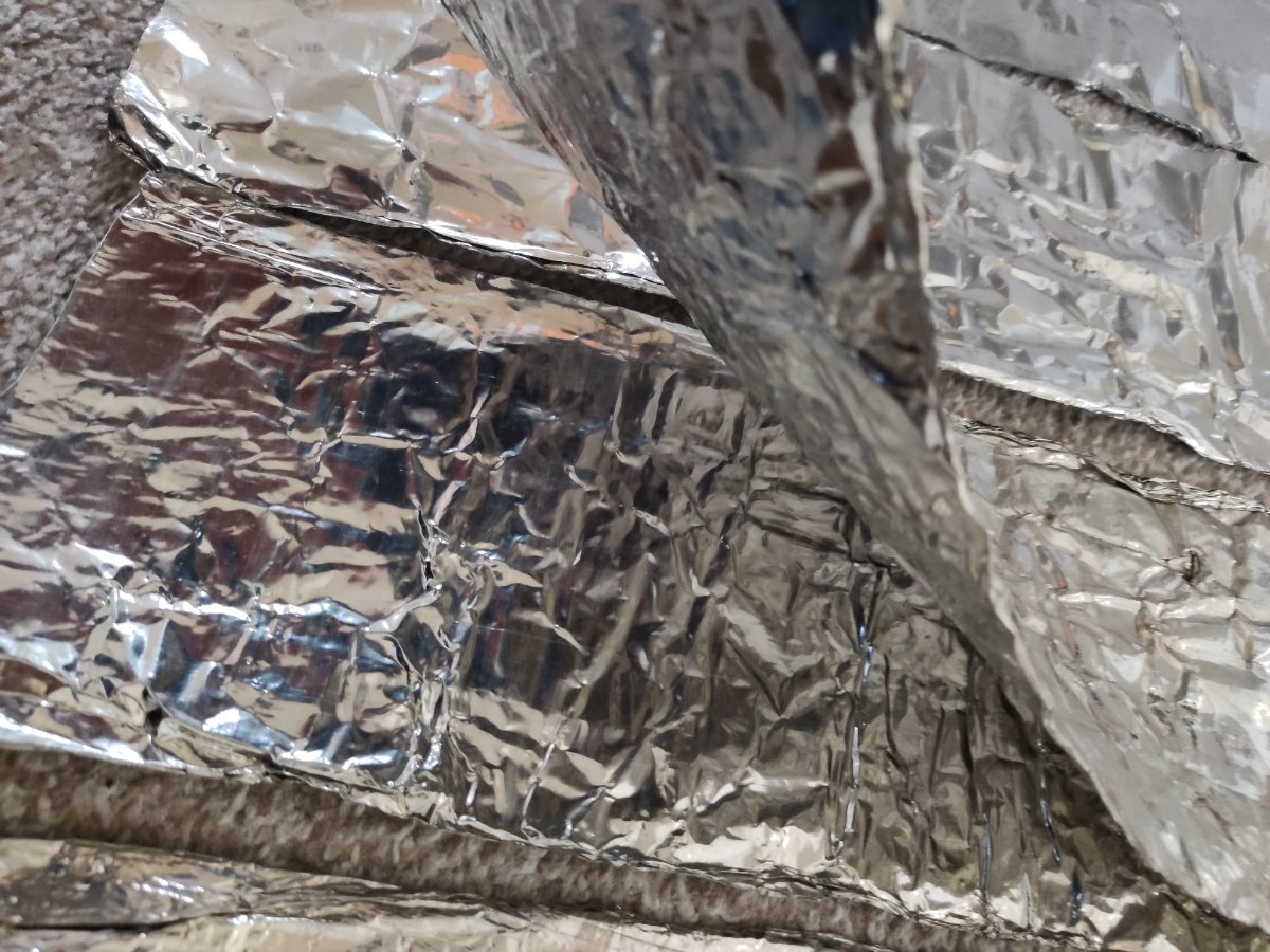

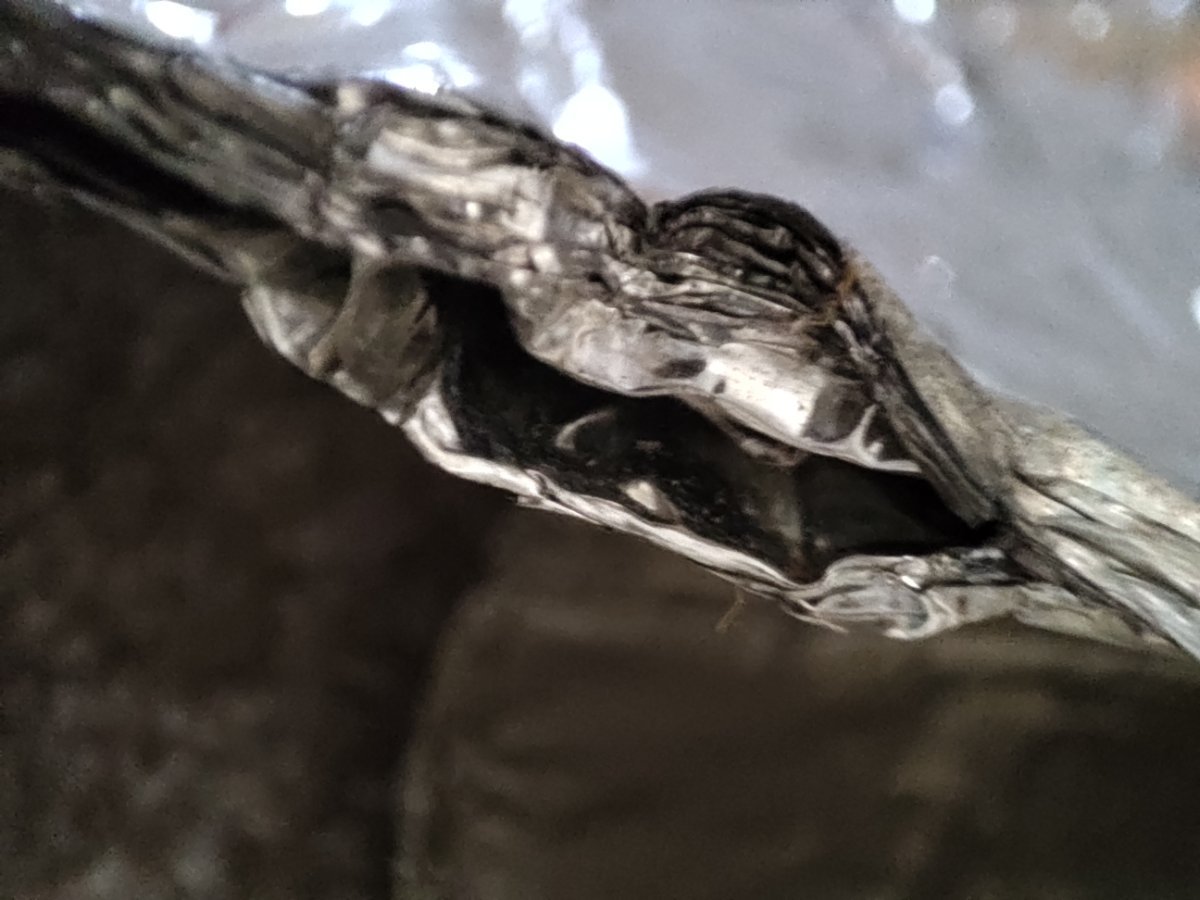

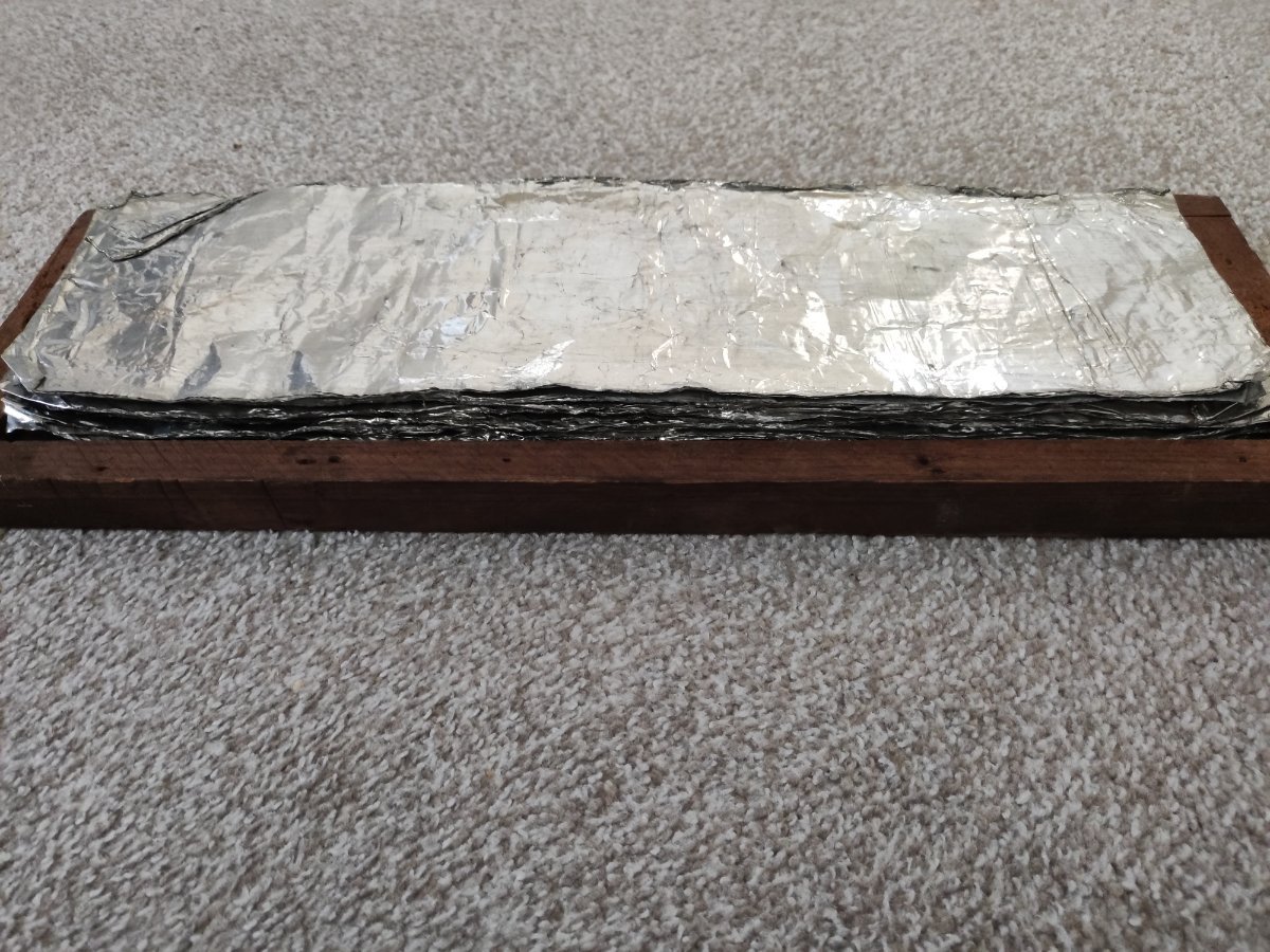

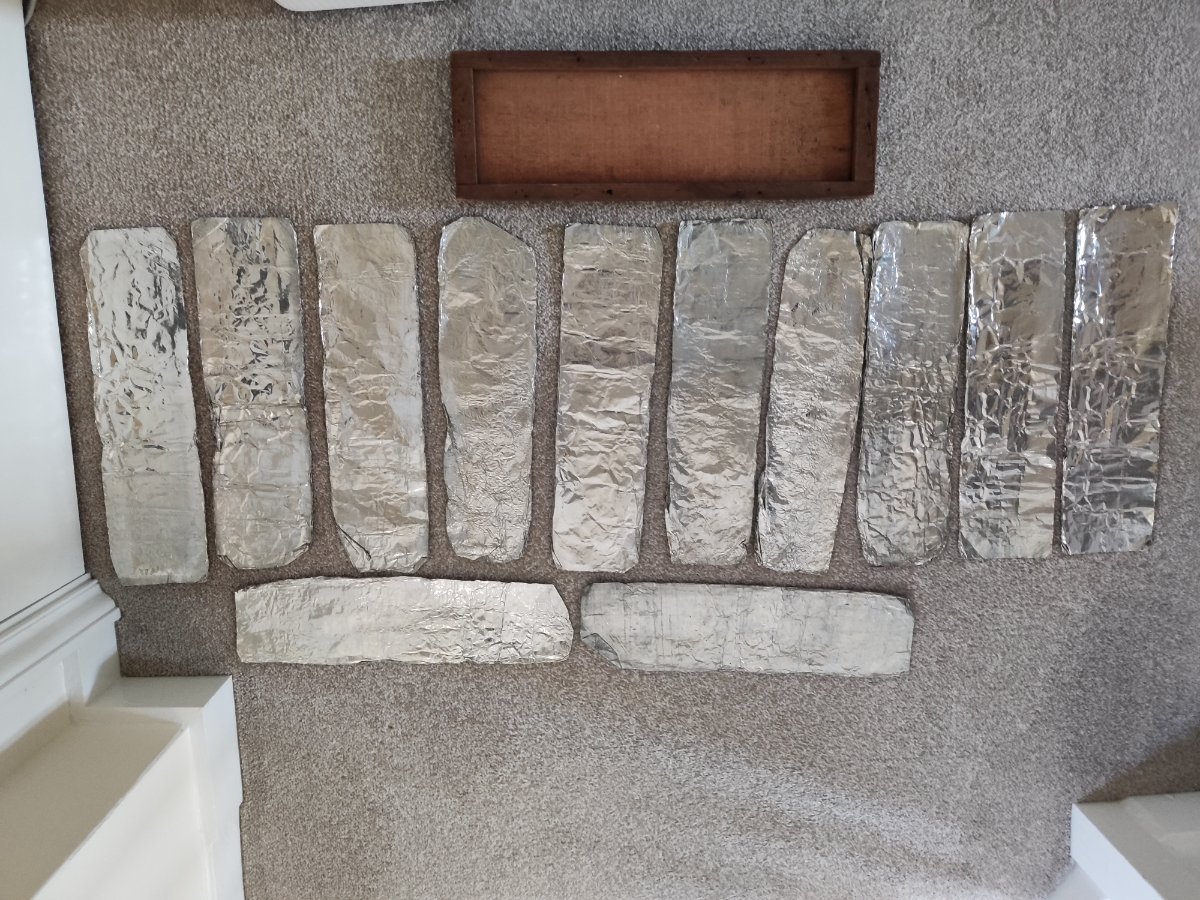

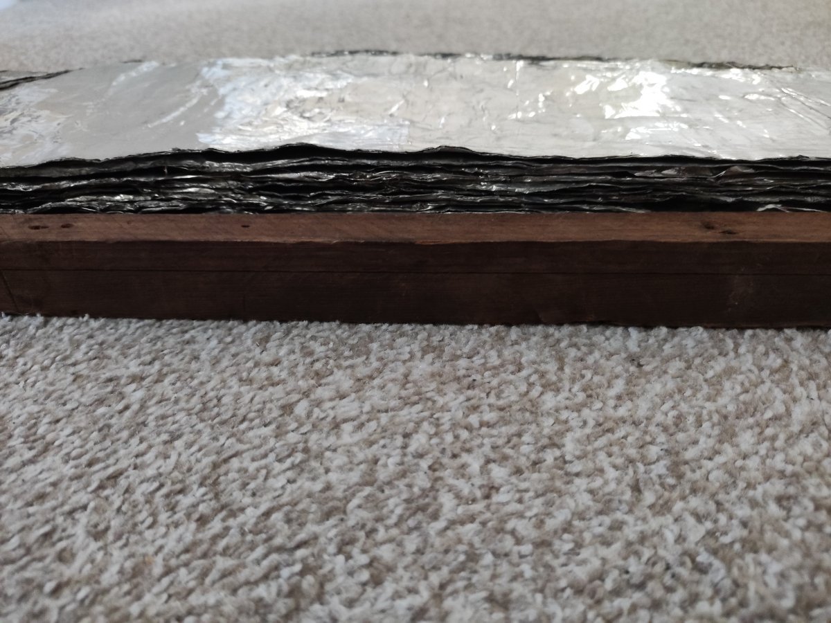

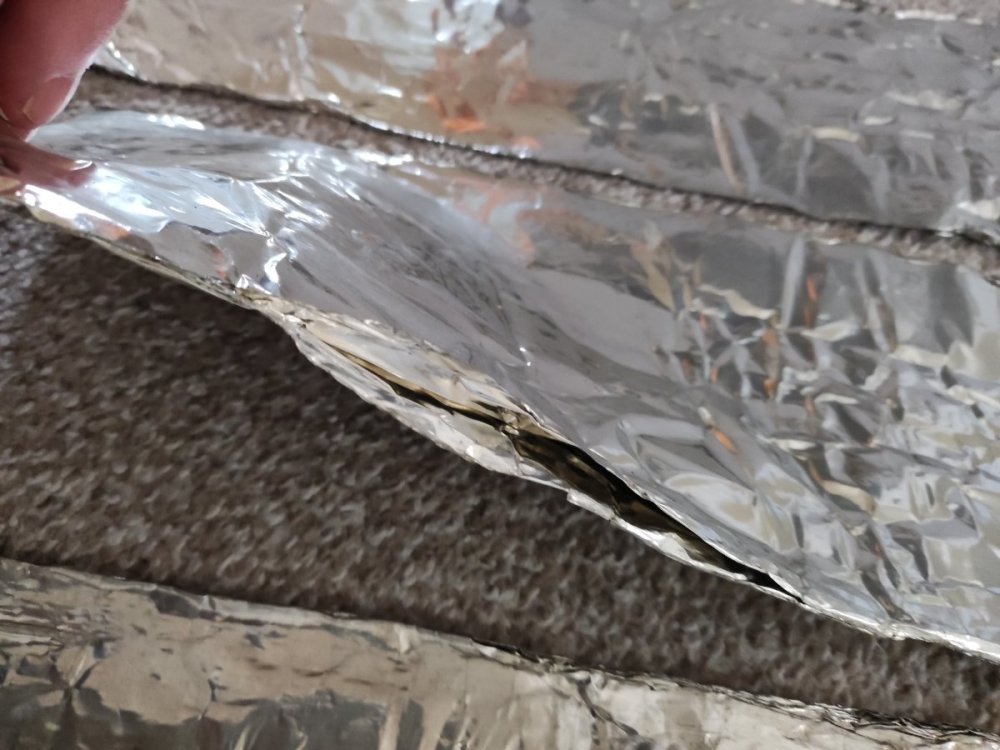

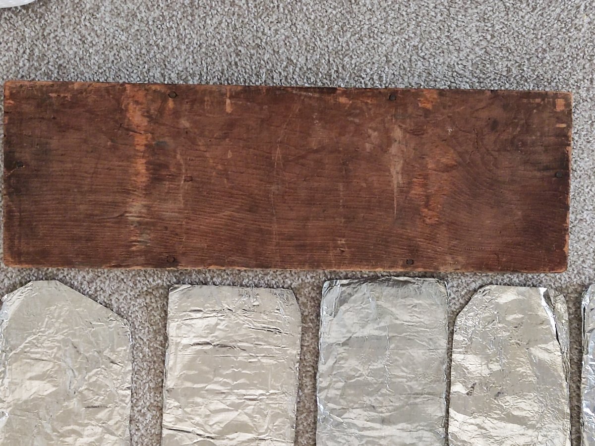

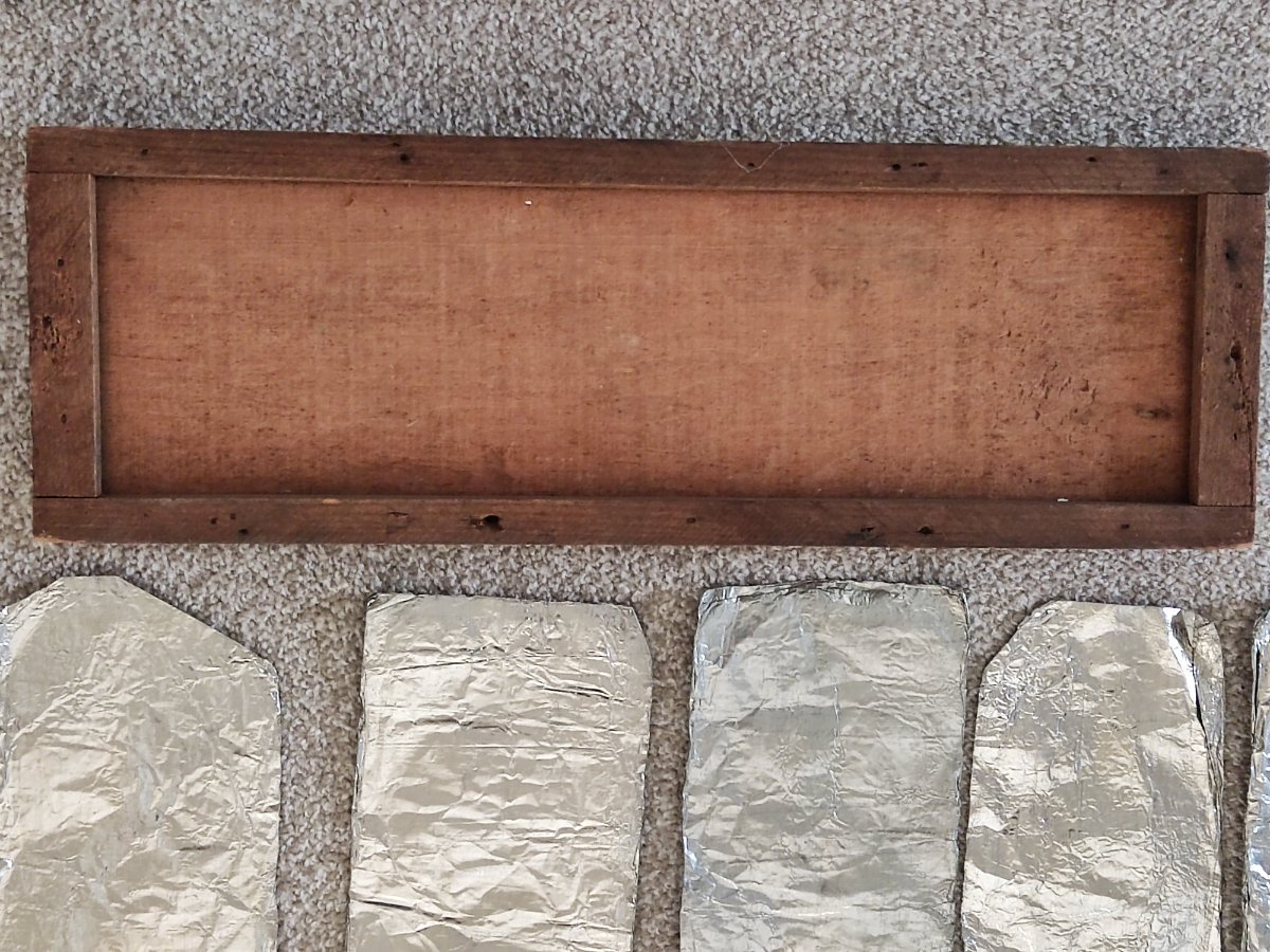

I posted photos of the tin foils at the start of this thread. I have now examined them in more detail and been chatting to René about them.
There are 12 'sets' in total. Each 'set' consists of multiple sheets of roughly 0.15mm foil. They are heavy, pliable and definitely not aluminum. Without a metallurgist I wouldn't know whether they contain lead or not, either in the sheet material or bonded between even thinner sheets. I've yet to count the individual sheets - perhaps 40 in total. They all protrude well beyond the top of the container/box. René thinks they would have been flat originally, probably fitting within the box.
Although they have end-to-end markings / striations on them, they are not recordings (unfortunately) unless one is hidden inside! They should fairly easy to separate - no adhesive or anything like that.
Edited by AtRicky1
