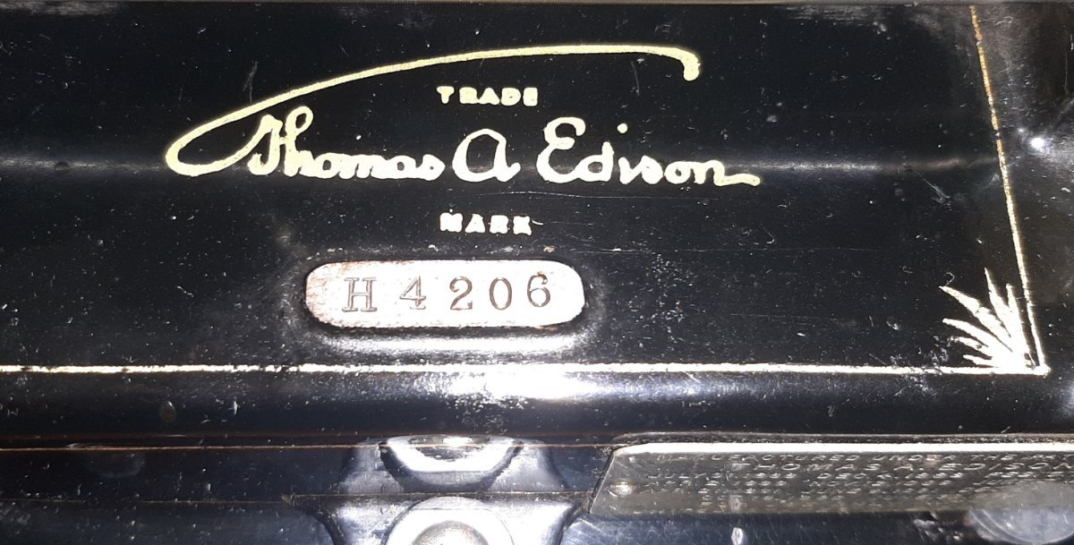

I have a couple of real early Model A Suitcase Homes. The serial Numbers are around H4200 so I would guess they were produced around mid 1897. Does this sound about right? Also, does anyone have any idea how many of this suitcase model were made?

Homes in the 4200 range left the factory in February 1898.
