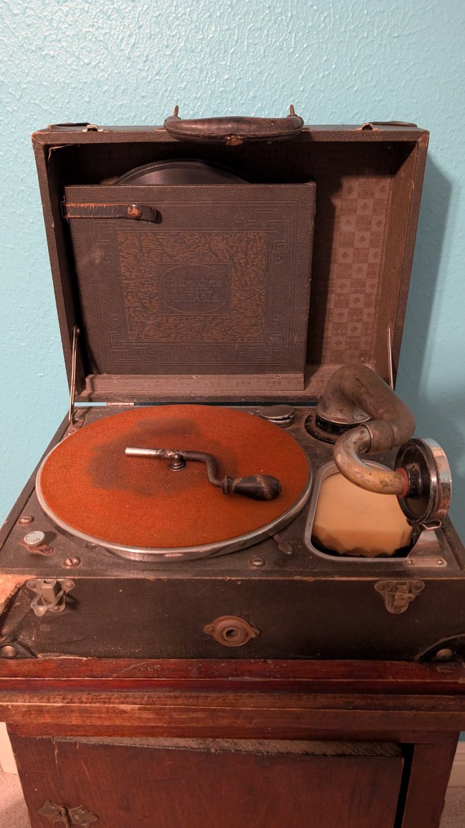

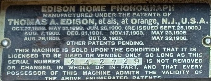

I have an Edison Home Phonograph serial number 242729 from c. 1906 - 1909 (see plate pic).  I also have a Silvertone Master Portable that my grandparents bought new, possibly in the 1920s.  I'm hoping someone can help me refine the dates of manufacture for these two players.   Thanks!
According to original Edison sales data, Home #242729 left the factory in January 1907.  An illustrated article describing all models of the Edison Home (A-F) and including a serial dating chart appeared in the June 2024 issue of the Antique Phonograph Society magazine.

For your Silvertone portable you will have to provide a picture. Because there are several variations of these machines out there.

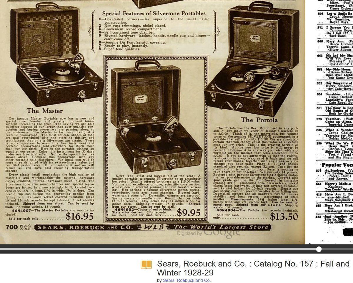

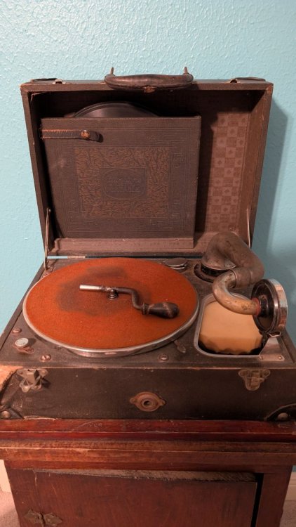

Thanks for the information.  I checked the archive you referenced and the closest match is from the 1928-1929 Sears catalog.  I've attached a photo of the player and the catalog page (the $9.95 model is the most similar).  That's a piece of foam rubber in the horn - I put it there decades ago since it improves the sound quality.

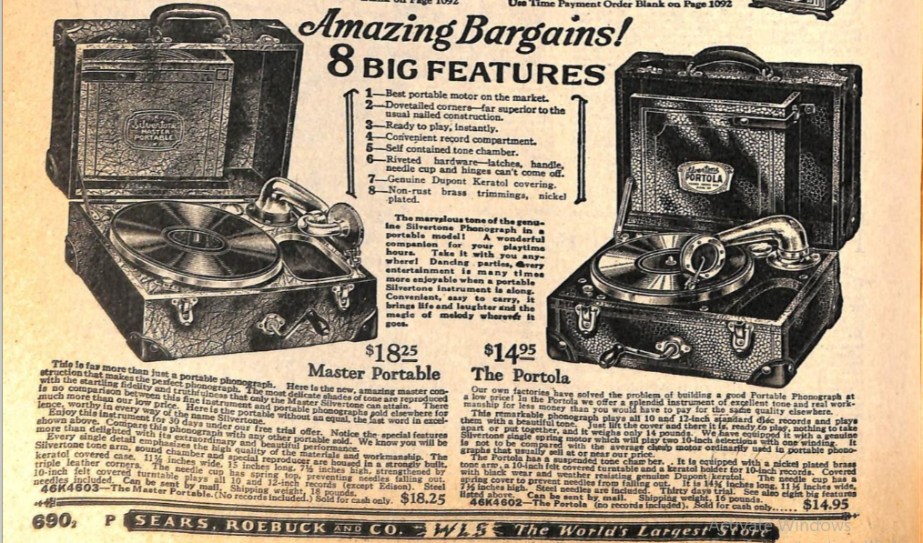

It's actually a 1927 model.
(https://archive.org/details/The1927EditionOfSEARSROEBUCKCatalogue1970ReprintAlanMirken/page/n409/mode/2up?q=master+portable&view=theater)
KevinMcCluney
Thank you very much!  Cosmetically it's in rough shape, but it still plays well.
