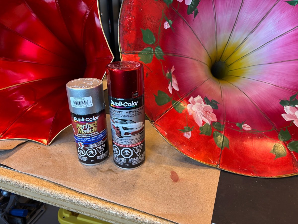

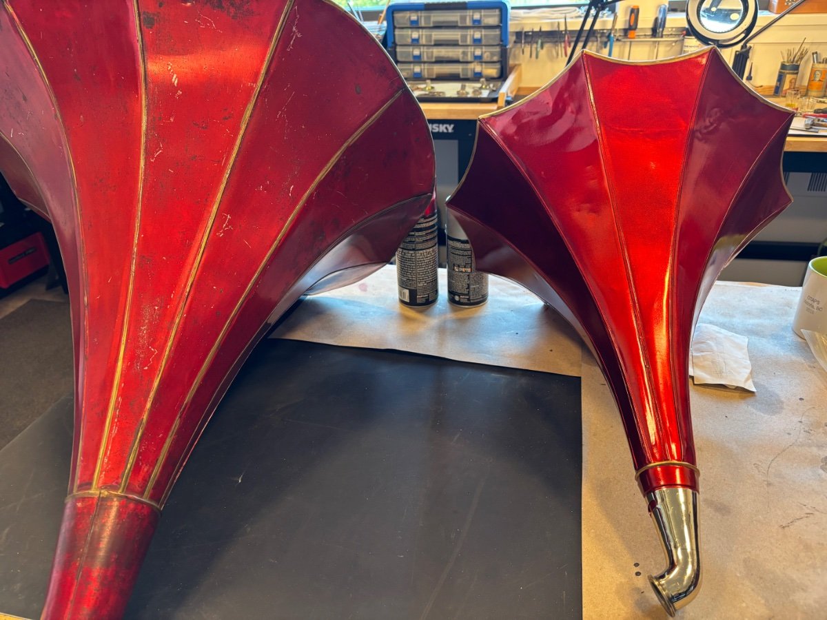

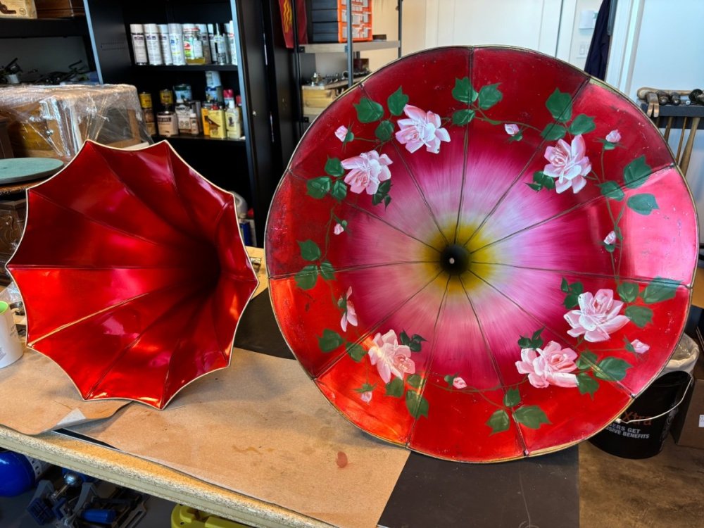

Thanks for the advice guys.  I stripped the horn down to the tin plating.  It needed some touch up due to scuffs and rust, which I cleaned up and then dusted with a silver spray paint.  Then finished with several thin coatings of Dupli-color Metalcast red anodized spray paint.  The very thin coatings allowed me to slowly build up the paint until it matched an existing red flowered horn I have in my collection.
I showed the completed paint job to an old time collector in our area who immediately recognized the finished product as matching what he remembered from original Berliner horns which he had owned in the past.
Unfortunately, after all that work the owner (specifically his wife) wanted a more subdued and opaque red so I repainted it before adding the gold stripes.  But a "happy wife" means the phonograph will be allowed to display in his living room so compromises must be made once and awhile.

Thanks guys.    Jerry I sprayed the areas that needed touching up and left it there as most of the rest was nice and shinny.
