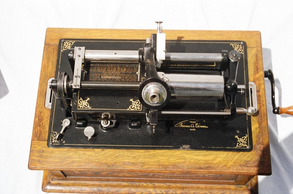

If you look closely at the top casting of my A model Triumph, you'll see two small holes drilled.  Would these have been to mount a repeater?  If so, any idea which one?

Looks like two holes for a "D Repeater".  The hole spacing should be 3" centerline to centerline.
I have a D repeater available (for sale), but the carriage arm is for a Home.

The motor is currently out for servicing so I cannot measure it but it does look like about three inches.  I'll ask the fellow that has it to measure.  I would like to add the appropriate repeater if that's what was there.
Those holes definitely look right for a Model D Repeater, and unless my eyes are failing me, it looks like an insert is on the top of the straight-edge (in the shadow of the carriage).  That would indicate a factory installation.
That Triumph has been converted to 2/4-minute, so you'll need the special geared pulley to drive the repeater.
