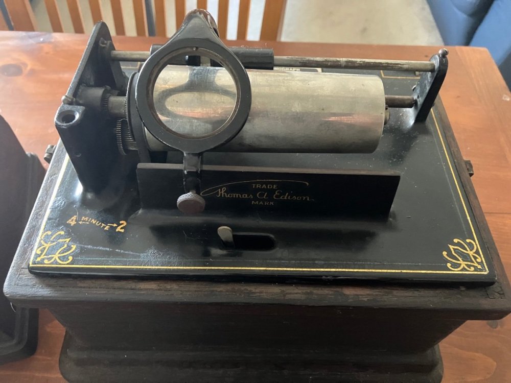

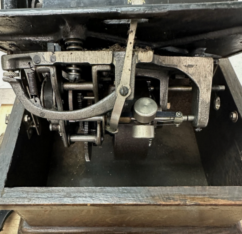

nippers_lounge Posted March 30, 2025 Posted March 30, 2025 I just bought a nice Edison Fireside for $199.00. Apart from needing a horn, reproducer and a crank. I need a knob to switch between 2&4 minutes. Also, I feel like something is missing from the motor.

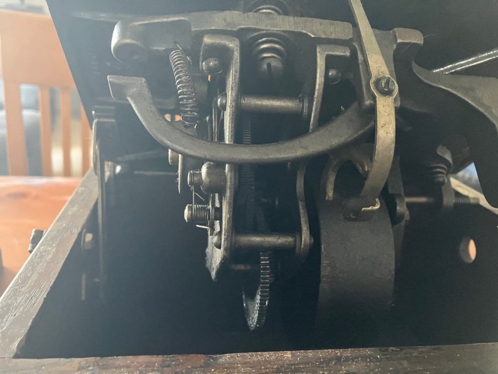

Andersun Posted March 30, 2025 Posted March 30, 2025 (edited) Your speed governor is missing.... Edited March 30, 2025 by Andersun Add pic 1
phonogfp Posted March 30, 2025 Posted March 30, 2025 In addition to missing the governor, you're missing the speed control. George P. 1
nippers_lounge Posted March 30, 2025 Author Posted March 30, 2025 I found a Governor on eBay, I just need to find a speed control. I also need to replace the spring for the speed control lever.
phonogfp Posted March 30, 2025 Posted March 30, 2025 The speed control may well be the same as used on the Standard. George P. 1
nippers_lounge Posted March 30, 2025 Author Posted March 30, 2025 (edited) That’s what I thought and I just found one on eBay. It’s also missing the screw for holding the reproducer. Which I found as well. It’s amazing how much was missing? Edited March 30, 2025 by nippers_lounge Added more info

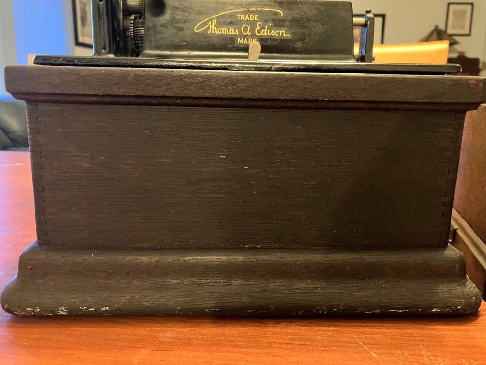

nippers_lounge Posted April 2, 2025 Author Posted April 2, 2025 (edited) Thank you George! Now, I just need to clean the case. I’ve tried Goop, Water and Vinegar, water and soap and mineral spirits aka paint thinner, but nothing works? I don’t know if it’s grime or shellac. Edited April 2, 2025 by nippers_lounge Spell check 1
phonogfp Posted April 2, 2025 Posted April 2, 2025 The case looks as though it's been painted. If so, you'll need stripper. George P. 1
nippers_lounge Posted April 3, 2025 Author Posted April 3, 2025 Okay, so the Governor and, speed control screw arrived today, and they fit perfectly. Also, received a locking screw for a reproducer, that I need as well. Plus I was able to get a reproduction gear cover. I am fortunate that the screws to hold the cover in place were still intact. I’m still waiting for the winding crank to arrive. I also, need to find a reproducer for the machine. And this machine will be back together. I will have to do some cleaning and oiling. I also, need to get a new spring for the speed control arm, as the current one is stretched out. After all is said and done. I am going to keep this one, as it is a very unique machine.
nippers_lounge Posted April 4, 2025 Author Posted April 4, 2025 Update! I have bought a Model K reproducer and found a spring for the speed control.
nippers_lounge Posted April 5, 2025 Author Posted April 5, 2025 (edited) I got the motor to run, albeit very slowly. I oiled the gears, as well as use some WD-40. I removed the Governor, and the gears started to move. I need a new belt as well. Edited April 5, 2025 by nippers_lounge Rewrite post
nippers_lounge Posted April 5, 2025 Author Posted April 5, 2025 Turns out the belt was the real culprit. Once, I slipped the belt tensioner off, the motor started to run faster. 1

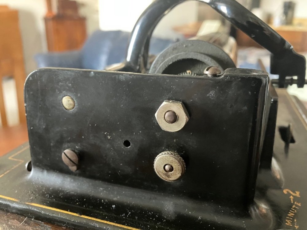

nippers_lounge Posted April 10, 2025 Author Posted April 10, 2025 (edited) New belt arrived, but couldn’t get it to stay on the Mandrel, which by the way I was able to move. I contacted George Valloma and he said it might be the pressure screw on the end of the mandrel. I was able to loosen it put some oil in and got it to work. 😀 Edited April 11, 2025 by nippers_lounge Changed reply 1
nippers_lounge Posted May 13, 2025 Author Posted May 13, 2025 (edited) Bought a new belt and was able to get the machine too run. However, I need a replacement screw for the brake lever. As the current one is loose. Edited May 13, 2025 by nippers_lounge Spelling
