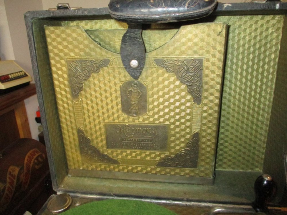

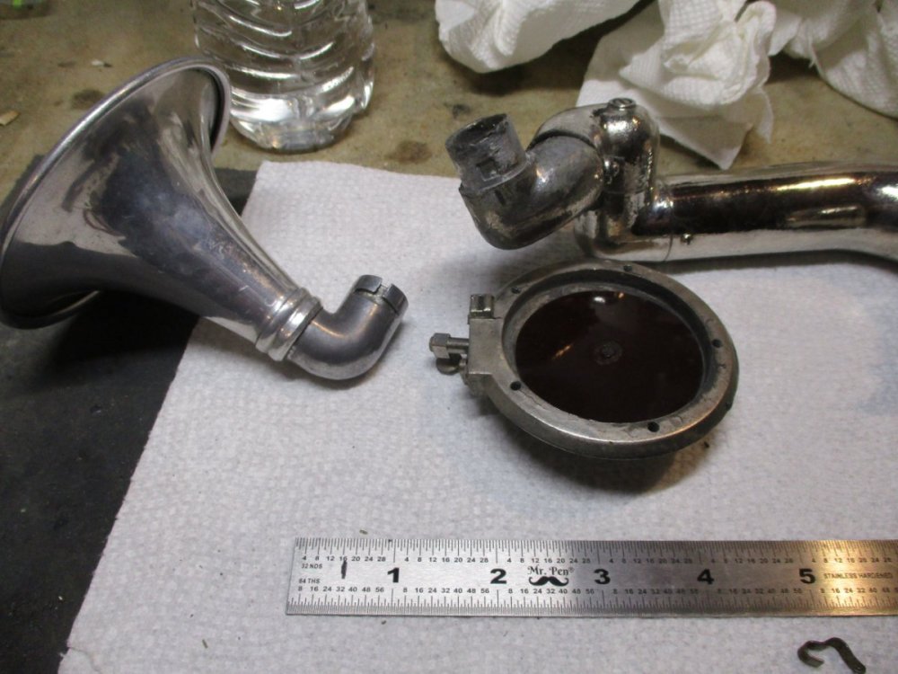

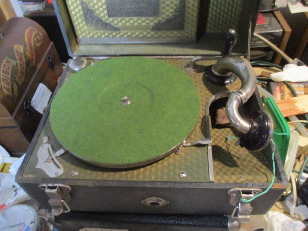

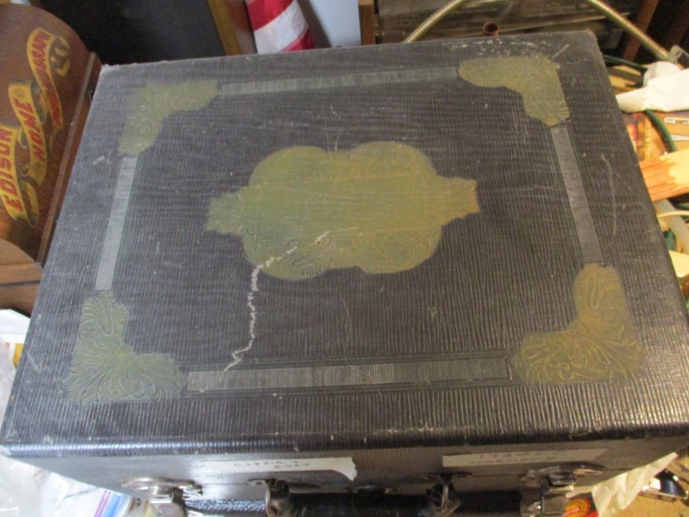

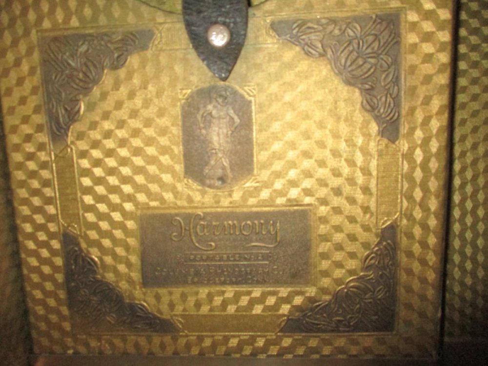

I am trying to find out information about a phonograph I am trying to restore and know the history about. It is a Columbia Harmony Portable 78 RPM disk player made about 1920, ( I am guessing at about that due to the image of a flapper on the inside of the cover) I have found several photos online but they aren't the same as the one I have, the tone arm is right front not right rear as mine is. I haven't located a serial number but I haven't removed the motor board and it may be under there. The machine plays with the current "standard" arm and reproducer on it, but it also came with a weird Arm which bears the casting of "harmony" on it. This arm has a small Aluminum horn attached to it's reproducer ( which would send sound out both sides, one to the horn and the other thru the arm and out the exit in the deck). I have done the best I can in describing it, and will try to post a few photos, any info anyone could supply would be greatly appriciated, thanks for read this, have a great day!

Update_ after the motor board and motor were removed there are no model numbers visible, only a "69" in pencil on the board.

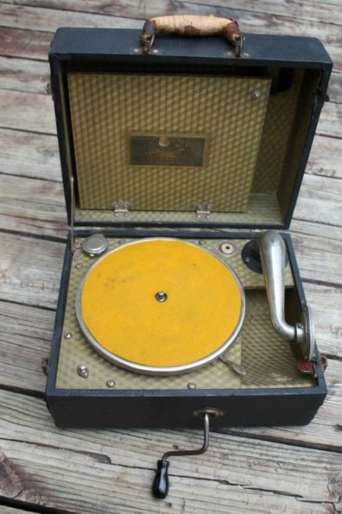

This is a Model No. 2 from the mid-to-late 1920s, around 1926-1927.
You may know that Harmony was Columbia's budget brand, offering a more affordable alternative to their main-line Columbia machines. Like most Harmony portables, this model was contracted out. Oro-Tone supplied the tonearms, while the Unique Reproduction Company provided the Add-A-Tone reproducers.
I’ve seen this same model replaced 2-3 times with tonearms and reproducers from the 1930s-1940s. (Because of this, you'll often see people dating them later than they really are.) As with many inexpensive portables of the mid-1920s, it relied heavily on pot metal. This was a low-cost portable phonograph, originally priced at around $25-$30.
Columbia almost completely redesigned the Model No. 2 for its next and final late 20s iteration.
