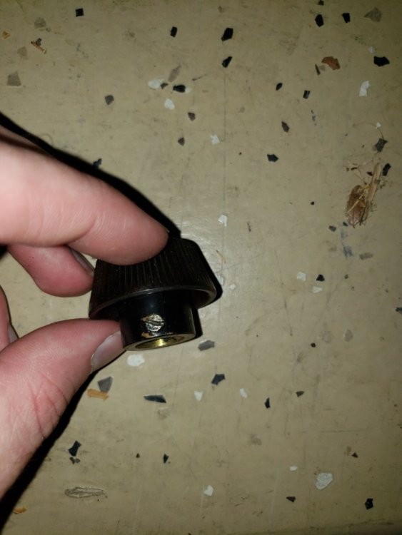

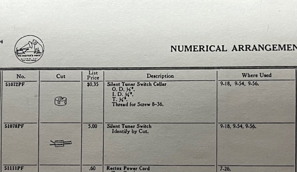

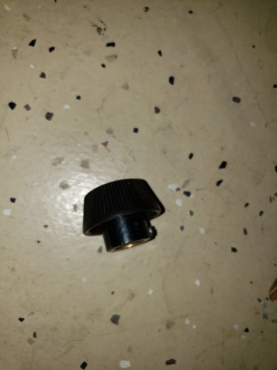

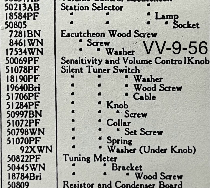

The Radiola 64 tuning knob as used by Victor in the 9-54, 9-56 and 9-18 is slightly different than the one used in the RCA Radiola 64 in that it contains a mechanism to silence the speaker while tuning. Pushing the special knob inward while turning enables this feature. In RCA’s version it was not implemented and they used a regular knob. The feature is not that useful so finding a regular knob for your 9-54 will pose no problems.
Good Luck with your restoration,
