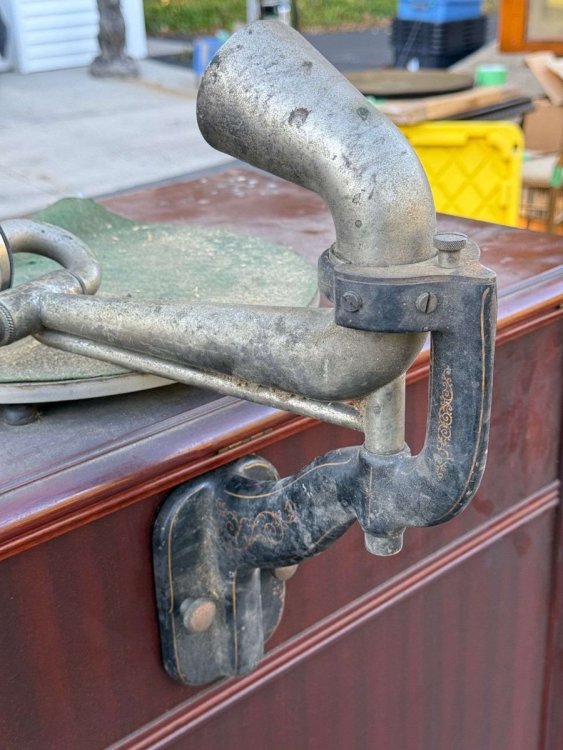

So far, the case is cleaning up very nicely.  The back bracket and tone arm as well.

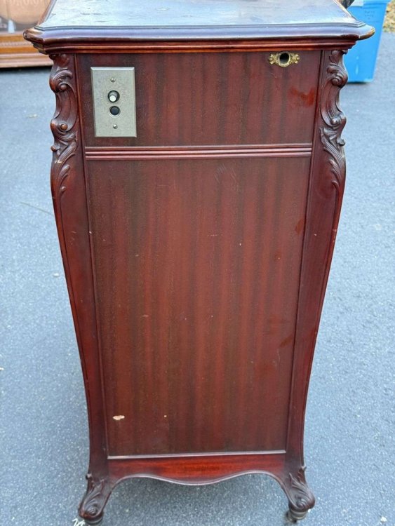

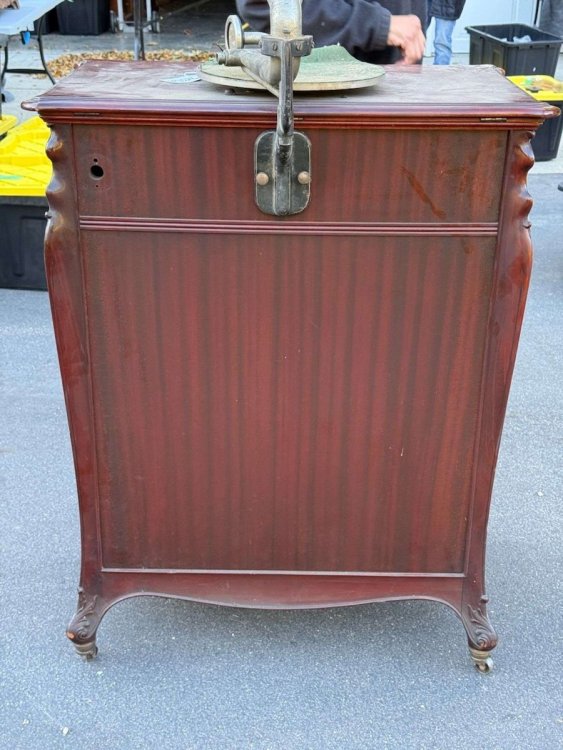

The cleaning is going pretty well so far. There is sun damage to the finish on the left side and door. The back and right side came out great with just cleaning. The back bracket, tone arm, and elbow cleaned up pretty well also. I will be working to bring back the sun faded left door and left side. The pump is sent out to be rebuilt. The motor also. I have been told that this is one of the four known Auxetophones that have the original motor and air pump. I will be doing what it takes to keep the original parts.  Here are some before and after pictures.
That's looking amazing!

Yes, Paul is rebuilding the pump.  I want to take every effort to keep the original components working.  Paul mentioned also about what the pump needs for maintenance.  Not a problem.  I am researching methods to treat the sun fade on the left side and left door.  I have received some good advice but would need to experiment before working on the Auxetophone finish issues.  No plans to strip and refinish.

May I ask what procedure you have been using to clean and "wake up" the original finish? It looks fantastic.
Flitz on the nickel plating, WD40 on the back bracket, and GOJO(no pumice) on the cabinet.  I am still looking into what I can do to treat the sun faded area on the left side and left door.
WD40 is perfect for rejuvenating weathered painted surfaces...
