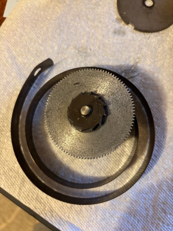

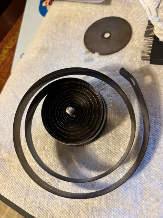

Below are photos of the spring barrel and winding gear.  Do they look backwards to you?   I watched a couple of Brett Hurts YouTube videos and they looked the same to me.  I held off completely reinstalling the spring in case is was indeed backwards, but it is wound in the same direction as the ones in Brett's videos, or appears that way to me-this is the first spring I've actually uninstalled/reinstalled.  I've spent a lot more time on wood and finishes.

The spring and the ratchet look correct.
Aside from possibly running the belt in a crossed, figure-8, fashion, I can think of no other way to make it run backwards.

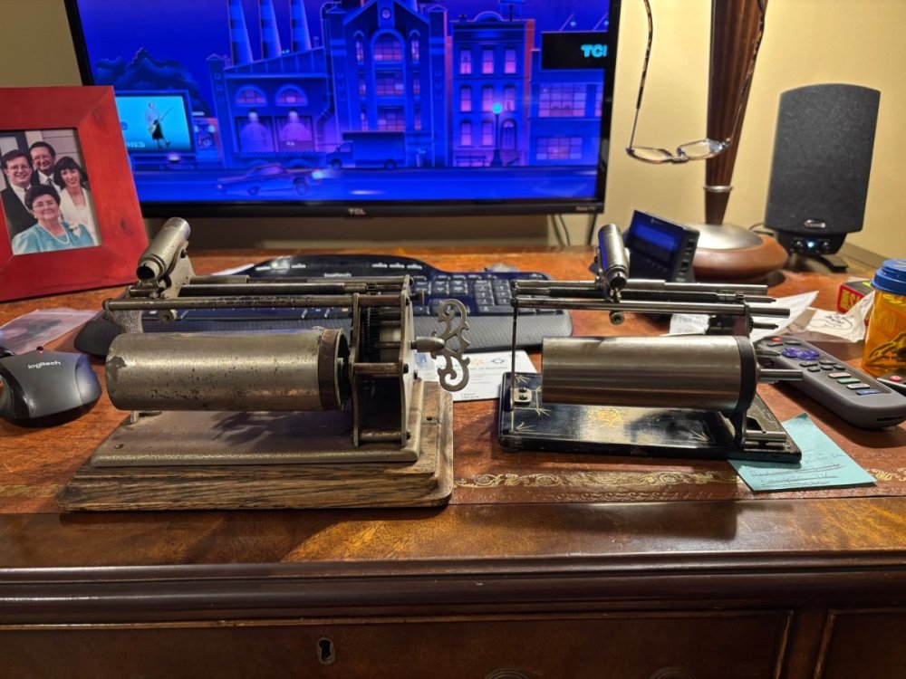

I agree with Jerry... I can't think of any way to make it run backwards...  That  being said, it should run in the direction of the photo below:
(The cylinder plays from Left to right - 2 minute cylinders only - no 4 min Blue Amberols)

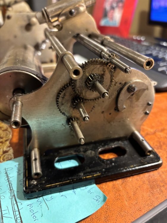

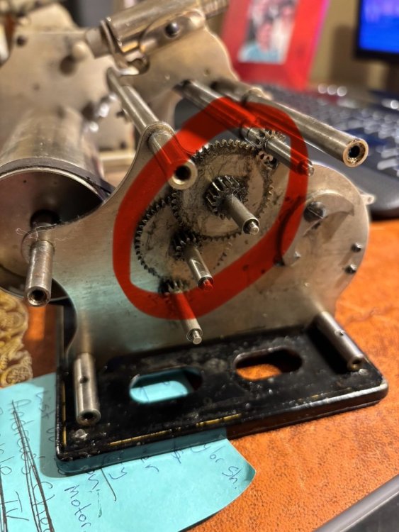

So, last post this evening.  These two gears were installed in the opposite positions from what you see now (upper in lower and vice versa) and that caused the machine to run backwards.  I just needed a working one to show me the error.  I put them back the way they should be and tomorrow when I reinstall the spring, I’m betting it will run correctly.  Glad to know (or at least suspect) I haven’t lost my mind.  Whoever worked on this motor prior to me had swapped these two particular's gears, causing the issue.

Wow!  Studying the gear train closely, I believe I can see how that could happen, but it's nothing you would expect could be the case. I can't imagine the leadscrew gears could have meshed, and I'm surprised that the drive gear for the pulley did.

With the spring re-installed and the gears swapped, the machine runs exactly as it should.  Whoever worked on it before simply swapped these two gears.  It was unfortunate, but an easy fix once you figure it out.  Hopefully this thread will be available if anyone has this problem in the future.
